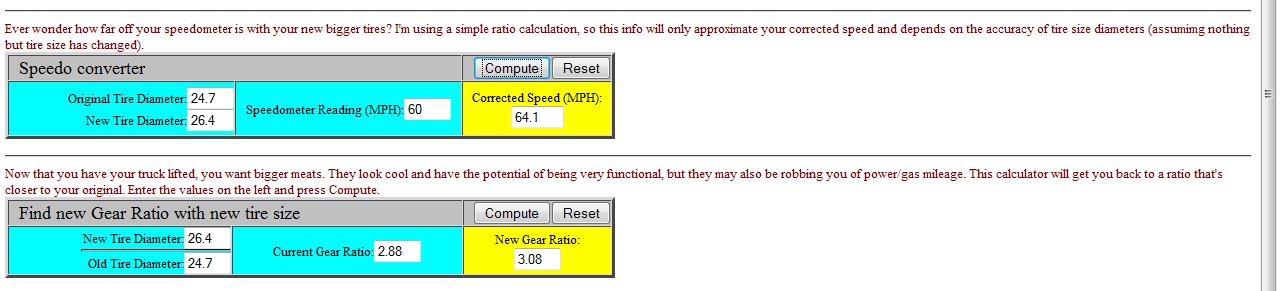

(09-16-2010, 11:29 PM)Captain America I think it's the year. Mine is the same as yours... Wish I had the 120 speedo (with the right calibration for my tires).
I would try to see if the speedometer off your '85 parts car would be close accurate with the tires you have. The '85 speedometers are calibrated for a 2.88 ratio differential.

Your the fuckin man! I never even thought of that... looks like it will work perfect. I think I applied this right, just had to put the numbers in backwards...
