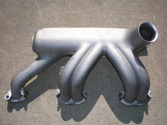

09-28-2010, 10:49 AM #5
ya i saw that and i didn't seem like it. well fuck it. the manifold is already 80% of the way unbolted.
i haven't even gotten to the allens yet. just making sure that when i unbolt it, i can get it out. and that allen bolt design is bullshit, but whatever lol.
exhaust is getting prepped for the egt i have. if i had the time to find a w115 mani i would. speaking of. how do you do the egr delete on the exhaust side w/o another manifold?

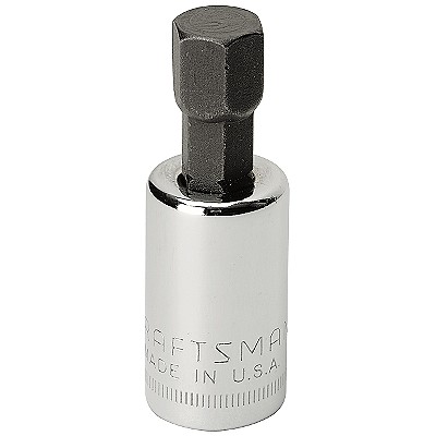

09-28-2010, 11:13 AM #6
Haha, I like your style!
The allens are f*ckin Bull! Best to get a Allen socket chingus for a 3/8 drive ratchet and the stick a box end wrench over the allen. Its a 10mm so you don't have to waste your time wondering....

09-28-2010, 11:23 AM #7
i have a full set of 3/8" allen sockets and swivels to do it. i just don't wanna yet, lol. at least not until i can see the bastard.

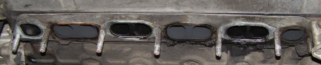

09-28-2010, 06:21 PM #19
(09-28-2010, 05:17 PM)Captain America Yeah there are six on the head that hold the manifolds on!
Seven.

09-29-2010, 04:54 AM #22
You're probably skipping the first one by the thermostat base on the exhaust manifold.

09-29-2010, 09:51 AM #23
Forced is right, that one is a dirty little bitch, It's tucked in there good. I mean if you grab the crow bar they will all come off automatically....
