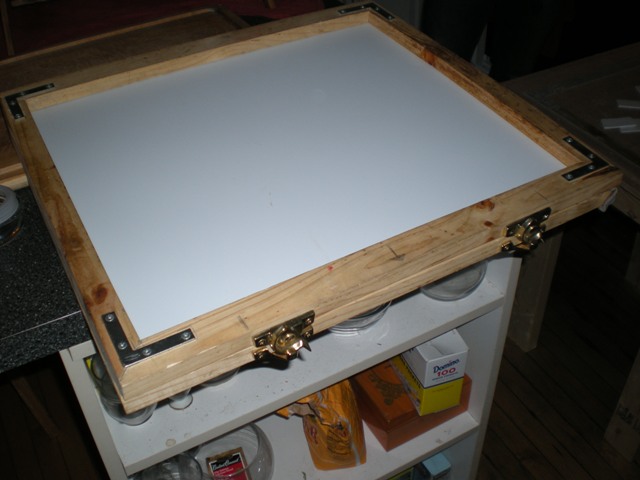

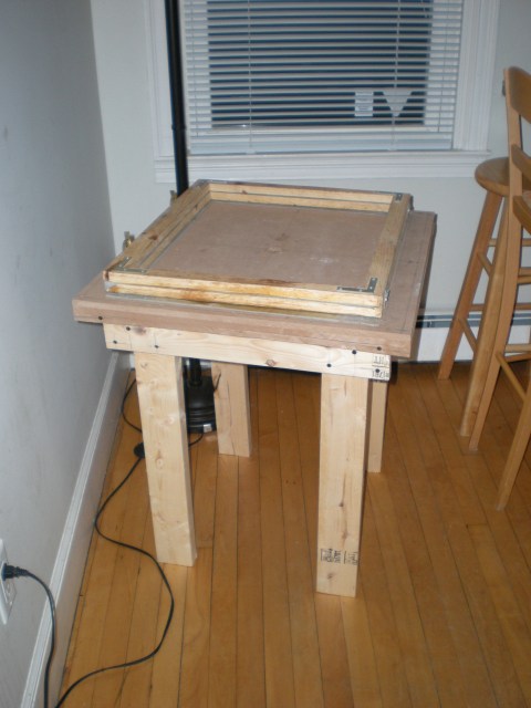

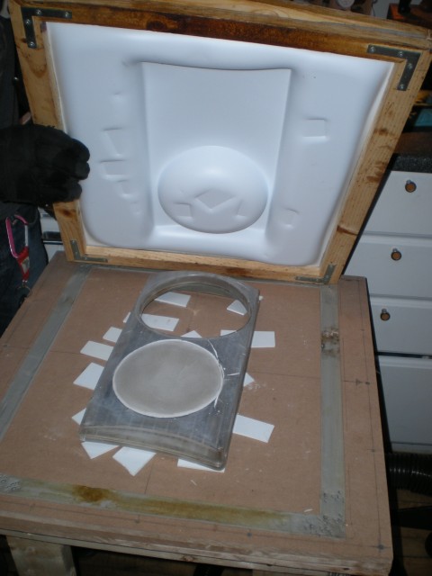

Ok, rigged up a basic vacuum form machine, and made a couple of test pieces-
here are a number of pictures of the process-

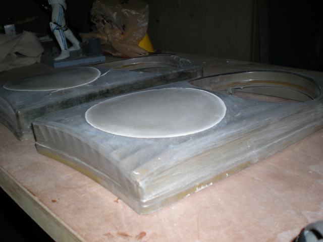

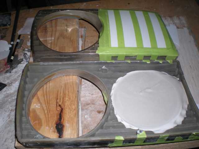

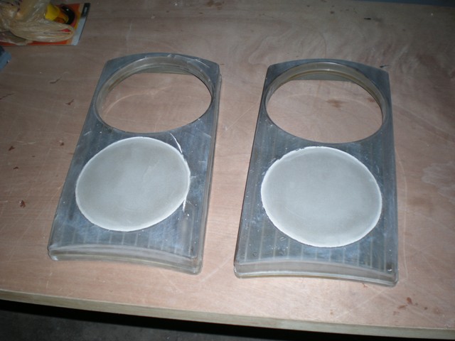

I modified a couple of old busted door pieces into molds for this experiment. I poured gypsum casting cement into where the fog would be located-
heres a few pics of the former headlight doors, now molds after sanding and shaping-

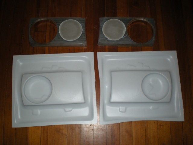

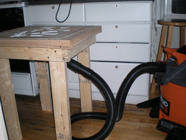

A couple pics of the vacuum form machine-
Forming process-
more pics-

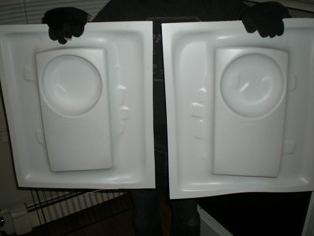

results after forming, the molds will need work if I want to do this again, the stock MB plastic will certainly break with the heat, I would probably cast a negative in alginate and recast a complete piece out of casting cement.
There was some bleed through of the shape of the plug, not enough sanding on the mold. Later versions will be better quality-

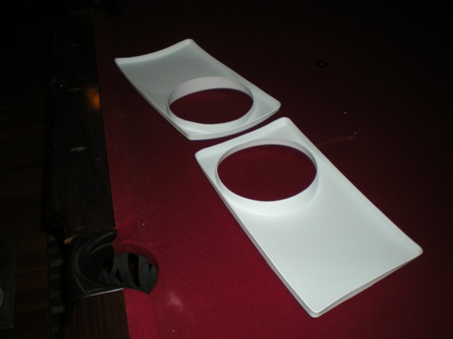

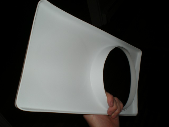

Couple of comparison shots-
right off of the mold, and after cutting, sanding, and shaping. Final form slips right over the existing headlight doors. Plus, with the flat backing over the fog lamp, I can pretty much put any shape I want if I want to add louvers or a grill maybe. Im out of town at the moment, but when Im back, Ill take a few pics of how they might look on a car.
Forming process-
more pics-

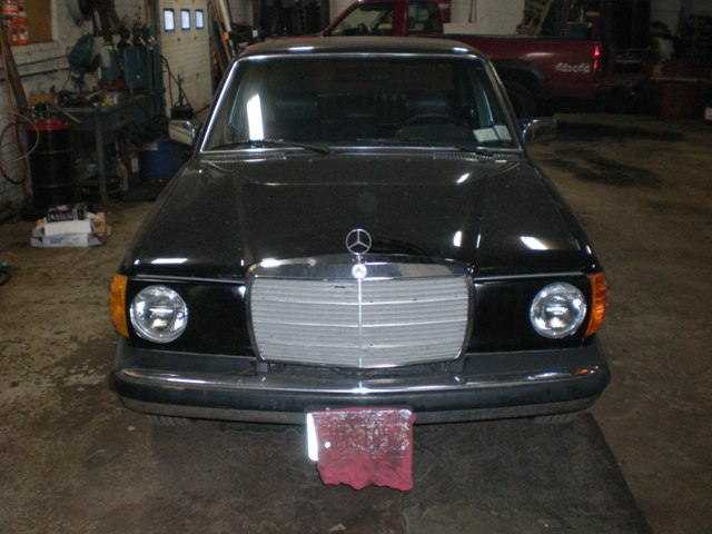

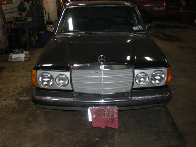

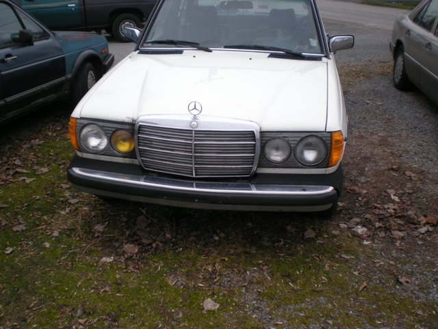

Here are some comparison pics, for me, the jury is still out on how this looks.
Got kind of a bug eyed loopy look to it with the bright white. They will need a little trimming on the outside next to the turn signal, and the look would really change based on how you handle finish and the flat spaces. I just sort of pushed the edges on in this picture, so they stick out a little bit. Fully fitted would be more integrated with the hood
Definitely completely changes the look of the car, for better or for worse. If there were some features on the flat space, it might look awesome.
The guy at the shop I was at was saying it would really change if you had something going on, like an intake grill, and on the opposite side you could glue the words turbo diesel on to it. We both kind of agreed that something needs to go there, maybe not fog lights, but something to tie the headlights and grill together. Might make an interesting look. Opinions?

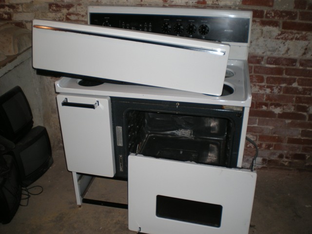

You would either have to buy a real machine, use one somewhere, or cut up a bunch of ovens to heat a frame long enough for, lets say body kit parts. Other than that, the skys the limit on what you can make as long as it has a release angle.

definitely, the problem with the "at home" version of these machines is that you are limited in size to what can fit in a home oven. Whats been going through my mind repeatedly is "pillar pods you dont have to modify"

That vacuum form table was crappily made at a friends house, my oven is actually a little older and bigger, I am now making mark 2 vacuum form table with some better construction.

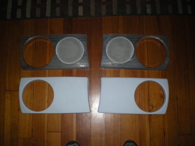

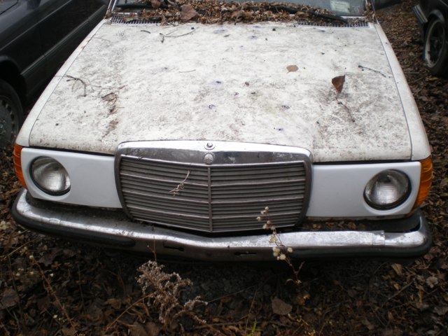

Here are a second set of comparison pics, this time I found a non horrific car to put them on, and painted them. The guy already has kind of a nice look going on, he had the original panels painted a nice grey. Still need to trim them a bit on the bottom, and I was unable to close the hood fully because of engine work taking place, but you get a better idea. If I were to do this, I would remount a set of stand alone fogs either below on on top of the bumper in the same general area. The other option would be to split the space, and put into the mold a provision for smaller newer fog lights in the flat space, with an air intake above-
