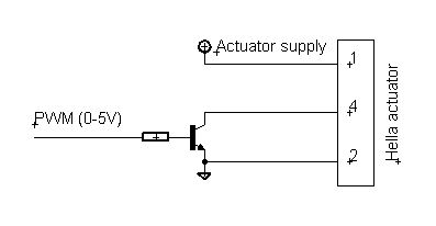

(01-16-2011, 10:42 PM)Biohazard I'm sending 9v to pin1, Ground to pin2 and PWM signal to Pin4 on the Actuator; Pin1 being the round side. I'm using 7.1ms with various duty cycles, but it isn't responding to any of it. I believe the Prop chip is sending the PWM at 3.3v, is that too low? Should it be 5v?
Should be 9V in your case. I think you have to increase PWM voltage to power supply level.

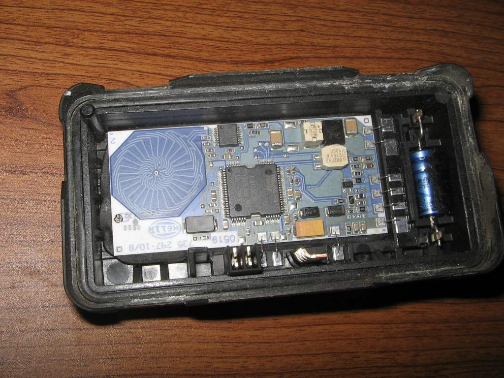

04-15-2011, 02:41 PM #116
What's this one?

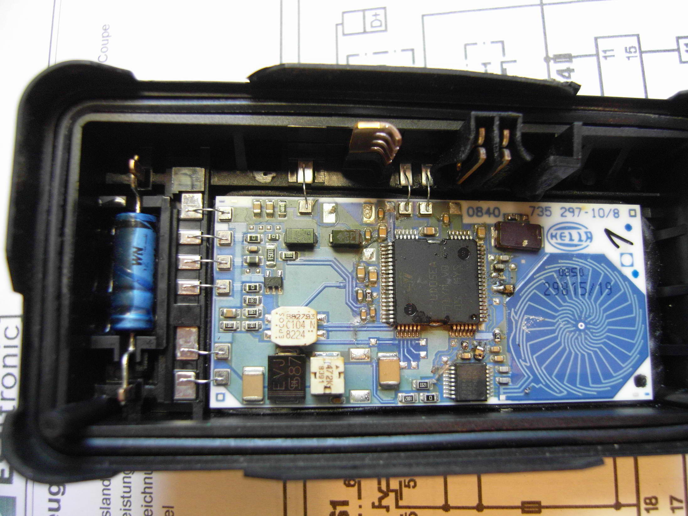

04-16-2011, 02:44 AM #117
(04-15-2011, 08:03 AM)tomnik Hi,
open it and post a pic of the electronics inside and I can tell you if CAN or PWM.
Tom
i have two actuators on the bench. There are some differences (some resistors).
Garrett_1: is now faulty, but i think, this one has sent CAN signal (before)
Garrett_2: don't send CAN signal and don't work with PWM
Which one should work with PWM?

tomnik
587
04-17-2011, 11:25 PM #118
both seem to be PWM.
Indication is the capacitor on the left side.
The CAN type doesn't have this.
Tom

04-18-2011, 01:30 AM #119
Do you mean this capacitor?
And one question about PWM. I'm trying with rectangle singnal, 140Hz. This is actually PWM 50%. The actuator should move in the middle position. Or is this wrong idea?

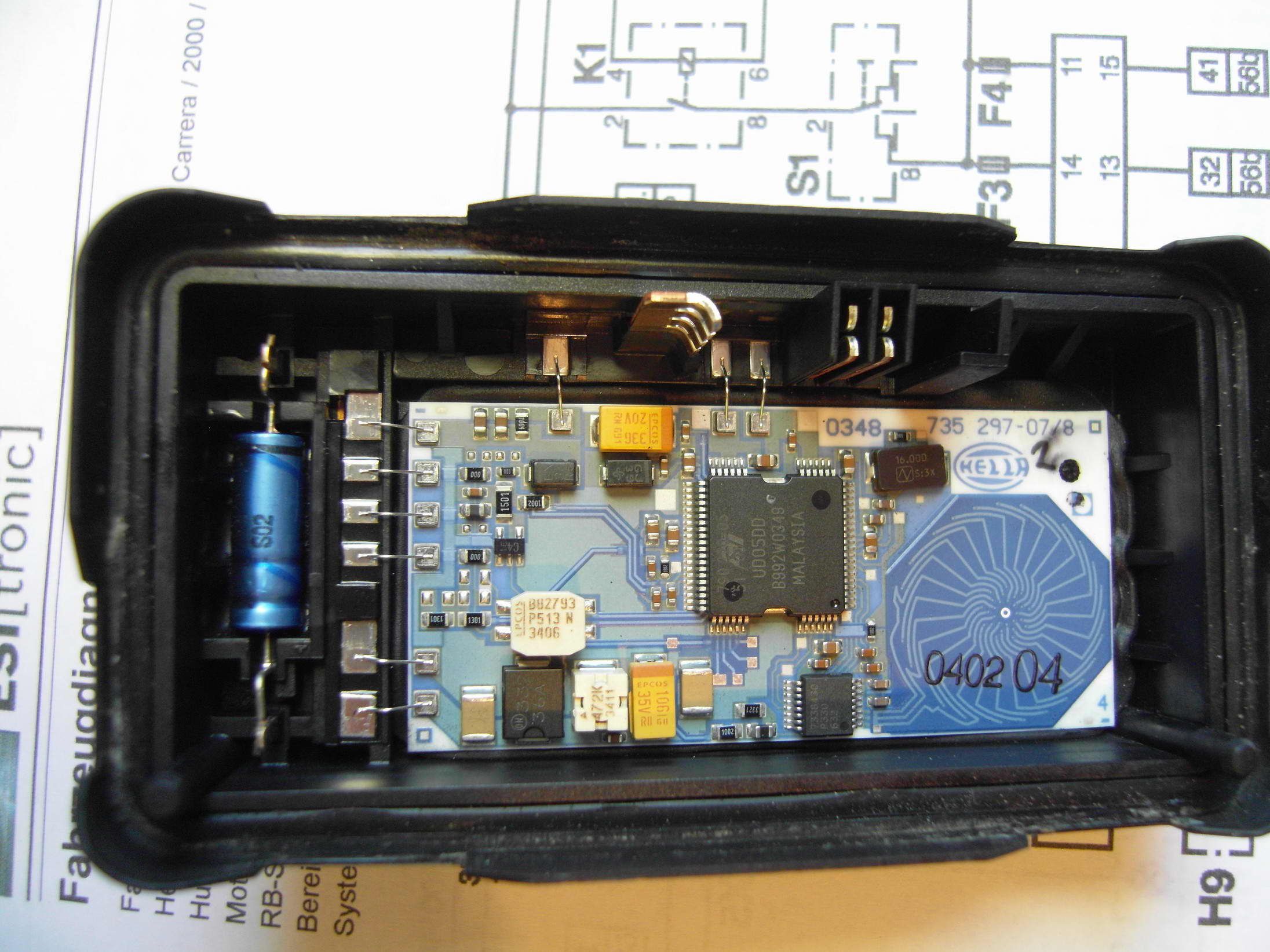

(04-18-2011, 01:30 AM)Pali Do you mean this capacitor?
I mean the big blue one left.
My other actuator does not have this and my electronic buddy said that this capacitor is the indication for PWM.
How it reacts on different % I don't know, I never got it to work.
I have one single PWM actuator but it seems to be dead.
Check out haengomensch on youtube, he got one to react.
140Hz and rectangle signal is correct.
I believe that you have to apply the +PWM to pin 4.
Tom
Pali
7
04-18-2011, 02:59 AM #121
I think, the big blue capacitor is not the indication for PWM. He is on power supply (pin 1,2) and he serve as supply filtering (from my opinion).
Yes, i have apply rect. signal on pin 4.
Can anybody confirm, that the actuator works with rect. signal 140Hz (moves he to the middle position)?
Many thanks in advance.
This post was last modified: 04-18-2011, 03:14 AM by Pali.

Hi Pali Smile
(04-15-2011, 07:20 AM)Pali found you out, if your actuator fail or not?
I think, my actuator is ok. I have two actuators don't work via PWM but work fine in car.
(04-15-2011, 07:20 AM)Pali - which actuator should work with PWM and which only with CAN.
I don't know how to recognize actuator by pcb but I found following:
1. Actuator form BMW 2.0, Ford 1.8 doesn't work via PWM
2. Actuator from Mercedes works via PWM
All actuators have the same part number (712120, 6NW008412), but there is difference in center square number: BMW and Ford have '4', Mercedes has '2'.
(04-15-2011, 07:20 AM)Pali - or all actuators should work with PWM and if not work, is the actuator faulty?
I don't think so.
(04-15-2011, 07:20 AM)Pali - if some actuators work only with CAN, have anybody foud out, how to test these actuators?
I know CAN message form Hella actuator to engine ecu. I need CAN message TO Hella actuator. Look post #95 on this thread.

Hey there guys,
Thanks for the information posted here so far. I know it's been a while for this thread, but still wondering about some things..
Just for clarification once again, if I'm lucky and my Hella actuator actually IS the PWM type, which it should be (712120-1 from a MB mid-2000 CDI?), the correct settings are:
Pin 1: 12V (at round connector side?)
Pin 2: GND
Pin 4: PWM @12V, DC between 5 and 95%, with 50% being center position
Please let me know if this is correct.

02-20-2012, 04:20 AM #139
(01-25-2012, 02:45 PM)janus Just for clarification once again, if I'm lucky and my Hella actuator actually IS the PWM type, which it should be (712120-1 from a MB mid-2000 CDI?), the correct settings are:
Pin 2: GND
Yes, it is correct. Set PWM freq to 140Hz.

Try to use transistor in open collector mode as output sage. In this case you won't need care about high level PWM voltage.
Best regards,
Darqs

I had placed the actuator so that on the right side i had the outer connector with the 5 pins and the power supply filter capacitor (big blue one), that way the MCU is also the same layout as depicted in Fig. 2 (pinout) of the datasheet.
OUTL, OUTR: connected to the motor terminals, where the poles are rising up along the wall of the black actuator plastic housing, with both being at the same static voltage level; level is the same from the MCU pins to the motor pins. When looking at it from top, the left motor terminal goes to OUTR and the right one to OUTL.
PWMI, PWMO: (imho) strange things happening here. They are somehow connected to the signal to Pin 4 (PWM) of the external actuator connector. With Pin 4 open, both go to 12V, and every 3 seconds there is a short grounding pulse. I guess that is what the Hella guy was referring to when he said there is a grounding pulse on error condition. This same signal can also be measured on the external Pin 4 when open.
For testing i also applied 5V to Pin 4 and noticed that the voltage would be static 5V at PWMI and PWMO. When disconnecting the 5V, it would go to 12V again, with the 0.33Hz GND pulse; but the PWMI would drop to 0 first and then apply 12V, whereas the PWMO went to 12V instantly. So somehow it seems PWMO is set up for mirroring or copying this signal?
The (TS?)SOP16 packaged 16 pin IC next to the inductive rotary position sensor field coil is used for just that (position sensing), but seems it's also some proprietary IC. Maybe PWMI/O is related to that one to determine rotor position? Haven't checked if there are common pins or something..
Something more to note.. Since I had the top of the actuator (motor, gearing, CIPOS rotor indicating the position) taken off, maybe there was an error condition present since the position of the actuator could not be determined.
Well long story short.. So far I haven't had any luck with getting my actuator to rotate except when i apply voltage straight to the motor terminals. Any input on the signalling parameters for the PWM on Pin 4 i have to feed in for commanding the position? I might look into rigging up that open collector stuff although i'm not sure how this would help.

Hi janus,
There is some details about open collector circuit.
Best regards,
Darqs

one year later and i bought another actuator. this time it worked first time i tried the signal generator - hell yeah! Smile now i can go on and order/build some kind of hardware to do the control job.
hey Darqs, if you're still on here (also to anybody else who could share some insight on this) i have a question on the open collector schematic there.
the transistor here is actually switching pin 4 to pin 2, which is ground (low), no? i would imagine it should be switched to high?
This post was last modified: 10-09-2013, 08:59 AM by janus.

The circuit from Darqs a few posts ago will work perfectly on the PWM versions and yes both 140hz and 300hz versions have the same pinout. I have seen an arduino project for moving one of these somewhere.
The eeprom is programmable with the right piece of equipment but only turbo manufacturers and some rebuilders have the equipment.
This post was last modified: 11-05-2013, 03:50 PM by pemtek.
