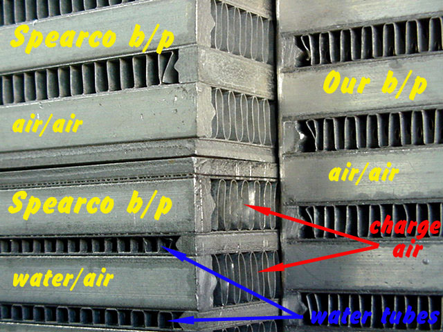

03-26-2009, 01:48 PM #4
There is no such thing as an air/air or air/water core. In the cores there are two flow paths, one has more area than the other. In air/air intercoolers the path with greater flow area is presented to the cooling air, and the charge air must pass through the more restrictive path. With an air/water intercooler flow paths are reversed with the charge air being directed through the path with the greater flow area, and the water through the more restrictive path.
I agree that the straight through flow path of that IC is better, but its design is not really conducive to the non-cross flow heads on the 617. You will have to add just as many bends as the 180 degree IC, if not more, to get it to work with the engine.

03-26-2009, 02:41 PM #5
Actually there is a difference between air/air and air/water cores if they are built right. The air/water cores (the good ones) are treated to prevent corrosion. This treatment reduces thermal conductivity some so they don't do it to all cores.
Piping losses are something to consider and may eat up all the gains made. To find out you have to try it and test it or know how to get a computer crunch numbers for a week for you. Tongue

03-26-2009, 03:35 PM #6
Water cores have significantly smaller sections for water. Water has a higher thermal conductivity per volume so reducing the coolant passage size gives the air more surface area to contact and dissipate heat.
There is one less 90* angle in my system. In airflow resistance, one right angle is equivalent to 10 feet of straight pipe.

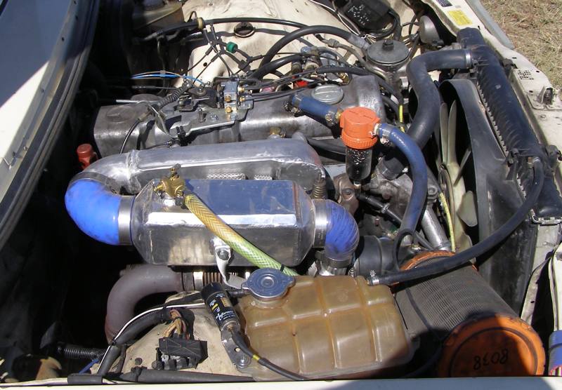

I finished the mock up stage tonight, tomorrow I'll work on getting it installed.

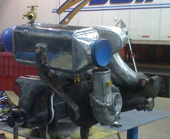

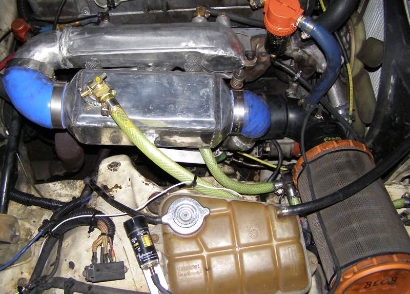

09-15-2009, 03:09 AM #12
(09-15-2009, 01:19 AM)kamel Badass! What about the sharp turbo outlet to intercooler angle?
The 06 sprinter turbo I have in mock up (the $30 one with the melted turbine) has a little bit different angles and dimensions than the 03 turbo on my car. I have my fingers crossed that my eyeball measurements are close enough... Rolleyes I have a 2"-3" 90* boot to connect.
Quote:What radiator will you use? A/C condenser as radiator?
Yes. The 5/16" ID of its tubes might be a little restrictive, but I'm betting the large surface area will make up for it. Outside the condenser it will use 5/8" tube and the stock heater pump.
Quote:Btw., do you know how the distribution of the water inside the IC is done to guaranty even water flow on the whole area?
The water connections are on the opposite sides of the core. It should distribute the same as a radiator.

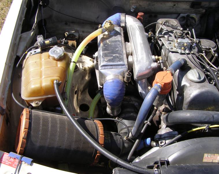

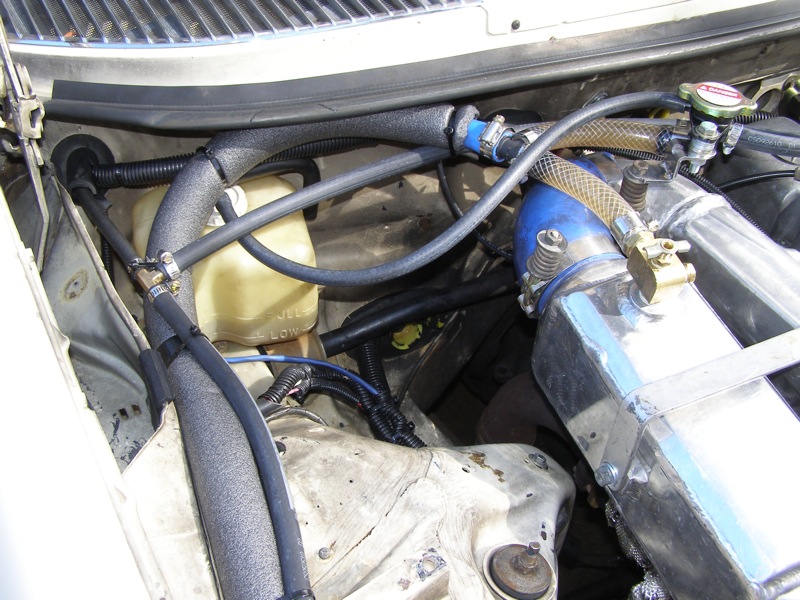

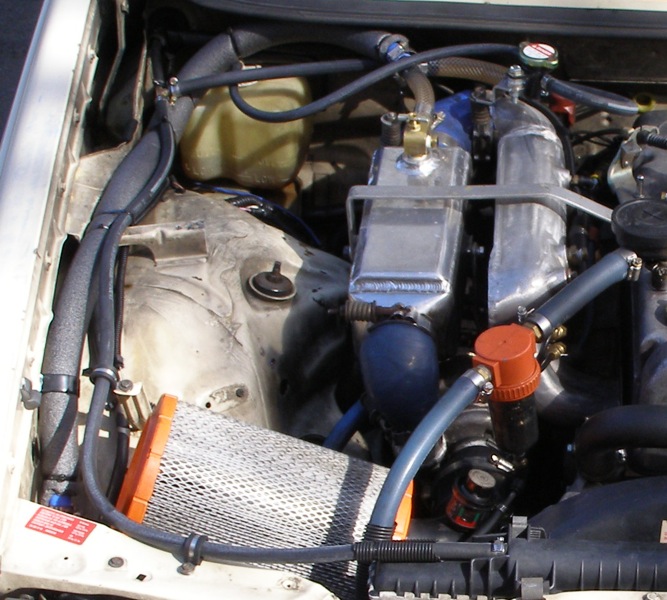

09-16-2009, 02:18 AM #15
I'll post some more pictures later, my camera takes blurry pictures in low light.
Flow is cold in the top (rear), hot out the bottom (front), into the heater pump, into the top of the condenser, flowing down and straight back to the top. Total capacity is 3 quarts and the pump circulates very well on its own. The pump is powered by the cruise control socket (for a convenient switched power source) with a 1amp fuse inline.
Coolant is 60/40 water/antifreeze. I would have gone leaner but I don't want to risk ice this winter.
The hoses in between are temporary, the IC was vibrating too much, I'll have to make an additional brace later on.
Filling is done though the top hose then a small funnel at the bleed vent when it reaches capacity. There is no cap, the system is cool enough that it shouldn't make any significant pressure and I left a small bubble for it to compress (though a filler neck and cap may be added later).
Of course in line with the crappy "everything is resisting my will every step of the way" weekend, I get the system 1/2 full and decided to test the pump. Nothing. Not only was the damn thing seized but it was leaking from the cover seal. So I did an impromptu pump tear-down, got the bearings freed, commutator decarboned, all the coolant residue removed and used some plastic sealant on top of the cap o-ring.
Overall I'm happy. Cruising temperatures are down 25-50*f, it takes much longer to reach 1250*f at full power (I still need more boost) and it muffles the intake noise very well (other than the turbo Big Grin). After getting off the highway the condenser inlet was 119*f and outlet was 71*f (65*f ambient).
This post was last modified: 09-16-2009, 02:22 AM by ForcedInduction.

09-16-2009, 08:18 AM #17
(09-16-2009, 02:18 AM)ForcedInduction Cruising temperatures are down 25-50*f, it takes much longer to reach 1250*f at full power
Awesome work Forced! That is a very interesting intercooler layout, and I just wish Frozen Boost made one a little smaller so we wouldn't have to cut it so close on the turbo outlet.
So is the intercooler really doing anything if your max EGTs are the same? Didn't bgkast have much lower temperatures after he installed his?
One thing you should check is the flow rate through the condenser. If you haven't paralleled it you're going to have really low flow. My roommate did some testing on his Rabbit's A/C condensor, and it had a 25psi drop across it at 2 GPM. He paralleled it and got the same flow at a much lower PSI drop (don't remember what). Using an MB aux pump he is able to get about 1 GPM.
Once again, very nice install! I need to get one in my wagon now that it is running again! Big Grin

09-16-2009, 08:56 AM #18
Kind of hard to tell but is it shielded from the turbo? Any idea of the pressure loss across the IC? My plan is to take the stock head and the cheapo IC and make a single piece out of it, like the 603 on the rack.

09-16-2009, 01:07 PM #19
(09-16-2009, 08:18 AM)Tymbrymi so we wouldn't have to cut it so close on the turbo outlet.
It would be far easier with a T3/K26 or a Holset turbo. The GT turbos are very compact compared to older designs.
Quote:So is the intercooler really doing anything if your max EGTs are the same?
Its working, but it can't stop EGTs from getting high when raw fuel (black smoke) is coming out the exhaust.
Quote:Didn't bgkast have much lower temperatures after he installed his?
He put it on with stock MW pump fueling.
Quote:My roommate did some testing on his Rabbit's A/C condensor, and it had a 25psi drop across it at 2 GPM. He paralleled it and got the same flow at a much lower PSI drop (don't remember what).
A large pressure drop is a good thing that means its taking out a lot of heat. Low pressure drop is important in the intercooler because it would hurt performance and efficiency. In a radiator its a good thing since the longer its in there the longer it has to take out heat.
(09-16-2009, 08:56 AM)winmutt Kind of hard to tell but is it shielded from the turbo?
For now, no. No time was left.
Quote:Any idea of the pressure loss across the IC?
No idea yet since my boost pressure is controlled from the intake pressure. There is a fitting on the compressor housing so I can check later.
Quote:My plan is to take the stock head and the cheapo IC and make a single piece out of it, like the 603 on the rack.
That is what I'll do if I make another attempt (make the outlet of the IC part of the manifold plenum).

09-20-2009, 04:19 AM #33
Here is a better picture. The orange is some leftover A/C dye from the condenser, I've purged it all out now.
This post was last modified: 09-20-2009, 04:27 AM by ForcedInduction.
09-29-2009, 11:26 AM #34
Good news, bad news.
Good, the filler neck and cap are installed and work.
[Image: LMNicradcap9-29-09.jpg]
Bad, I've learned that air is being pumped into the water core when boost is above 15psi more than a few seconds. Sad
Seen here as coolant puking out the 1.1bar cap.
[Image: Picture2.jpg]
This post was last modified: 09-29-2009, 11:29 AM by ForcedInduction.

10-02-2009, 01:41 AM #36
Could it not be a leak? There has been no water loss at all and limiting boost to 10psi hasn't produced 10psi in the cooling system.
Here is video of the event: http://www.youtube.com/watch?v=znpJXqlGfx0
Reviewing the video again, I see its not immediately venting water under pressure. Boost is 17psi about as soon as the throttle is floored (0:29 of the video) and the water does not vent until 15 seconds later (0:44). Could the pressure just be from the expansion of the water as its heated by the boost? The water outlet was warm, but not too hot to hold, and the water inlet was near ambient.
If thats the case, an expansion chamber should fix the problem.

Update. Combo system V2.
The engine has two separate cooling systems, one to cool the engine and a second one to cool the boost air.
Both systems are separate except for two connection points. These connection points allow an expansion tank and pressure cap (1.1bar) to be shared, eliminating the large tank on the fender.
The two systems are coupled together at the radiator's old expansion tank hose to the outlet side of the circulation pump and the radiator's air vent hose to the in-cabin 1L expansion tank. The bottom tee has a 1mm orifice for level equalization and the top tee has a 2mm orifice for air bleeding and fluid expansion.
The hose angle has been changed to reduce the hose movement from engine vibration that was causing a hose hold-down clamp to break. It also allows the fill point to be located 1/2" higher than before.
The circulation pump is always running with the ignition on.

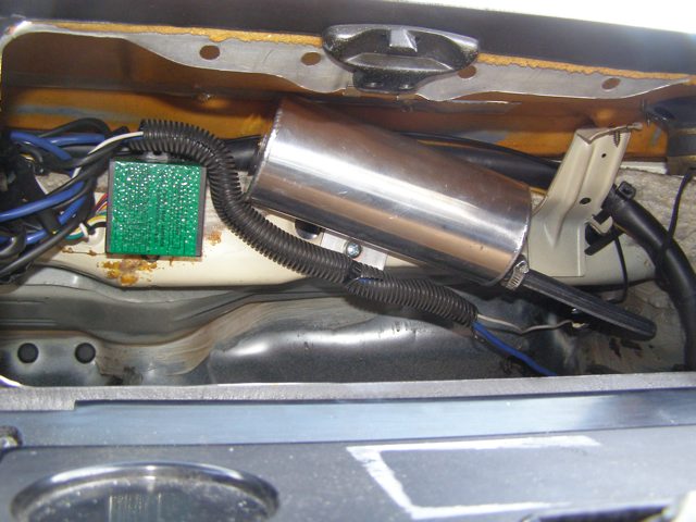

EDIT: I just realized I have never posted a picture of the expansion tank.
This post was last modified: 03-16-2011, 09:53 AM by ForcedInduction.

03-17-2011, 02:50 PM #46
Cool setup! Got some questions here; maybe just clarification on pictures...
1. Where is the AC condenser? On the outlet side of the pump I assume...
2. Cooled water coming from the AC condenser / Radiator expansion Tee (1mm orifice) is going through the insulated hose over the fender?
3. Both vent hoses are connected via the 2mm orifice, that makes sense. Where is the orifice, in radiator vent hose or IC vent hose?
4. The expansion tank is sealed? Only one hose going to it?
5. What is the other small tank in place of the battery with he hose that also looks like it is going to the fill point?
6. What did you use for the orifices?
7. Where did you get the fill point and cap?

03-17-2011, 06:02 PM #47
(03-17-2011, 02:50 PM)Captain America 1. Where is the AC condenser? On the outlet side of the pump I assume.
Stock location. The pump pulls through the radiator/condenser and blows the water uphill to the intercooler.
Quote:2. Cooled water coming from the AC condenser / Radiator expansion Tee (1mm orifice) is going through the insulated hose over the fender?
Yes.
Quote:3. Both vent hoses are connected via the 2mm orifice, that makes sense. Where is the orifice, in radiator vent hose or IC vent hose?
Its in the radiator side of the brass tee.
Quote:4. The expansion tank is sealed? Only one hose going to it?
Yes. It has to be sealed so an air pocket will be trapped inside.
Quote:5. What is the other small tank in place of the battery with he hose that also looks like it is going to the fill point?
Catch tank. Since the relief cap is at water level any pressure venting would push out fluid and vacuum from contraction would suck in air. The catch tank both gives water someplace to go and lets the system suck water back in as it cools.
Quote:6. What did you use for the orifices?
Brass allen socket hole plugs.
[Image: 190497523855_0.jpg]
Quote:7. Where did you get the fill point and cap?
eBay. Its original application is on a Honda Goldwing motorcycle.
