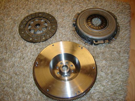

There is ready model to om6xx and long clutch axle combo CrMo wheel and it cost 250eur asked today. There fit that -765 pressureplate
jeemu
04-04-2011, 02:57 PM #22

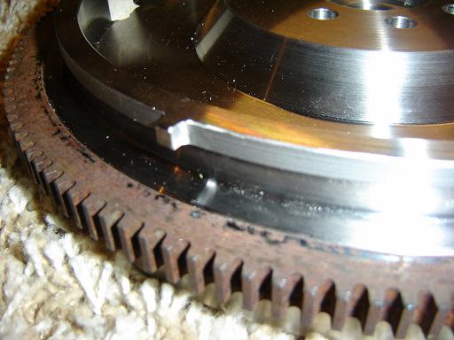

04-06-2011, 02:26 PM #24
(04-06-2011, 09:19 AM)winmutt On which flywheel? m103?
(03-20-2011, 02:08 AM)muuris I have Sachs ..765 pressure plate on a custom flywheel.
Pic.
This post was last modified: 04-06-2011, 02:30 PM by muuris.
muuris
Pic.
04-06-2011, 02:35 PM #25
NICE! Do I see a step to increase clamping force, or are my eyes deceiving me?

04-07-2011, 12:42 PM #27
(04-06-2011, 02:35 PM)300D50 NICE! Do I see a step to increase clamping force, or are my eyes deceiving me?
Pressure plate is for a BMW, which has 10mm disc. The Merc disc I use is thinner, so the step is needed in order to achieve the specified clamping force.
muuris

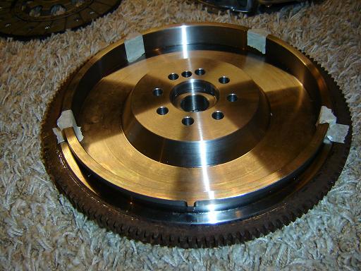

05-05-2011, 12:00 PM #30
On this thread you can see the solid mass fly wheel I am using on my om603 6spd project it is for a sprinter 2.2 CDI to replace the original dual mass flywheel! http://www.superturbodiesel.com/std/thre...ch-options
Notice the pilot bearing in the flywheel not the crank shaft it's for the shorter style input shaft transmissios
This post was last modified: 05-05-2011, 12:06 PM by willbhere4u.

05-06-2011, 04:13 AM #37
(05-06-2011, 01:30 AM)jeemu Any Mercedes Cluch kit not hold up there long
maybe i will order this FW and modify it for the sachs 765 pressure plate.
what do you think??
Diesel-Frank
what do you think??

05-06-2011, 10:01 AM #39
I would call and see if they can get you just the flywheel!

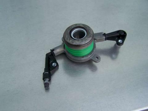

05-06-2011, 03:07 PM #42
(05-05-2011, 11:37 PM)Diesel-Frank what is a concentric slave sylinder??
here is pic of one
It a slave cylinder that mounts inside of the transmission. The 6spd I have uses this set up
Its a slave cylinder and through out bearing all in one. no clutch fork!
This post was last modified: 05-06-2011, 03:09 PM by willbhere4u.

05-06-2011, 03:12 PM #43
(05-06-2011, 03:07 PM)willbhere4u
here is pic of one
i don`t need it on my transmission??

(05-05-2011, 11:37 PM)Diesel-Frank i don`t need it on my transmission??
Only if you transmission was set up for one originally. If not you don't need it
My transmission is out of an 02 C230 kompressor and that's what they came with stockCool

yes, but i thinking about the slave cylinder, should i order the kit with the "normal" slave cylinder, or the one that is inside the clutch house?

(05-06-2011, 03:27 PM)Diesel-Frank yes, but i thinking about the slave cylinder, should i order the kit with the "normal" slave cylinder, or the one that is inside the clutch house?
The first link I gave you is just the clutch kit with out any slave cylinder
concentric slave cylinders Will only fit it the transmission originally had one!
All of the sprinters/newer model Mercedes 2000ish? and newer use them stock
don't quote me on the year but that's what on my 02 6spdBig Grin

removed my dual mass flywheel and on the back it has 5 raised markers for the crank sensor and 1 marker is like drilled. Is there any solid flywheel i can use and keep my sensor working?

05-08-2011, 07:15 AM #48
Hi. I ordered my friend 605 + short axle tranny special made FW
Original sensors work.
jeemu

05-08-2011, 07:26 AM #49
(05-08-2011, 07:15 AM)jeemu Hi. I ordered my friend 605 + short axle tranny special made FW
NICE!
what prussure plate and disc is on the picture??

05-08-2011, 04:11 PM #50
(05-08-2011, 07:26 AM)Diesel-Frank
NICE!
Hi. Sachs Race pressure plate to Bmw m3 and Mercedes 250d disk.
same pressure plate found my own car.
