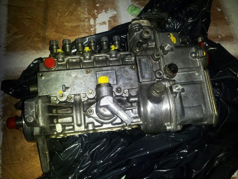

10-22-2012, 05:30 PM #185
[Image: 7.5mm.dieselmeken.jpg]
Oh I am sorely tempted to mount this today. However, I've got the week of thanksgiving planned for a #22 head, new hx30w and this beast.

11-12-2012, 08:58 PM #196
I am almost ready for turkey week...

gorans pump
[Image: 2012-11-11%252020.00.27.jpg]

I can't wait...I have everything but a pump and my new 22 head installed. I do have an HX35 however so depending on how your install goes, I will get to decide whether to down it a size. I'm very interested in your plan for intercooling!
1987 300TDT - 260,000 Miles

11-15-2012, 07:49 PM #199
Pump is set for 250-300hp. 603.
