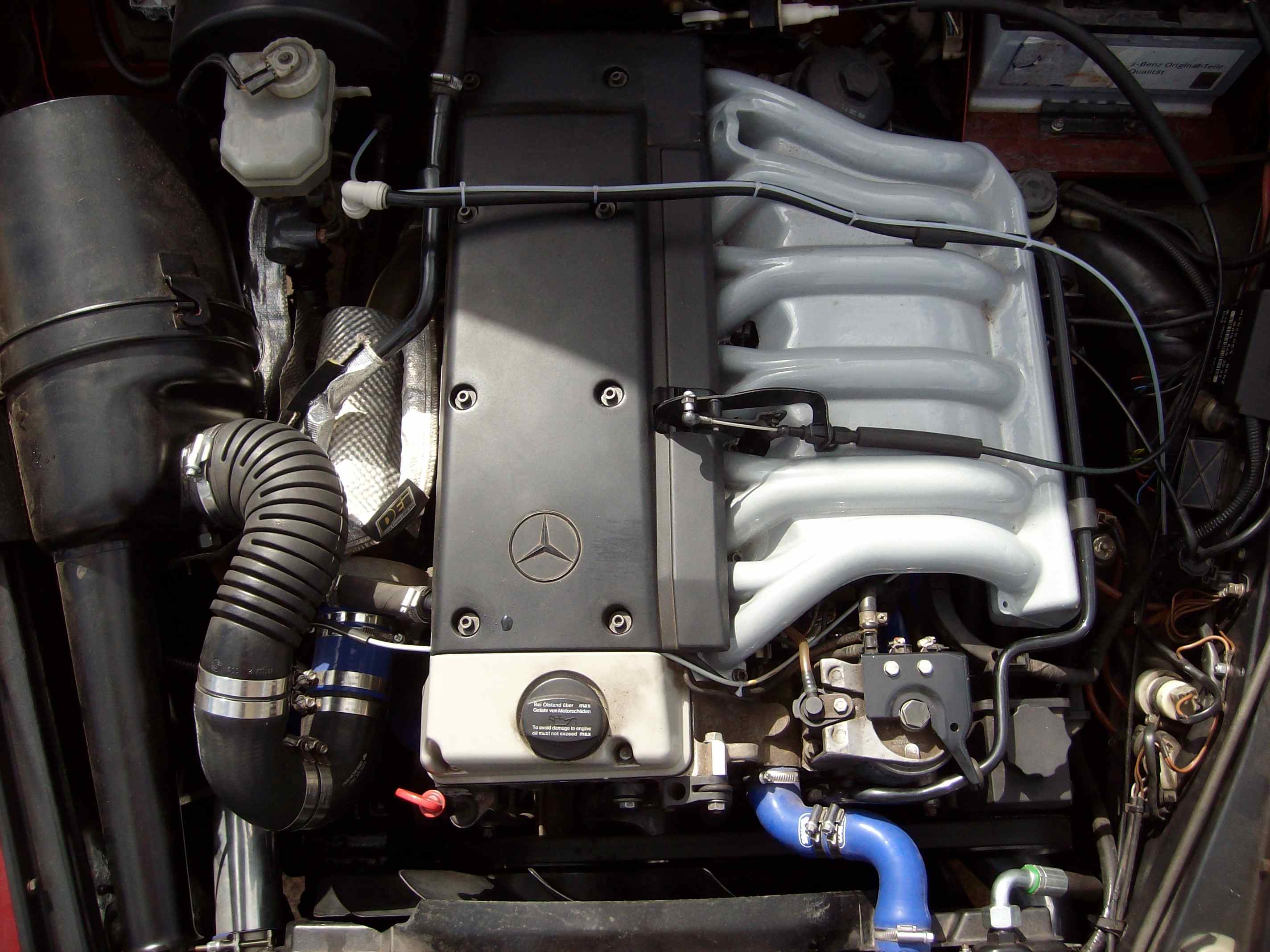

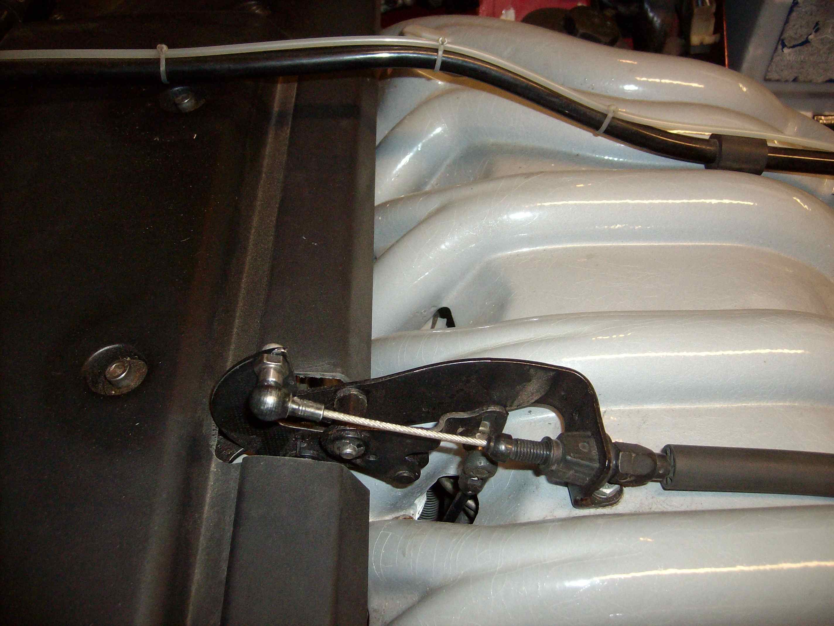

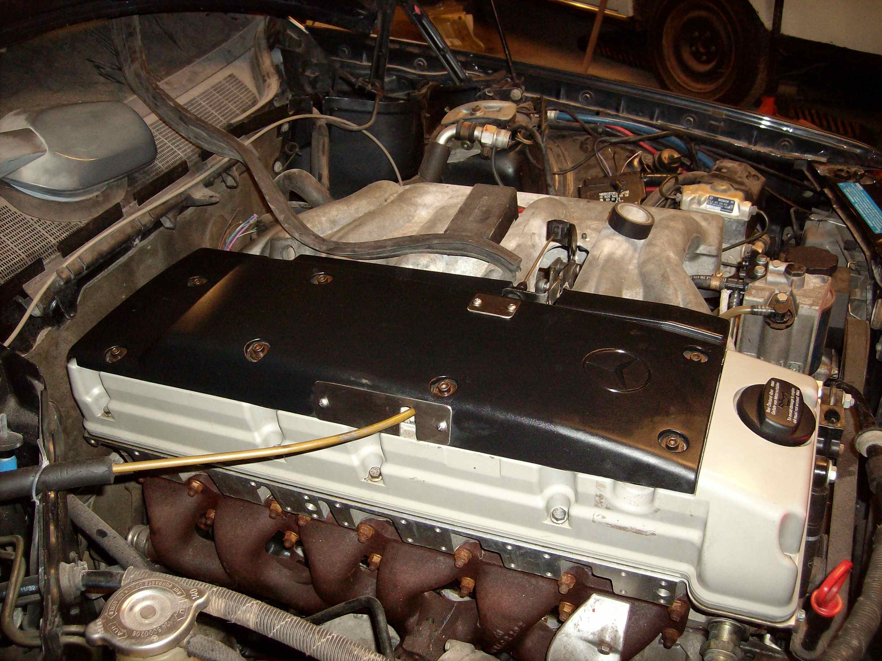

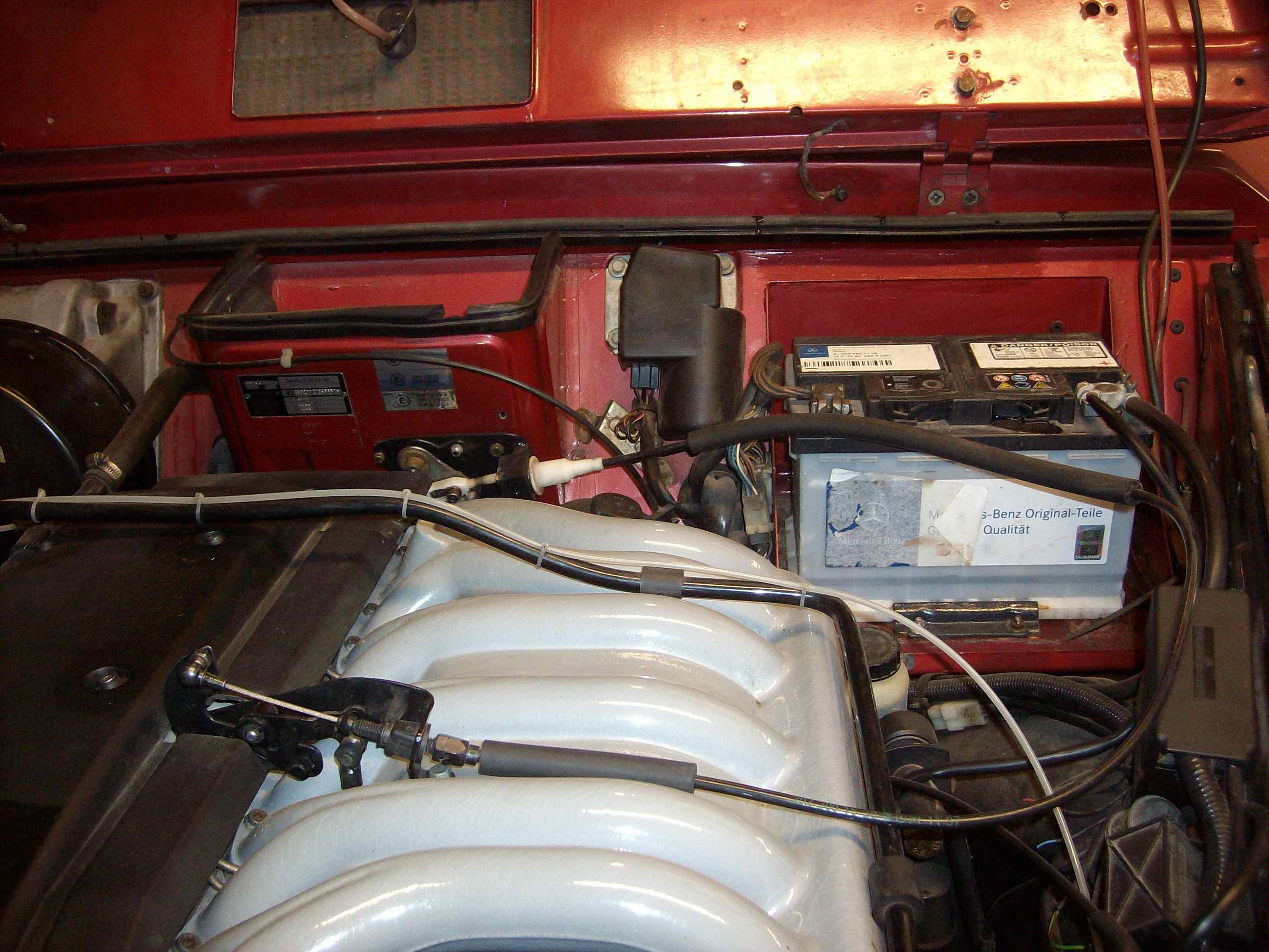

hi don, i posted pictures on your 'picked 606 thread' of my linkage solutions one on a g wagen with 606a and one on a 190e with 606a
hope these help with ideas -mike

hello 'the don' i am running manual 6 speed trans in g wagen and 5 speed manual in the 190 e. for the 190 e i used all new parts ordered for a n/a 2.5 diesel 190 (602 engine) i cut the linkage up and sawed a hole in the web in the inlet manifold to 'sink' it down so it cleared the bonnet or 'hood' i altered the underneath of the plastic cover and ran the cable through the inside so i could use the factory 190e 2.6 gasser cable ,sorry i had not ground and painted it !
the g wagen one i used the linkage from n/a 606 engined w124 and yet again cut it and altered to suit and holesawed down through the manifold web for the rod linkage and a small 'mousehole' in the cover to clear for the fixing . both work really well - mike
