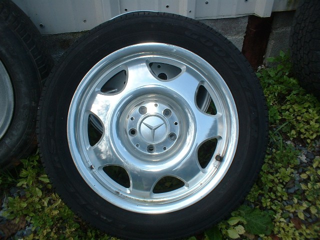

I don't know if this is the right place for this question, but I "happen" to have access to 4 16 inch CLK rims. Is it possible to mount them to a 123? Do I need spacers? I know the offset is different, but would the wider rim make up for it?

Well, technically, CLK rims will fit on the 123 without modifications, especially on the rear.
However, at least with this specific 16 inch rim, there is maybe a 8th of an inch clearance between the tie rods and the edge on the front, too close for comfort, and actually no issues on the rear except that the stock wheel lugs are too long for both.
Ive ordered up 4 spacers which should alleviate both these problems.
05-02-2009, 02:24 PM #4

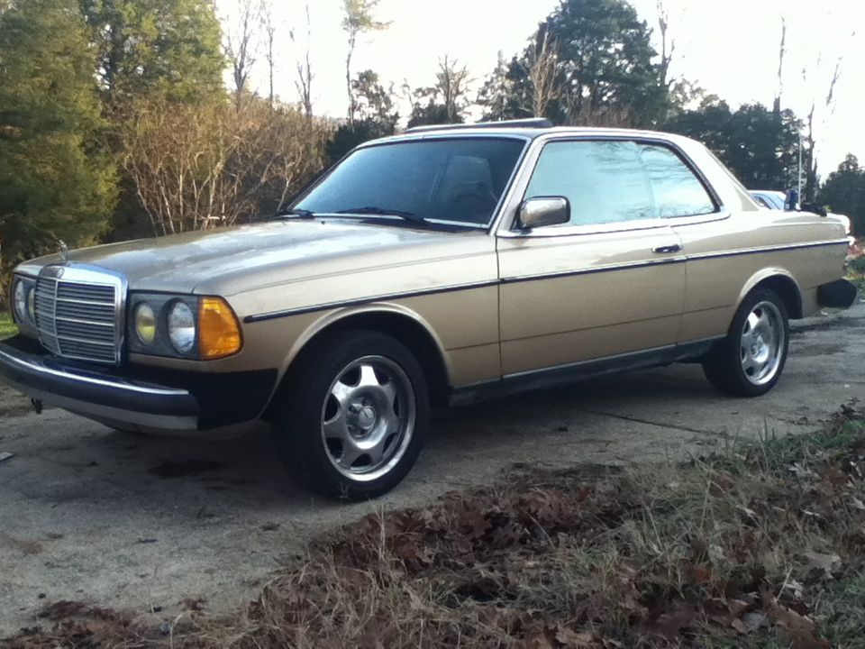

Mounted them with a set of super cheap used 205/55 R16 snow tires on, which the PO reccomended as a good size, but I think I will go slightly larger when I actually put some new all season tires on it. Im pretty pleased with how it looks. Handles a little better on corners as well.

Those look good on there.

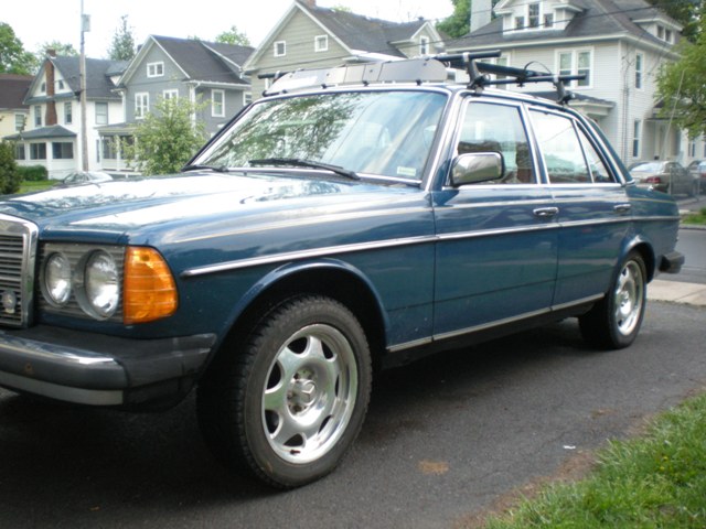

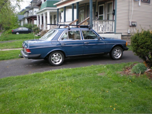

i really like these wheels. I used 5MM hubcentric spacers since the stock alloy ligs were to long and will wreck your ebrake. I have 215/50/16's on em which fit with no rubbing, even with the 1"lower.

thanks, I was not sure what to get but I'm happy w/ 215's. Apparently 225's fit ok too. I'm happy with the coil chop, went w/ 1 coil. Rides/handles great, like a different car since I rebuilt the frontend/brakes. I'm entering it in a hillclimb race just for fun since there is an alt fuel class at this event.

12-26-2011, 10:36 AM #28
(09-12-2011, 05:08 PM)Joe Reitman Thanks.
What mine looks like....
Now I need to work on lowering the car a little
This post was last modified: 12-26-2011, 10:37 AM by NGARover.
NGARover
12-28-2011, 04:56 AM #29
Lower a Lot!
Lower a Lot!
