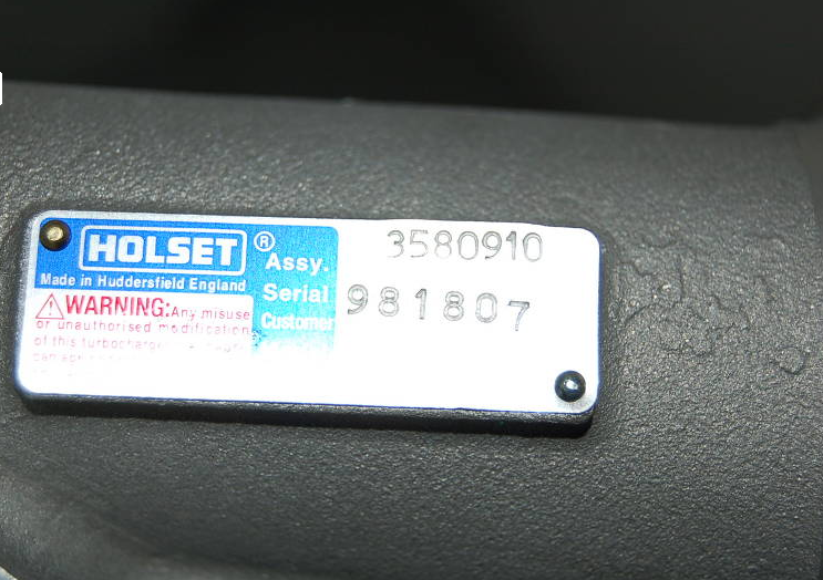

12-09-2012, 11:07 PM #61
Hi guys,
For those of you that know far more than I about turbo chargers can anyone tell me more about this turbo ?
I can't find any information about it on the holset website using the Assy nr 3580910 /981807 . Is this a HX35 family turbo as the nr starts with 35 ? Vendor states inlet.7 and outlet 22. and it's used for truck and industry. How much psi can this baby make ? Flowchart ?
Would this turbo make a good candidate for a om603 daily driver ( so fast spoolup )with 350 - 450 hp ?
Any input greatly appreciated.
Thanks,
Geert
This post was last modified: 12-09-2012, 11:09 PM by GeertDB.
GeertDB
Hi guys,
Thanks,
Geert

04-29-2014, 07:46 AM #93
Garrett GT3063VKL (Although nameplate says GT25 *lol*.....usual for Garrett....)
[Image: 20140429_131851urjyq.jpg]
[Image: 20140429_131901cqksq.jpg]
[Image: 20140429_132139j0jhb.jpg]
[Image: 20140429_1321452jjqz.jpg]
[Image: 20140429_132204u5kxb.jpg]
[Image: 20140429_13221422ju1.jpg]
[Image: 20140429_132226dwk9b.jpg]
[Image: 20140429_1322387bjid.jpg]
[Image: 20140429_1322533ejo8.jpg]
[Image: 20140429_131912vijhb.jpg]
[Image: 20140429_1319317ljeo.jpg]
[Image: 20140429_131935n6k7u.jpg]
[Image: 20140429_131948fxj32.jpg]
[Image: 20140429_131957gjj00.jpg]
[Image: 20140429_13204719klq.jpg]
[Image: 20140429_132051z5kpd.jpg]
[Image: 20140429_13210720jfi.jpg]
