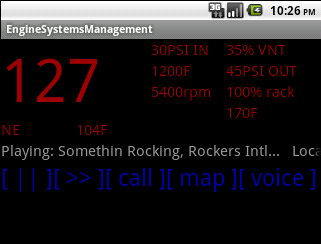

The idea is simple, combine an arduino, a few sensors (boost, altitude, RPM, rack position etc), some bluetooth magic and an Android to create an in car gauge cluster that will eventually control a VGT/VNT turbo.
My first layout:
[Image: attachment.php?aid=4187]
Proof of concept:
http://www.youtube.com/watch?v=BXAOf7vJYEU
My first layout:
Proof of concept:

03-20-2011, 01:16 PM #2
why bluetooth+android instead of running some gauges? or what about giving the setup its own lcd?

03-20-2011, 08:44 PM #9
(03-20-2011, 01:16 PM)stan why bluetooth+android instead of running some gauges? or what about giving the setup its own lcd?
Well lats face it. Gauges of any kind rarely look as good and as clean as stock. They also dont blink bright red or set off klaxons. The cost of an LCD is ~ the cost of the bluetooth shield. I have found what I consider to be an awesome place for my android.

03-25-2011, 01:43 AM #17
Moving forward with things that the Android excels at. GPS speed VS reported from speedo.
I have been looking at the GPS code and this will be the next implement. Reported speed vs GPS. The display will always show GPS speed and then reported speed as an offset.
Nothing much other to report than I got landscape mode working properly and will be the default for car dock.
