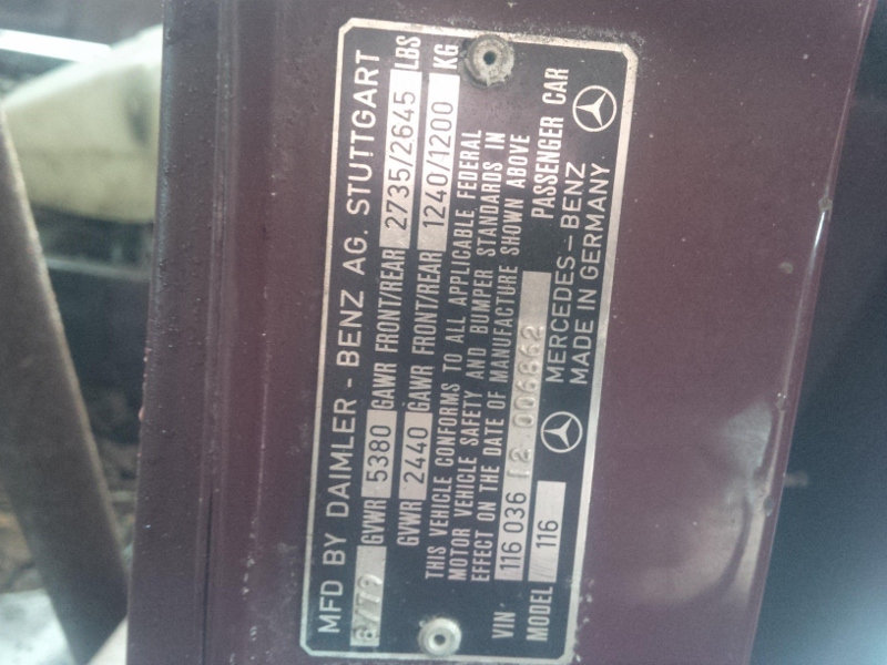

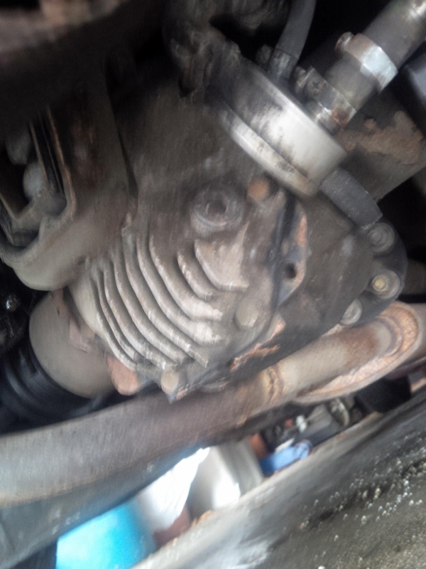

A 1979 450 SEL 6.9 with a 2:65 LSD is a direct, drop in replacement for the W123?
OR
A 1972 W116 6.9 with 2:65 Diff with the Clutch Pack is a direct drop in replacement for the W123 ?
Please let me know
01-30-2014, 11:11 AM #19
OK,
So, just to confirm:
OR
Please let me know
Jooseppi Luna
Certified Nut
114
01-30-2014, 11:36 AM #20
(01-30-2014, 11:11 AM)Greazzer OK,
OR
Please let me know
The second vehicle you listed does not exist. All W116 diffs are compatible with W123s.
Here's a link with plenty of pictures of the 2.65.
This post was last modified: 01-30-2014, 11:48 AM by Jooseppi Luna.
-Jooseppi
1982 300SD -- 211k, Texas car, tranny issues
1979 240D 4-speed 234k -- turbo and tuned IP, third world taxi hot rod Big Grin .  Given to me by JB3, who got it from purplecomputer.
Some blasphemous vehicles in the fleet as well -- 2004 Corolla 5-speed and 1994 Buick Century
2 Samuel 12:13: "David said to Nathan, “I have sinned against the Lord.” And Nathan said to David, “The Lord also has put away your sin; you shall not die."

01-30-2014, 11:50 AM #21
My bad ... a typo of sorts. Here's the range ...
"The high-performance 450SEL 6.9 version of the S-Class was built on its own assembly line by Daimler-Benz in Stuttgart, Germany and based on the long-wheelbase version of the W116 chassis. The model was generally referred to in the company's literature as the "6.9", to separate it from the regular 450SEL.
The 6.9 was first shown to the motoring press at the Geneva Auto Show in 1974, and produced between 1975 and 1981 in extremely limited numbers. It was billed as the flagship of the Mercedes-Benz car line, and the successor to Mercedes-Benz's original high-performance sedan, the 300SEL 6.3. The 6.9 also has the distinction of being among the first vehicles ever produced with optional electronically controlled anti-lock brakes, first introduced by Mercedes-Benz and Bosch in 1978. The 6.9's successor — the top of range 500 SEL — continued the 6.9's remarkable self-leveling hydropneumatic suspension as an extra-cost option."
I was off by a few years ... lol
01-30-2014, 12:24 PM #22
Yes it will fit, with an input flange change out. Just make sure if you are not picking up the diff directly, that the seller verifies that it indeed has clutches. There is a possibility at one point of the car's life the diff was changed out to an open diff.
Also regarding axles, you can use the stock axles, but they will be a tad long. The best bet, would be to install R107 with a 1.3 liter diff (2.47, 2.65, ratio) axles. They will have the correct length.

01-30-2014, 06:22 PM #25
The 2.65 worked great in a w126, and a 2.47LSD in a w123.
You need to change the flange, and use your old driveshafts, and rotate the "support" 180degrees
Nothing more

Getting close to the target: a 1979 450 SEL 6.9 -- just need to confirm that it has the 2:65 LSD?

(01-31-2014, 12:58 PM)Greazzer Getting close to the target: a 1979 450 SEL 6.9 -- just need to confirm that it has the 2:65 LSD?
Thanks again for the info.
should be a 2.65LSD Smile the 6.9 never had anything else unless someone has already swapped it Smile

Well, waiting on confirmation from the seller right now to make sure it's a 2:65 LSD, has the ID tag, et cet., and some pictures. Actually, I am buying an entire 6.9 (M100) 450SEL 1979 if everything falls into place.

(01-31-2014, 12:58 PM)Greazzer As for shipping, you can easily and safely ship in a 5 gallon bucket...
I wouldn't dare risk damaging it by shipping it in a bucket. The only way I'd ship it would be in a well-cushioned wooden crate, on an Old Dominion Freight Lines truck. But I suppose you're right, $500 for the packing and shipping is a little high. Make the price $750 then.
Photos, Post # 37 of my "Selling everything" thread. Note the 2.65 stamp and SP which stands for ...um, "Sperröl" I think. Special oil for limited slip differentials.

02-02-2014, 11:50 AM #47
Here is a picture of the differential. What is that canister on the side of the differential ? Got a pic of the VIN plate too. Can anything be told from the VIN ?
Getting close maybe ...

02-02-2014, 01:12 PM #48
Can is plenum chamber for fuel dropping down from tank. Nothing to do with diff.
This is a screenshot of the relevant page from the EPC. 1:2.65 diff. Doesn't reproduce very well.

02-02-2014, 02:13 PM #49
I tried a number of sites plugging in the following VIN, and nothing ? Says it's not valid ?
11603612006862
11603612006862

02-02-2014, 05:17 PM #50
(02-02-2014, 02:13 PM)Greazzer I tried a number of sites plugging in the following VIN, and nothing ? Says it's not valid ?
11603612006862
That's the vin I used above^ in the Merc EPC to get the info I posted. Although it's faint, if you look in the box top left in the pic it's your vin that's there. It works fine in the official site. What else do you need to know? (although it doesn't give a lot). Sent you a PM.
This post was last modified: 02-02-2014, 05:23 PM by Druk.
