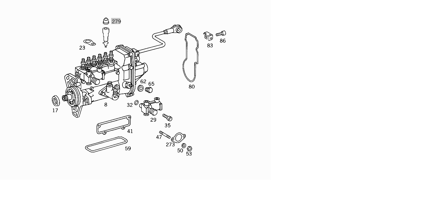

(10-05-2014, 01:11 PM)jordon001 pretty positive mines mechanical
Its an EDC pump, meaning its mechanical like all M-Pumps but a "drive by wire" So it is not adjustable, sort of changing software or elements

jordon001
21
10-06-2014, 07:52 AM #11
Ah ok well thank you for clearing that up. Is there a way I can turn the fuel up?
