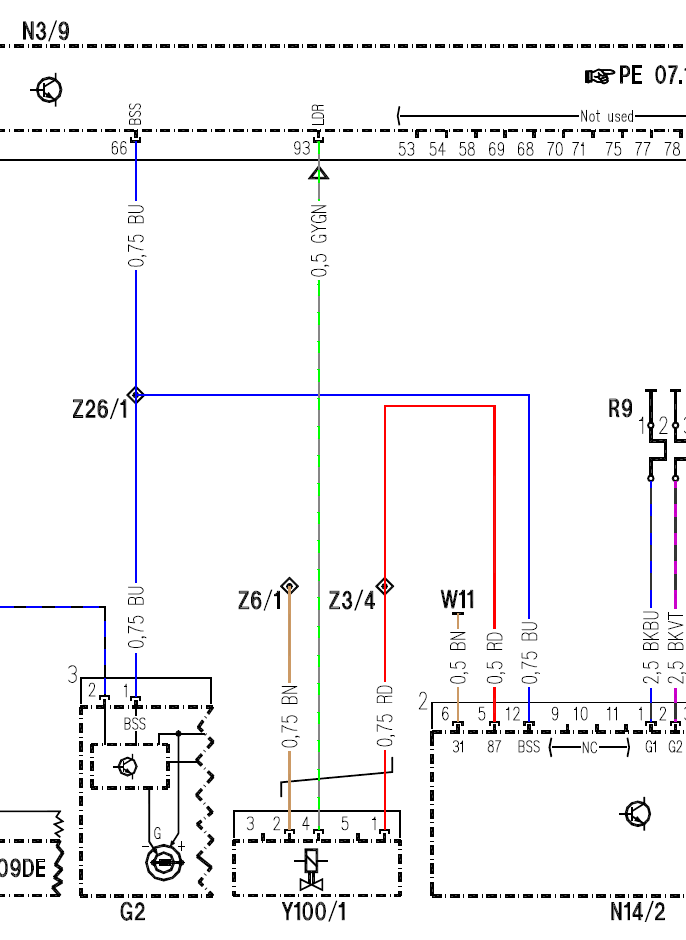

(08-18-2009, 09:13 AM)tomnik I am looking for the pin destination of the Garrett (Hella) electronic actuator for the VTGs.
I thought I saw it some when but can not find it.

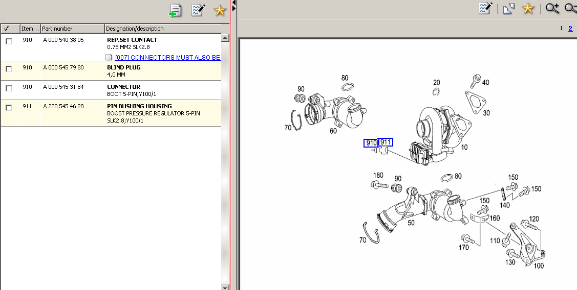

I'm pretty sure Y100/1 is the turbocharger actuator (going from a saved PDF without the key). I know the frequency for the PWM signal you send to it, but I want to double check it before I post it. I have controlled the actuator using a function generator and it works perfectly!! Big Grin

09-01-2009, 09:28 AM #5
(09-01-2009, 09:01 AM)winmutt VTG or VNT? What model is this for? John what PDF is that from?
The PDF was made from the W211 DVD service manual (the ETM part to be specific). The DVD has some copy protection stuff going on, so you have to print the current schematic to a "PDF printer" (PDF Creator) onto *huge* page size. Then you can crop it down to something reasonable.
The schematic is for the GT23 on my '05 CDI. It just so happens that it uses the same Hella actuator as the GT20 I have from a 2007 Sprinter. I think all the Hella actuators are the same, and can be controlled this way. I used a portable oscilloscope from work to get the PWM frequency, and applied that same signal to the GT20 on the bench, and it works flawlessly. Big Grin
I might have a chance to verify the frequency today. Time will tell!

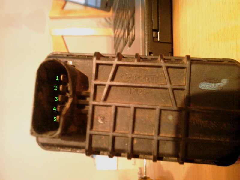

I haven't had a chance to double check it on hardware, but I did fine a camera picture I took of the portable scope that has the period on it. The period is 7.1ms which works out to 140-141Hz. Vanes full open and fully closed don't respond to 0% and 100%, it goes from something like 10%-95% so that a short to ground or 12V won't cause any problems (it'll go to vanes fully open).

09-03-2009, 01:32 PM #10
(09-03-2009, 01:18 PM)winmutt So pin 1 is the signal? I am going to get a working sample of the arduino code for controlling PWM motors and give this puppy a spin! Thanks for breaking the code man, this was an INVALUABLE post.
Pin 1 is 12V, pin 2 is ground, pin 4 is the PWM signal. Big Grin

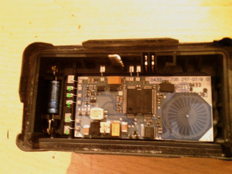

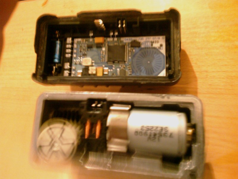

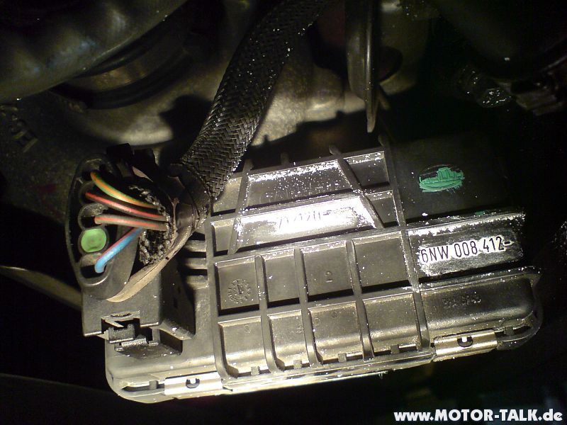

Garrett Hella VNT acuator pics (Tymbrymi can you verify the pins?):
Numbers :
712120-
6NW 008 412-
A quick search shows this is also used on ski-doo :http://www.dootalk.com/forums/index.php?showtopic=275990
Found more one this actuator (probable on GT turbo) from Mondeo site :
http://www.motor-talk.de/forum/mk3-tdci-...vnav=unpin
Notice the different pin out. I have read that some of there acutators can use either PWM or CAN
This post was last modified: 09-05-2009, 12:18 PM by winmutt.

Pictures... http://picasaweb.google.com/Tymbrymi2/GarretActuator captions with pinouts coming soon.

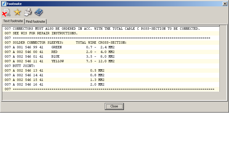

09-09-2009, 08:38 AM #22
(09-08-2009, 02:21 PM)winmutt Hella's website has been down since Sat. I put in a call and got a vm box. We'll see if I get a call back.
According to the EPC the needed PN's are:
2205454628 -- $1.70 -- Qty 1 -- Connector housing
0005453184 -- $4.50 -- Qty 1 -- Connector housing boot
0005457980 -- $2.40 -- Qty 2? -- "Blind plug" Think these are for the unused pins so qty 2??
0005403805 -- $2.70 -- Qty 3 -- The pin contact for the wire
0015469941 -- $3.70 -- Qty 3 -- Connector sleeve (waterproofing rubber piece I think)
0025461441 -- $4.90 -- Qty 3 -- "Butt joint"
Holy cow this is one expensive connector!!! Hopefully those connector sleeves, etc come in five packs or something instead of individually.
Edit: The pictures are readable if you click on them Smile

10-20-2009, 10:51 AM #27
I got another update from the Arduino forums. Testing this week.
This post was last modified: 10-20-2009, 10:51 AM by winmutt.
10-22-2009, 11:22 PM #28
(09-05-2009, 10:14 PM)Tymbrymi Enjoy!! Big Grin
http://www.youtube.com/watch?v=KTqXGK3ZsWk
Winmutt, totally forgot 125Hz. Sad
Is that 10v at 100% duty cycle?

10-29-2009, 02:12 PM #39
(10-29-2009, 12:21 AM)300SD81 Started writing the code for this thing, has anyone confirmed if the actuator cares about the PWM frequency or not? Is it actually sampling the frequency, or just the average analog voltage?
Unfortunately, it DOES care about the frequency. Not sure what its range is, but I remember it didn't work at just any old frequency. Sad I don't think it'll work on an analog voltage either.
(10-29-2009, 12:21 AM)300SD81 The lowest I can get my PWM on the uC is 3+KHz unless I lower the clock speed (64Mhz/4/16 = 1MHz timer frequency, but it the timer for PWM is only 8 bits). Might try feeding it an analog voltage this weekend, and if that dosen't work, I'll just bit-bang the pwm...
You could always get a better PIC Wink That definitely sucks though. It's annoying to have to bit-bang stuff when you have a hardware peripheral that should be able to do it.
(10-29-2009, 02:06 PM)300SD81 Did you get any voltage readings off the original car when you had it on a scope?
Yep! But they're on my old phone, which I won't be able to get to till tonight. I'll try and post them if I get the chance.
(10-29-2009, 12:38 PM)winmutt +12v PWM fried one of the controllers (bloated a resistor) and the TTL of 5v does nothing.
Sounds to me like that was a capacitor. Still that's very strange.
A note to all about soldering on this board... it is a ceramic PCB. In my experience with ceramic PCBs at work, they are EXTREMELY easy to shatter. They are VERY sensitive to differences in temperature. With the PCBs we had made, when you put a soldering iron on a pad while the rest of the PCB is at room temperature the PCB would shatter. You will probably have to use a reflow oven (or toaster oven Wink) to get it to work, and who knows how much of that other stuff would get screwed up in the process. That's my $.02 since it could very well be just the PCBs we had made, and this one is much sturdier. However, I think that's why there are those blocks/pads to wire the PCB to the housing. You can wirebond those wires quickly and the thermal mass of the block/pad will keep the PCB itself from getting warm.
