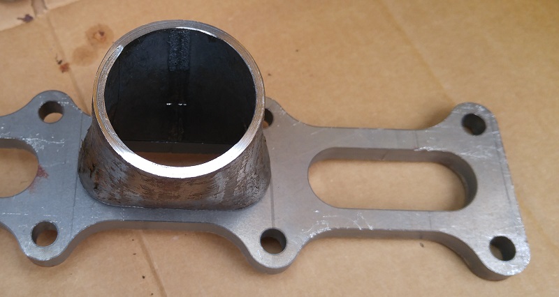

How much would y'all pay for these badboys in mild steel? in stainless?
606 exhaust oval -> 2" ID pipe.
Trying to judge if it's worth the time to makeup a die set.
04-17-2017, 11:00 PM #1

04-18-2017, 01:44 PM #5
First test with the prototype die, using 2.25" exhaust pipe (1/16" wall, has a 2.125" ID)
I didn't center it properly and mangled the round end, but the oval came out pretty nice.  It was a TIGHT fit with the 2.125" pipe, 2" thick wall is going to be a bear!

04-25-2017, 12:12 PM #11
Smushed up a 2" sched40 pipe the other day(It still needs finishing, but this is the general idea)
1.5" will follow(or explode) soon....
04-26-2017, 03:19 PM #12
So yeah, 1.5" schedule 40 wasn't too happy:

05-01-2017, 07:59 PM #15
Ace stainless has the concentrics that I used. I have a bunch of extra flanges if anyone wants them. I have stainless and mild steel.

05-02-2017, 11:17 AM #16
I found local reducers, but the damn things are like $20/pop.  Pressed really nicely though:

05-17-2017, 01:43 PM #17
Awwwww yeahhhhhh

05-17-2017, 09:47 PM #19
(05-17-2017, 05:26 PM)TIMNZ Looking good, regarding the conc reducer size I presume you mean 2.5" x 1.5" or for those of us that use Metric  65 x 40 .
Cheers
Tim
Nope, 2.0" x 1.5" aka 51mm x 38mm.  The die stretches them out all right, I want to say somewhere around 1/5 to 1/4 load on the gauge (It's marked as a 50 ton press, so I assume around 10tons of pressure?
That set's headed to a customer in FL, once I get some free time (haha) I'll be making another two sets.

05-18-2017, 10:05 AM #21
A lot of work, but the outcome is beautiful.

05-30-2017, 02:31 PM #24
I'm thinking that $30/pop ($180/set) for fully machined ready-to-weld covers my time.
