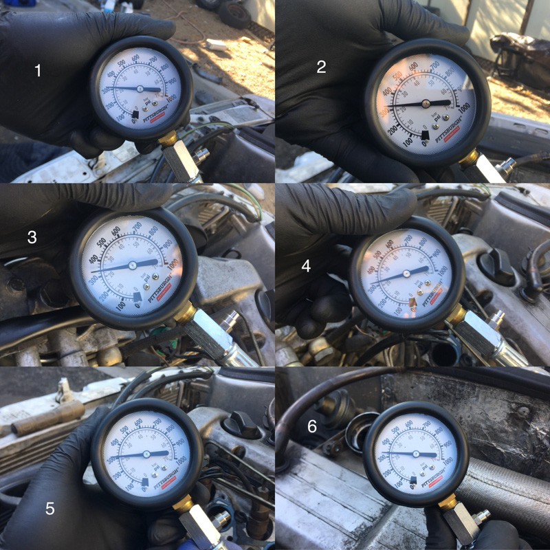

Strong OM603 with 260K miles. Just did compression test and results were excellent. I have planned to do this pump and turbo upgrade for years. At one point I sold the car to a guy and then bought it back two years later. I got it back with upgraded 17 head, rebuilt injectors, and 5-speed. I drove it like this for 7k miles getting 30-35 mpg. At some point fuel economy lessened to 26-28 and power seemed less. I put boost gauge on and I was not making full boost until 4k rpms...I suspected a worn turbo but I went ahead and did one thing at a time. The HX32 was brand new in box dated 1998, 12cm2 Turbine housing.

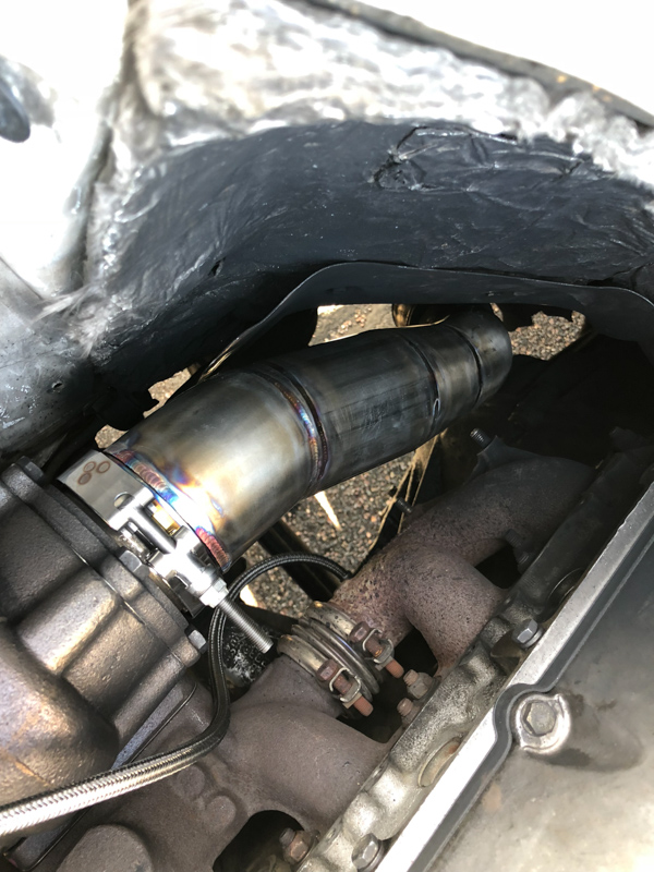

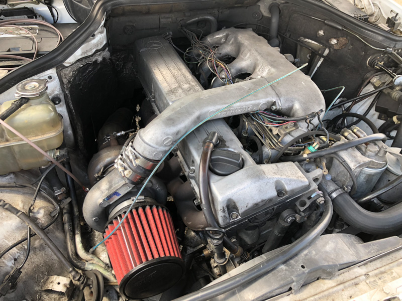

Installed HX32 with Euro manifold: More power but boost begins at 2500 and I only see 5 psi at 3500, then it hits a bit at 4500 and I see 20-25psi (no WG for testing) but by that time I have to shift. The power is totally unusable and I got the HX32 instead of the HX35 so I would have a usable daily driver! The only part that was on BOTH old and new setup is a the flex pipe at exhaust as I re-used it. It did have a small hairline crack I am not seeing soot around it and it does not bubble with soapy water.
Since this photo, I had the oring sleeve welded to compressor housing so it is a solid fit. No boost leaks.
