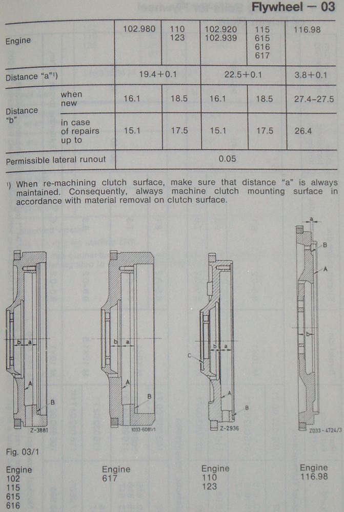

06-07-2008, 04:47 AM #1
Note the OM617 will run fine with the OM616 flywheel.
