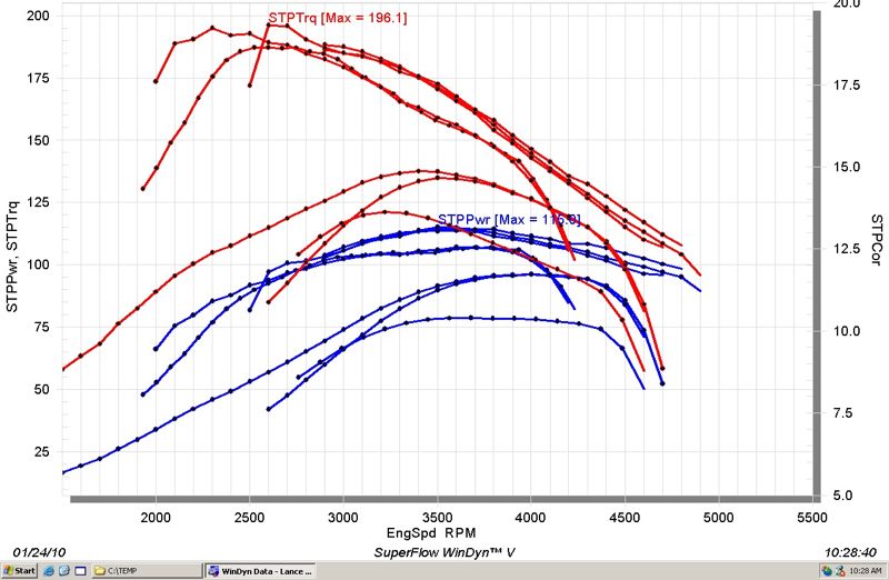

01-24-2010, 12:34 PM #14
(01-24-2010, 11:42 AM)Deni If the increase in power is linear with the increase in rpm then we are looking at about 16% increase in power.
Not quite. You'll get some power because the math allows RPM to easily produce high figures, as long as torque stays constistant. Thats why an F1 engine can have 900hp with less torque than the average V6 sedan. However, the 617's torque steadily drops after 3000rpm causing horsepower to fall after 3800rpm.
For a stock engine (just for my point, I know modifications will change the numbers), if the torque continues to drop at the same linear rate you'll have about 65lb/ft of torque at 5500rpm and produce only 68hp. Less than an OM616. Acceleration will be slower than if you had shifted to keep the engine at it's torque peak.
Attached is a chart of all my dyno runs to date to illustrate.
This post was last modified: 01-24-2010, 12:36 PM by ForcedInduction.

01-24-2010, 01:06 PM #15
(01-24-2010, 12:34 PM)ForcedInduction However, the 617's torque steadily drops after 3000rpm causing horsepower to fall after 3800rpm.
As far as I know, correct me if I'm wrong, the decrease in torque comes because fuel starts being cut off at 3k rpm, until about 5150 rpm on a stock pump when all fuel is cut off.
My original question was, is there any scew i can turn to delay the fuel cut off?

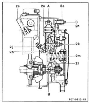

01-25-2010, 11:06 AM #18
(01-24-2010, 01:06 PM)Deni As far as I know, correct me if I'm wrong, the decrease in torque comes because fuel starts being cut off at 3k rpm, until about 5150 rpm on a stock pump when all fuel is cut off.
You're wrong! Now that I got your attention, read backwards and look at my earlier post, #8.
(01-24-2010, 01:06 PM)Deni My original question was, is there any scew i can turn to delay the fuel cut off?
Yes there is. Look at this topic and the M-pump section in it.
If it were that simple, why would MB limit their diesels to rev only 5k, why not 10k and have twice the power...

Deni
GTA2056V
75
01-25-2010, 05:05 PM #19
(01-25-2010, 11:06 AM)muuris
Read the post. Even if efficiency goes down, there's still some gain at top end.
Now I see, it is the torque control. Thanks Big Grin

01-26-2010, 09:39 AM #22
(01-25-2010, 05:05 PM)Deni Read the post. Even if efficiency goes down, there's still some gain at top end.
The point was that the gains aren't so big without compensating the weaker efficiency by boost.
(01-25-2010, 05:05 PM)Deni Now I see, it is the torque control. Thanks Big Grin
No, not that. Max rpm is rised by tightening #23. If you do something with #17, loosen it a bit.
This post was last modified: 01-26-2010, 09:41 AM by muuris.

01-26-2010, 11:23 AM #23
(01-26-2010, 09:39 AM)muuris No, not that. Max rpm is rised by tightening #23. If you do something with #17, loosen it a bit.
I've already risen max rpm to about 5.8k rpm in neutral and 5.5k in 1st or 2nd, but it looses steam after about 4.8 - 5k rpms. Steam that I guess torque control will solve.

01-27-2010, 09:54 AM #25
(01-26-2010, 11:23 AM)Deni I've already risen max rpm to about 5.8k rpm in neutral and 5.5k in 1st or 2nd, but it looses steam after about 4.8 - 5k rpms. Steam that I guess torque control will solve.
What if your governor spring is just old and has lost its best tension?
This post was last modified: 01-27-2010, 09:55 AM by muuris.

01-30-2010, 03:04 AM #31
the fuel curve over rpm is not linear because airflow is not linear in the (high range) rpm.
AFAIK it is the small spring in the spring capsule that determines the bending of the fuel curve. Post#9
Allowing the governor to provide just higher rpm is different (easier) adjustment.
Tom
