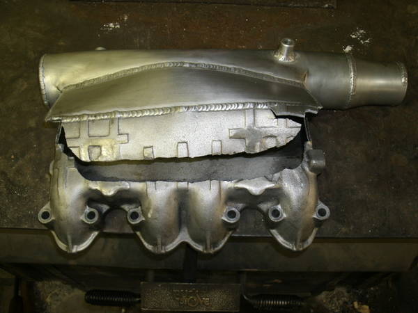

(01-28-2010, 05:27 PM)HoleshotHolset No doubt there will be a lot of thermal shock + higher cylinder pressures...but will it really cause the prechambers to shatter?
I've seen them explode in somebody's engine from filling the tank with g@soline. Blew out the bottom of the prechambers at the orifice holes and the metal destroyed the pistons. Probably would have been a really interesting sound to capture.
