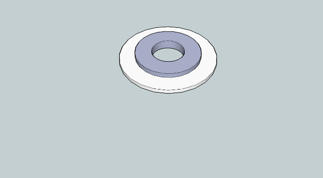

Here is a little sketch up diagram- What if I made a steel ring that bolted to the flywheel AFTER the pressure plate is installed, and extended out over the pressure plate slightly? bolted to the outermost flat surface of the flywheel, in the red area.
I am thinking that a ring could be made that was wider than the release bearing, but was thin enough that it did not interfere with the shift fork and extended out into the void between the pressure plate and shift fork. It would be balanced with the flywheel, and essentially you would have a two part flywheel that unbolted to install the clutch. Since it would be a flat piece of mild steel, it should be something that would be reasonable to make cheaply IF it would fit.

You would want to balance it!!! and make dam sure the bolts that held it on could withstand the rotational forces in play!!! I wouldn't want to see that come apart

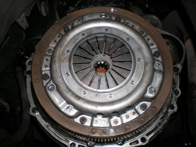

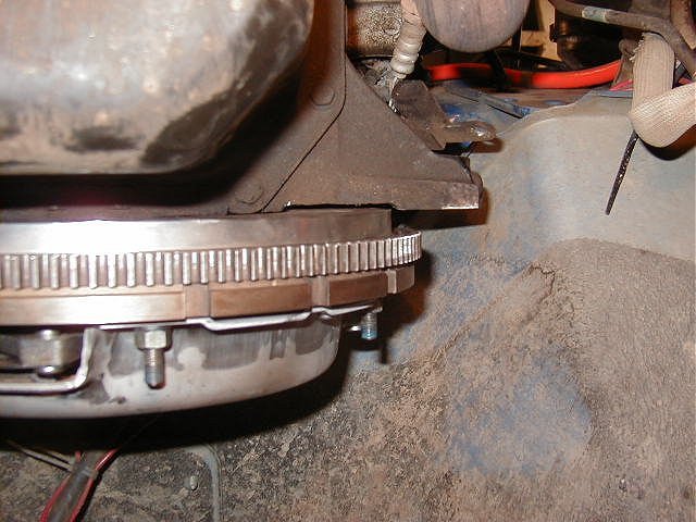

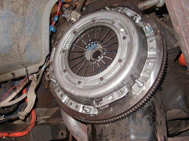

This guy posted adding an "Inertia Ring" to his Jeep's 4 cylinder flywheel to aid in low RPM climbs.
http://www.4x4wire.com/tech/clutch/inertiaring/
He bolted the ring to the back side of the wheel by drilling through the bolt holes used the clutch cover and replacing it with studs.
I haven't checked yet, but I think the intermediate plate to flywheel clearance issue maybe the downfall of attaching this ring on the backside.
Installed.

(07-09-2010, 03:13 PM)willbhere4u and make dam sure the bolts that held it on could withstand the rotational forces in play!
The bolts only hold acceleration/deceleration torque. When its spinning the centrifugal force is equal all around.

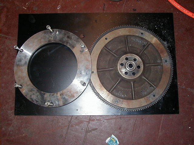

One of my options was to machine an "inertia" ring for the M110 flywheel. I would have made it out of steel and it would have fit on the flywheel like the ring gear - heat to expand and shrink to fit, may be a few screws to hold it on for insurance.

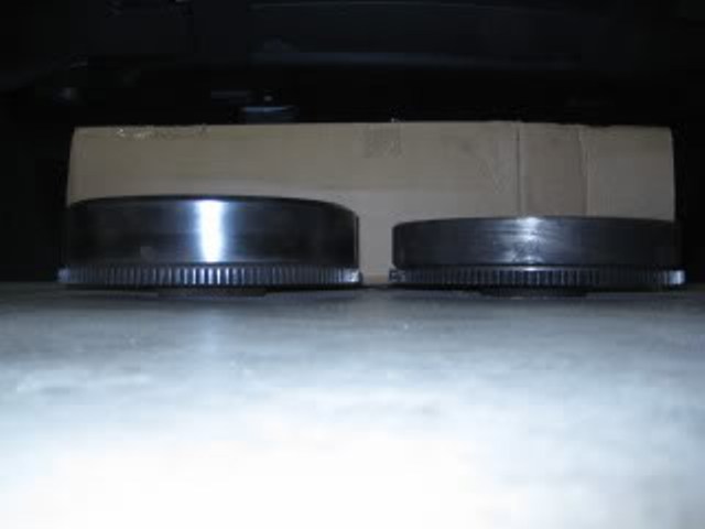

So 190 flywheels are not really a workable option. Winmutt now has the one I had so he can apply it usefully. Big Grin Aside from the completely different diameters, the hole patterns are too different, but are close enough that I feel like re drilling the hole pattern to fit the 61X crank might needlessly weaken the flywheel if you were to somehow overcome the starter issue.

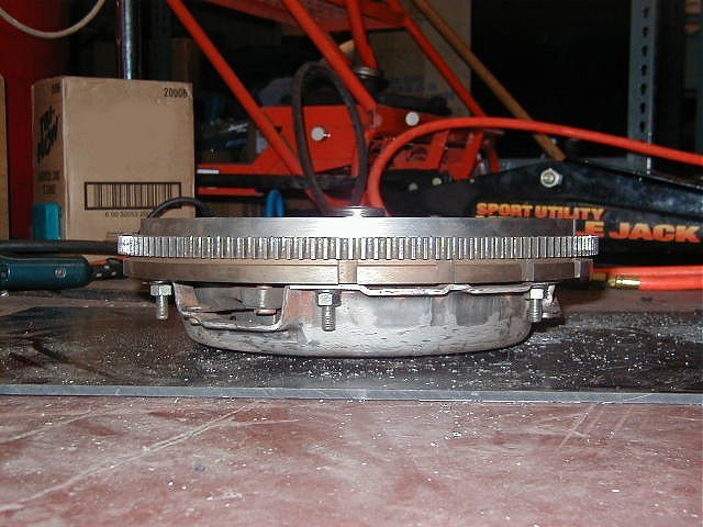

Still excited about making an inertial ring, here is a pirated pic from peachparts showing the two flywheels- makes me believe that this might be easily possible.
Does anyone know the actual depth difference between the 300D or 300GD and 240D flywheels?

10-14-2010, 10:08 AM #14
Which depth? The GD is thicker at the rim than the other two.

10-14-2010, 10:58 AM #15
Drop's talking about the distance from edge of lip to pressure plate mating surface I think, since the others should be the same.

10-18-2010, 06:01 PM #19
I can probably figure it out from the picture above and apply a ratio to the photo and the known measurements from my 240 flywheel. Of course, this means that I ALSO have to pull my tranny. Big Grin

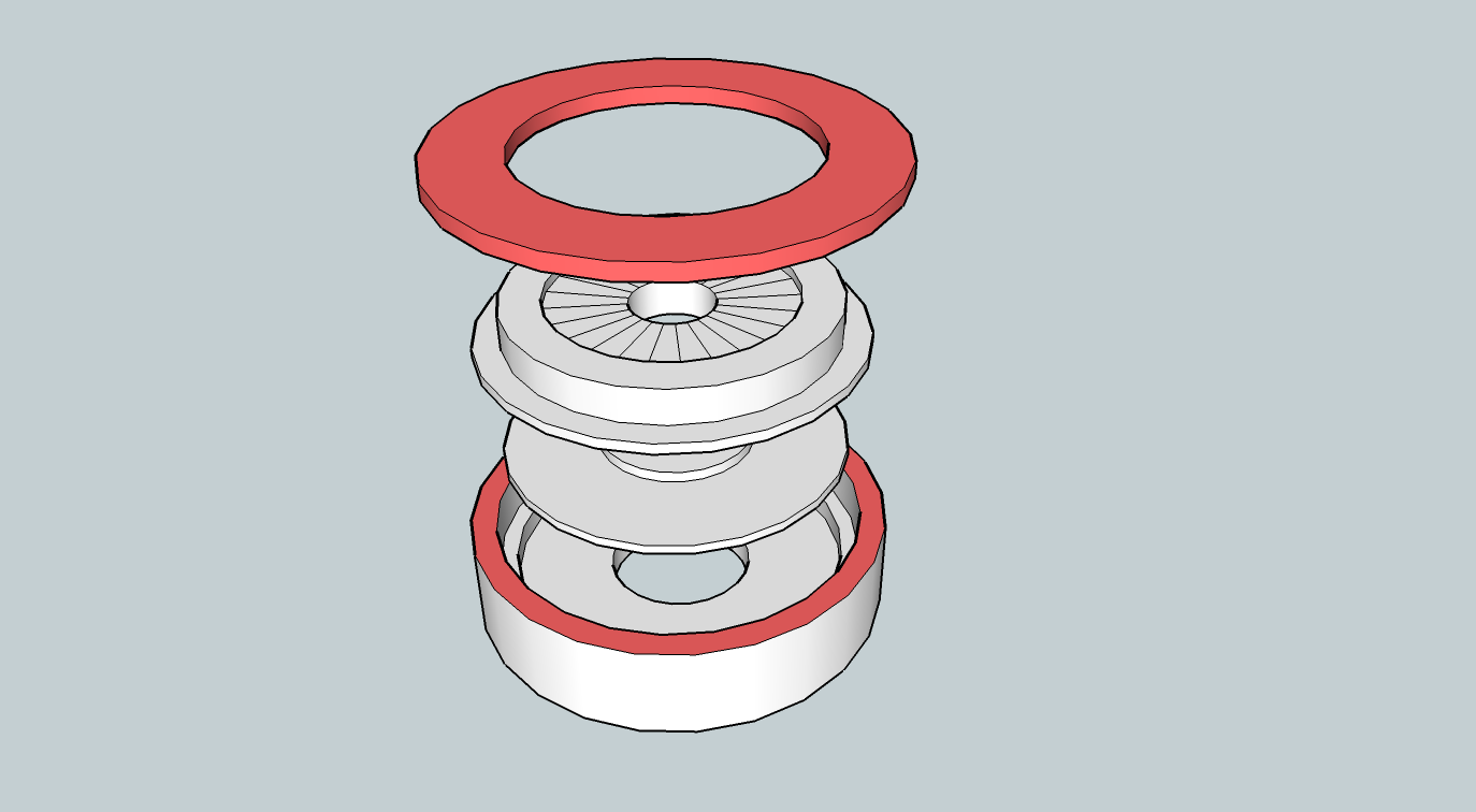

In drop’s generated diagram of a flywheel, he has an inertia ring placed over the clutch. This ring appears to be wide enough to be able to get the weight towards the center for quicker acceleration in RPMs and be heavy enough to reduce vibrations. I think this might be a better design then keeping the weight on the outside. The rotational inertia is definitely being reduced. But does that mean it vibrations will not be dampened?

Thats a really interesting video! So a theoretical inertial ring that looked more like this might eliminate sluggish acceleration as well as increase the overall weight and reduce vibration?
I feel like it could still work for both. I see what you are saying though, if the rotational mass were centered for the acceleration advantage, you might lose the vibration advantage of the outward weighted stock flywheel from the heavier applications
I don't know how thick you could make it towards the middle though, from this pic, I imagine a ring could be made that went all the way in towards the fingers, and had a step in it to make up for the pressure plate protruding out at the midway point. That would mean additional thickness would have to be made on the other side, which might not work with the fork.

10-19-2010, 11:36 AM #27
(10-18-2010, 07:01 PM)dropnosky
(10-18-2010, 06:55 PM)DeliveryValve I see the issue..... Well just thinking out loud!
Yeah, but thats an excellent idea! Theres got to be some way to center additional weight, or at least partially center it!
Maybe If there is enough room between block and flywheel, but mostly likely not enough. Then there might be need to research some other dense material. Perhaps some lead or brass weights pined to the steel plate?
This post was last modified: 10-19-2010, 11:41 AM by DeliveryValve.

10-19-2010, 05:24 PM #28
Hey derv, thats exactly how a merry go round works the one where you put your kids in and have them hold on to dear life.
I remember if i sat near the center holding on to the stem post it wasnt that bad.
But when I sat and held on to the outside rail, it was nearly impossible.
You could always add weights to the actual flywheel bolts, and welding material to the inside of the flywheel but outside of the flywheel bolt area. Of course need to get it balanced but a few steel pieces could make a difference if welded around.
