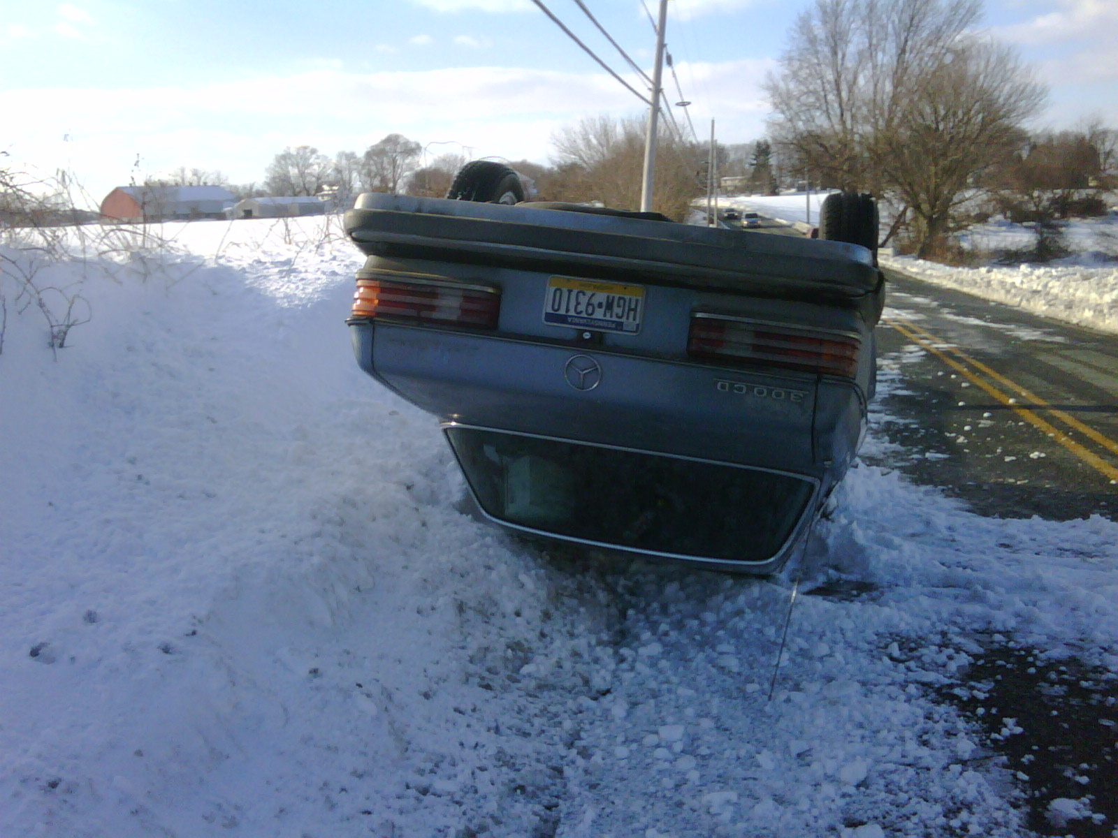

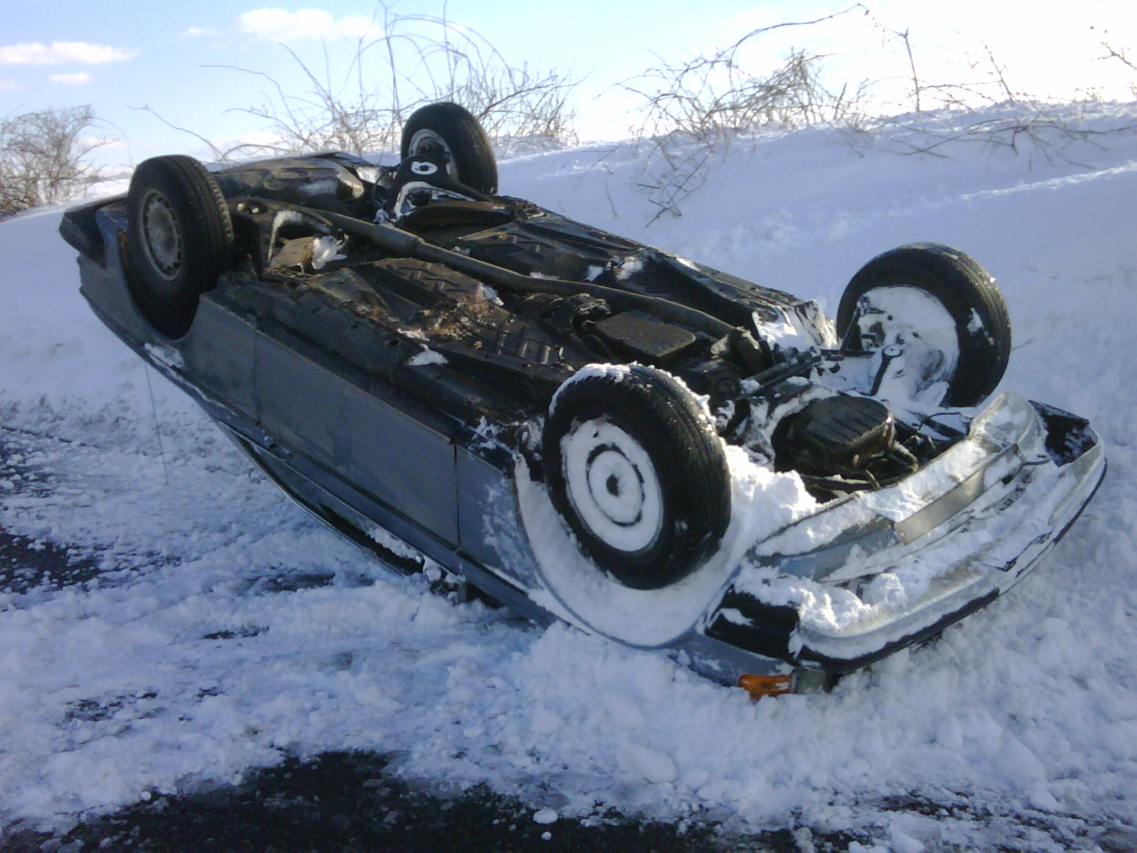

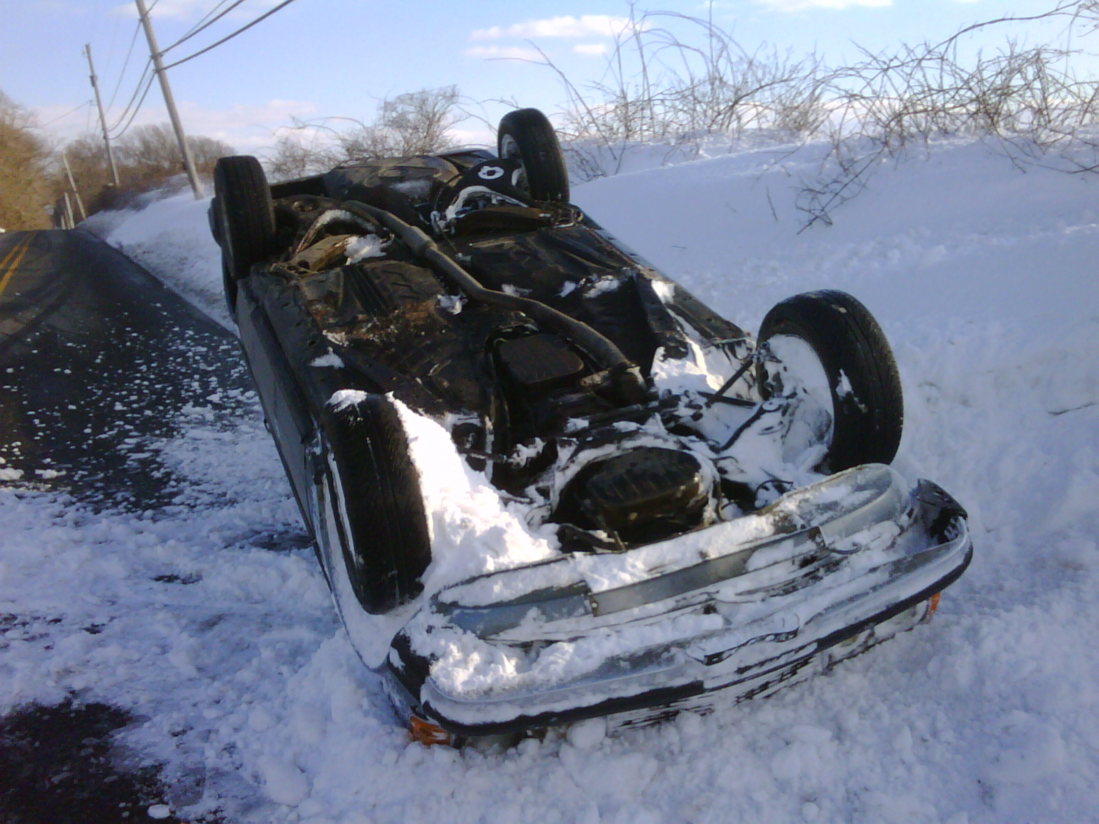

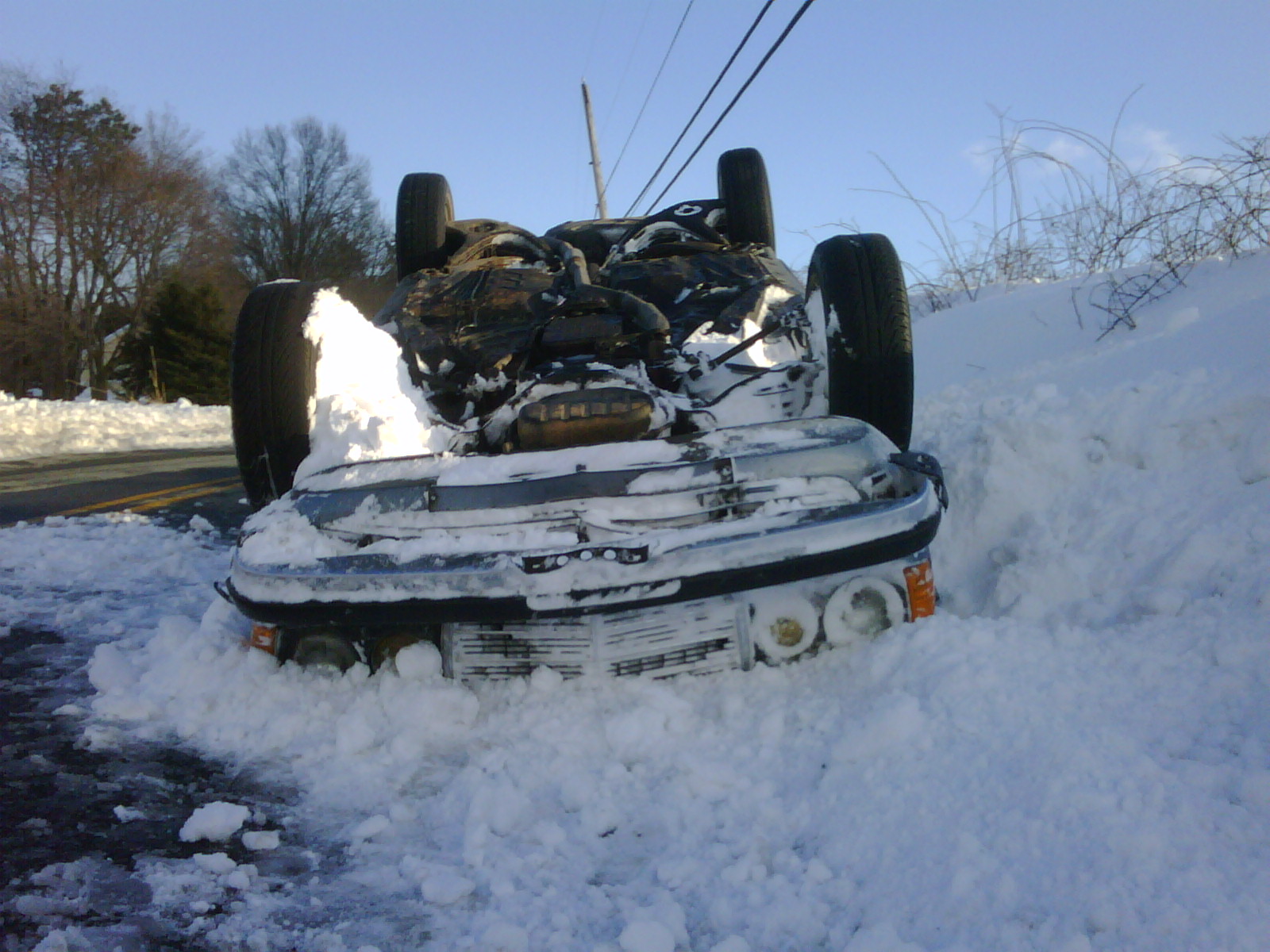

Alright guys, crazy shit here.. Im on the way to my girlfriends to pick her up for valentines day, you know typical wine 'n dine and a movie. Im going down a half-ass plowed country road and in my defensiveness to avoid an oncoming truck, I got sucked up onto a bank and my beloved Spike toppled helplessly onto his roof.
Now the car is fine, so far... Im going to replace the windshield and I got some nice dents to bang out.
KEY POINT: I turned the engine off AS SOON AS THE CAR WAS UPSIDE DOWN.
The roll was cushioned by the snow, I had my seatbelt on. Hell I don't think I so much as blinked during the whole shabang. The first thing I thought was "shit shit shit turn the engine off" followed by a quick "where's my smokes.."
A wrecker came out and flipped Spike onto his feet, and for the sake of letting traffic through took the car to his place. It was funny because this was the same guy who towed Spike from where I bought him, to my house.
So I met up with the tow company and gave it a shot, the car started up first crank (it was still 40*c on the gauge) It smoked like hell but it ran, transmission works fine, shifts good through all gears. Drove hope without so much as a hiccup
Now what do I get to look forward to in the future...? I'll upload some pics of the damage tomorrow..

Without seeing the damage pictures, I can only speculate on the engine. Regarding the heavy smoke, my concern would be that too much oil would of soaked past the piston rings and into the cylinders. There is a possibility of hydrolocking the engine and bending the rods. So now and into the future I would keep an eye on oil consumption. A bent rod will make a cylinder oval over time and an inordinary amount of consumption occur. So keep an eye on that.

I 2nd intensive front end check, and check on all fluid levels including tranny fluid, and diff oil, could have leaked out of the vents upside down like that for a little bit and be low.
Could oil have got up into the air filter as well upside down through the separator? Id look at the air filter as well, just in case it got saturated, or oil made it up in there.
