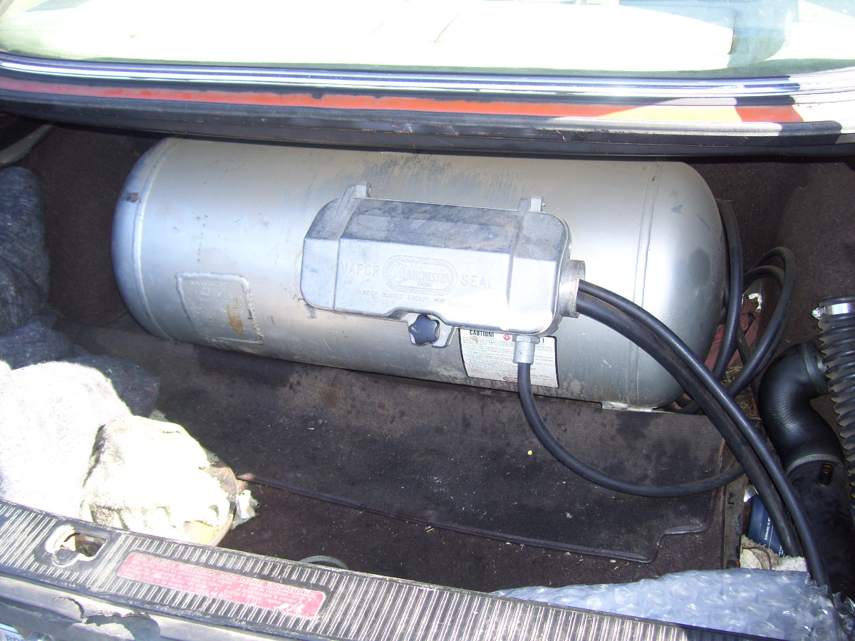

So here is the picture of the propane tank in the trunk. Takes up a bit of room but not too bad. Also a picture of the air intake and propane regulator. I tried to resize the pictures down to a reasonable size, but I don't have the technology for that. This is the smallest picture size the camera takes.

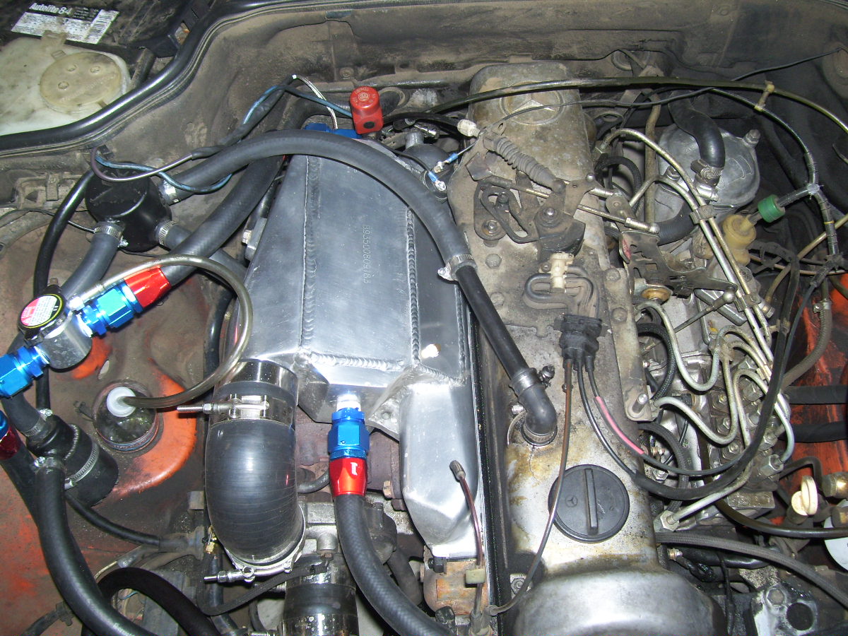

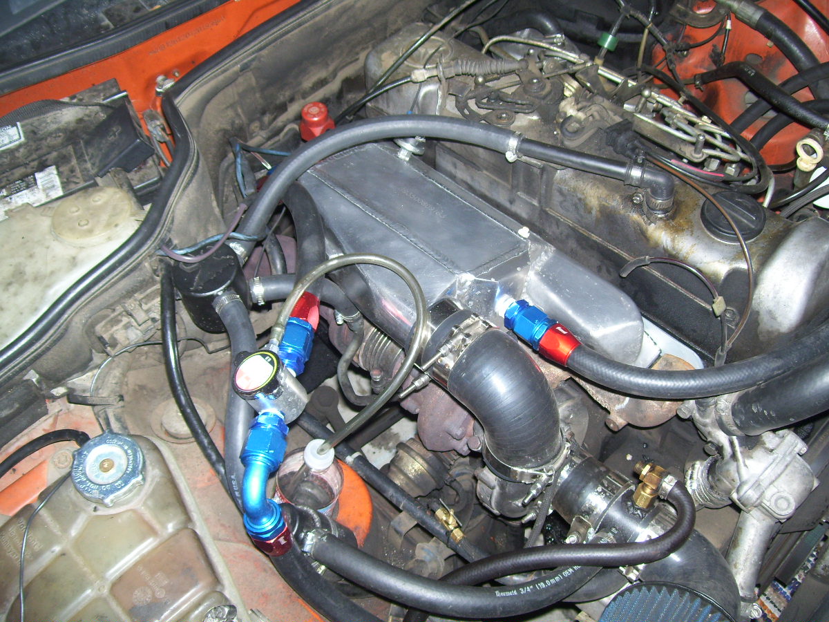

So I got my intercooler manifold on and water plumbed in.
Here is the heat exchanger. B&M Supercooler, biggest one they have. There is an electric fan pulling air through from the other side of the radiator.

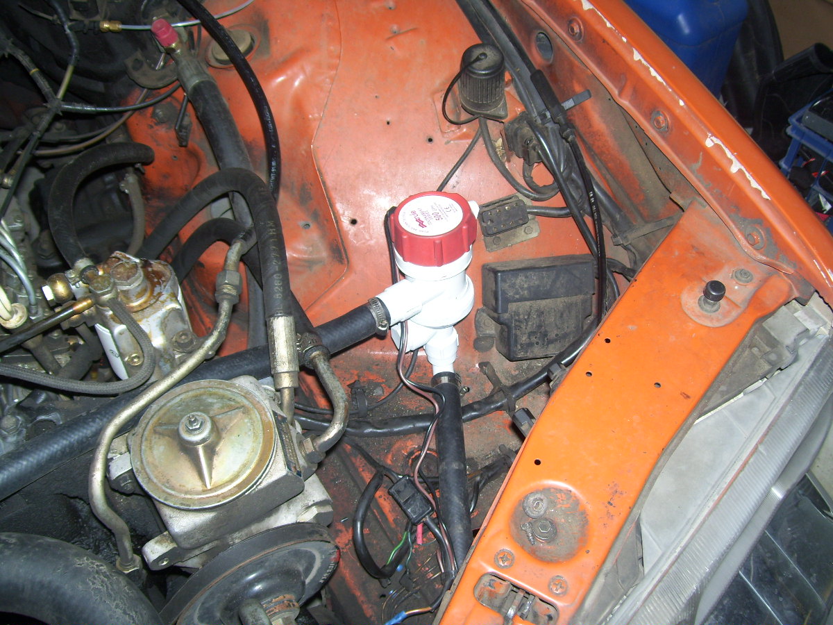

And the water pump. Currently a live bait well pump from Frozenboost. I had a MB aux water pump hooked in before, but it crapped out. A new pump is on the list of things to replace...

That water pump is an interesting solution! Whats it rated for? is it designed to operate continually? It may be that its an excellent choice for that application. The work on the manifold is excellent.
The "reservoir", if you're refering to the water bottle stuck in the spring opening is just the overflow. Currently, I haven't got the system hot enough to overflow and there isn't a reservoir in the system just yet. I'm thinking about building one to go under the right front headlight area. I'm going to hold off on that for a bit though, too much other stuff to get done.
Frozenboost.com sells that water pump. It's cheap, but I think it may be flowing too fast at the moment. I'd like to go back to the aux pump and see how it works. The most I got out of the aux pump I had set up was a "errrp" and nothin. The baitwell pump is ok for constant use, but I don't think it's rated to handle coolant mixtures.
A friend of my shop foreman did the manifold welding. I can mig steel, but have not tried aluminum yet. Also, he's a professional welder with access to all the cool toys that I don't have. I am pretty happy with his work. I spent HOURS getting the manifold up to its current shiney condition though. Lots of sanding by hand.
Very nice job! Bravo! Where did you get the piece for the radiator cap?
Thanks!
The radiator cap / remote filler is also from Frozenboost.com, along with the water pump and silicon bits. The machining is a bit off on the remote fill. The cap required "clearancing" on one of the ears to clear the overflow hose. Also, the cap is 'reverse threaded', backwards from the normal lefty-loosey standard cap. Not really anything big, just wierd things I noticed about it. The hose ends are 1/2 NPT, overflow is 1/8 NPT. I just checked their website, 25 bucks. They include the overflow hose end as well as two 3/4 hose ends; all made from aluminum. All the blue/red fittings and the black fittings on the heat exchanger are Summit brand.

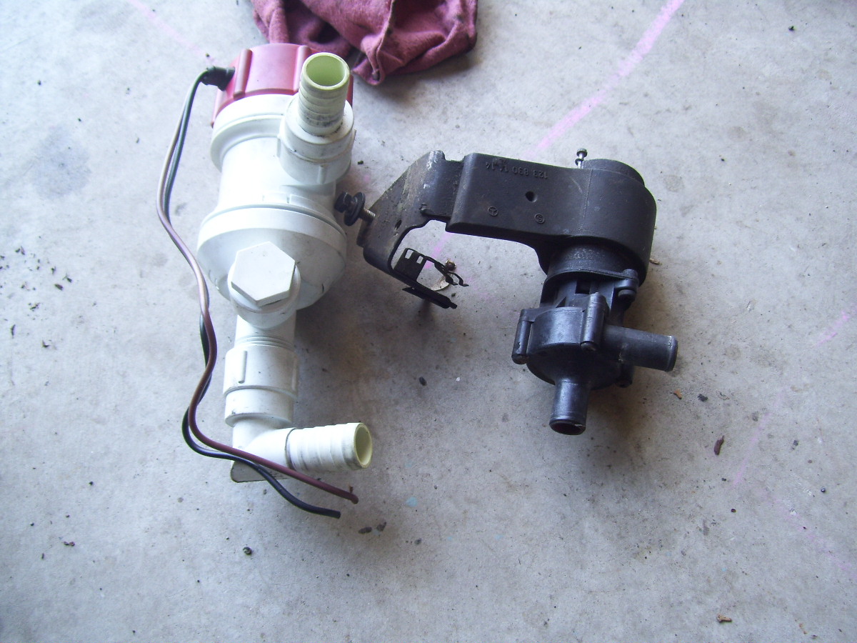

I swapped the baitwelll pump for an aux water pump a couple days ago and it's working much better. I was correct in my suspicions of it pumping too fast. The EGT's don't climb nearly as fast now, and are actually a bit lower on cruise as well. I wasn't in the car when it was being dynod this morning, but from the angle of the needle, it didn't seem to get over 650-700ish during the runs. I was off to the drivers side, about 4 feet or so away from the car.
(04-16-2010, 05:19 PM)Biohazard I swapped the baitwelll pump for an aux water pump a couple days ago and it's working much better. I was correct in my suspicions of it pumping too fast.
I sort of looked at water flow, with my radiator funnel in place on the remote fill. It seemed to be moving at a decent clip with the baitwell pump. I hadn't thought to look at it again with the aux pump on. Here is a side-by-side comparisant of the two pumps though. Kind of like looking at a stock K26 vs. a GT37.
The baitwell pump package showed some rediculous flow rate of something like 500 gph?!? But, that may have been freeflow. So I'm betting you are correct that it has a much higher flowrate without a pressure drop on the system, and vise versa with the aux pump. Like I had said earlier though, the baitwell pump is not rated for heat and coolant. Nor is it designed to have the correct flow amount through a heat exchanging unit. The aux water pump on the other hand, is designed for all of that.
Just switching pumps has dropped my EGT's by about 50F going up the big hill to my house when holding a steady 55mph. It also is noticably slower in getting to its peak and quicker cooling back down. I'm pretty sure I still need to plump in a reservoir of some type though.
Have you taken apart the bait pump to see what kind of pump it is?

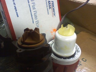

I hadn't, but I did last night. Here is a pic of the baitwell pump and my dead aux water pump side by side. The baitwell pump has 3/4" inlet and outlet, the aux pump has 5/8" inlet/outlet.
Interesting, I expected a little more difference between them.

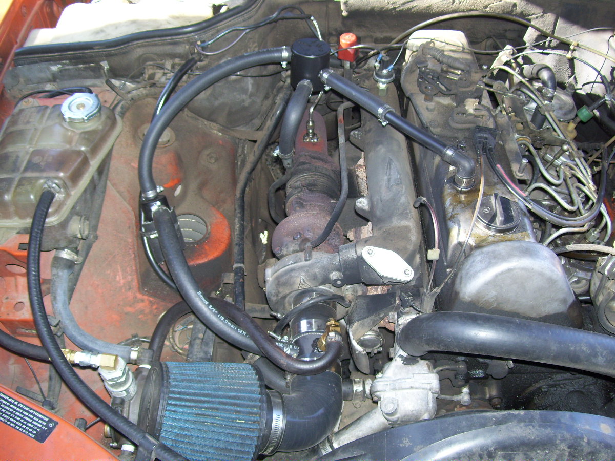

I'm either going to run the hose from the intake to atmosphere (to keep oil out of the intake), or run one of those seperators inline for the same reason.

Yeah I have an air/oil separator from Jegs but its only 3/8" fittings and doesnt flow enough.

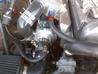

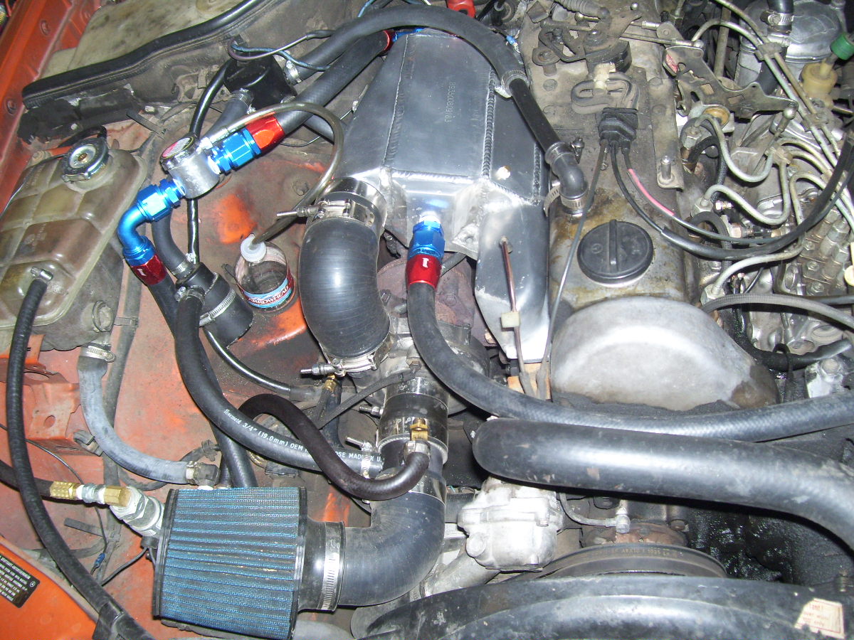

Here is a pic of the new turbo installed. I used a -4AN braided line for the oil feed; the stock line wouldn't clear the intercooler.
You can see near the the air filter the hose that is folded over and ziptied. I had more oil in the intake than I was expecting. That hose went to the pcv breather, it's now just vented to atmosphere. Proper fix to follow.
Your intercooler is super clean looking! I am on the fence about doing air to air, or air to water.... Where did you get your intercooler? and are you using the stock intake manifold or something different?
(06-14-2010, 11:21 AM)Biohazard Here is a pic of the new turbo installed. I used a -4AN braided line for the oil feed; the stock line wouldn't clear the intercooler.
The oil drain line was done the same as this thread:
http://www.superturbodiesel.com/std/show...t=T3+TURBO
Drilling the pan was a bit of work, but it's doable. The hard part was finding the huge drill bit needed.
The intake manifold is the stock turbo manifold that had a water/air intercooler welded in. I got the intercooler from Froozenboost.com, but you can get them online, or various places.
The lag with the T3/T4 is considerably more than the stock K26. Just cruising down the road at highway speeds, it's barely making boost (2-3psi) where the K26 would be about 4-5psi. I'm hoping the new 6.5mm elements that DervTuning is putting in will speed up the spooling and help with more boost. I don't have a boost controller; currently hitting about 10psi on full throttle with some fluctuation at higher rpm (needs that boost controler). If I wasn't upgrading the elements, I would stick with the stock K26 (or Garrett/Air Research) turbo. It's much smoother with the stock turbo and stock injection pump. Once my pump is done I'll be updating drivability, power, milage, etc.

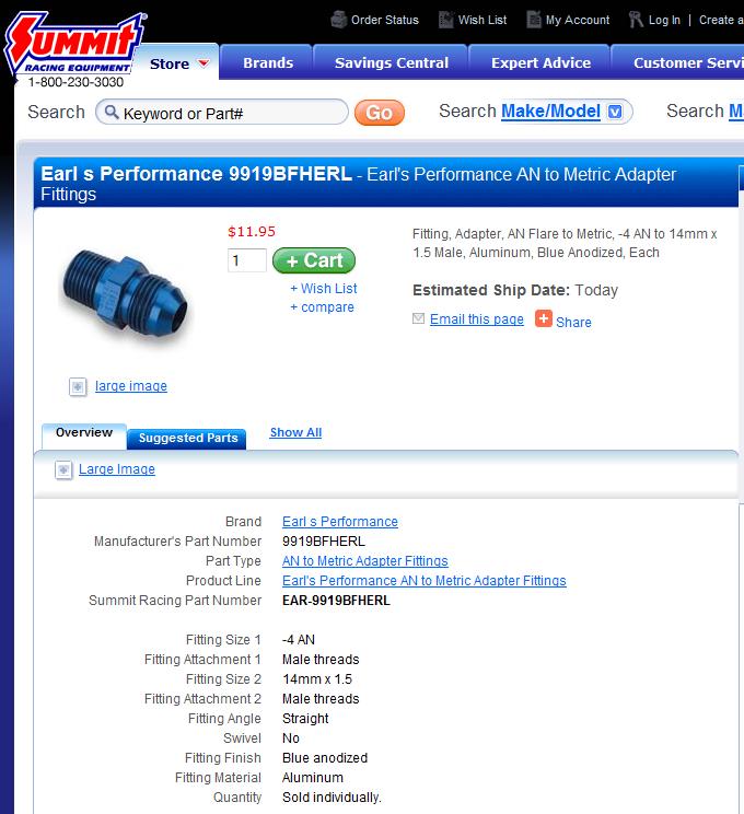

Sorry, I should clarify my question: I mean what have you done for the oil feed line to the turbo where it attaches to the oil filter housing? Its a banjo fitting back there right? Its kinda hard to see from the top of the motor. My hard line cracked right were it bends to bolt to the turbo, I pumped the whole crankcase out on the ground within a couple seconds. that's why I had it rebuilt with a 60 trim wheel in the compressor housing. I have it rigged right now but I want to use a -4 AN from the motor to the turbo since the new cartridge I got is threaded. I just don't know what type of fitting is needed to adapt the -4 to the motor...
When I did my 240d turbo I got a turbo oil filter housing and used a special an fitting that bolted right in
The parker store has a banjo bolt with a push-lok hose barb that will bolt on as well.
willbehere4u, that's exactly what I'm looking for!!!!!!!!!!
What threads are on the oil filter housing side? I'm thinking it is a M10x1.5 but that's my best guess without taking apart my daily driver and checking for sure. I am also assuming that's an o-ring fitting since is a straight thread right?
Forced, whats the Parker store?
I missunderstood your question. At the oil filter housing, I used a -4AN to 14 x 1.5 banjo bolt. It's not an o-ring fitting, it uses sealing washers.
Whooooooo I found one!
I cant remember the thread pitch but I was able to reuse the crush washer from the banjo bolt and something on the threads to seal it up? It's still working perfect

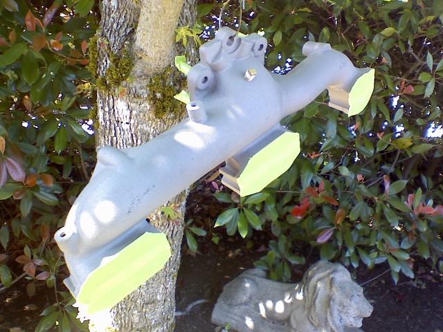

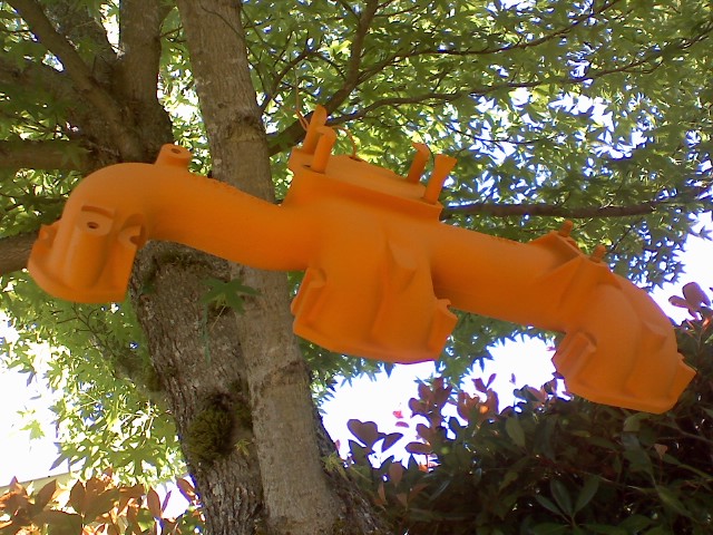

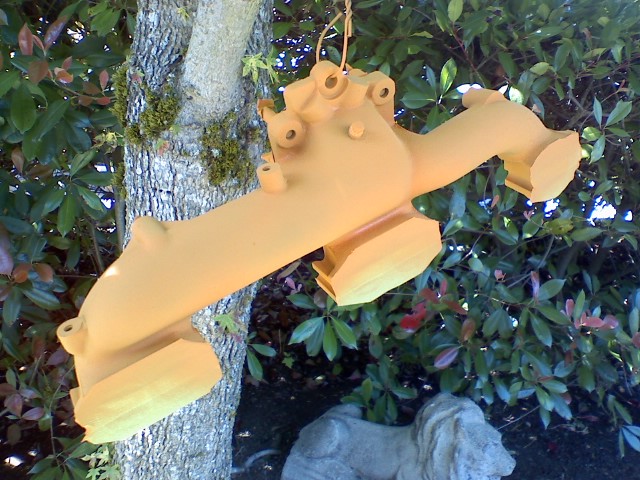

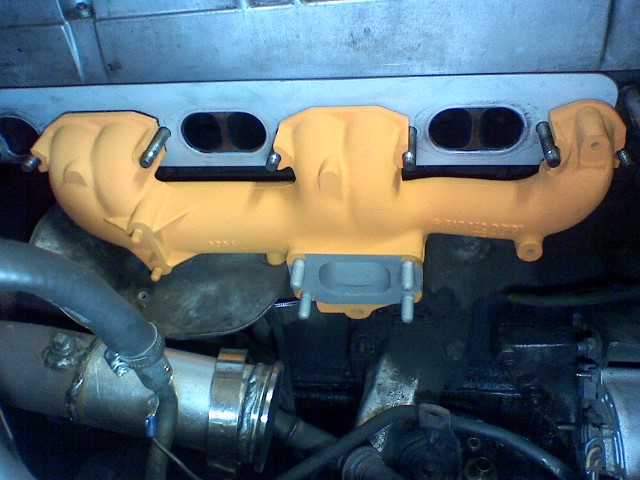

I also had a non-egr exhaust manifold. Did a light port-match on it and also drilled/tapped it for my egt gauge. It was in the down pipe, but now it in the manifold like it should be. The manifold had some rust, so I got it sand blasted inside and out.
Couldn't just leave the manifold bare cast iron, so VHT paint it is...
Figured I may as well make it look good and match the car.
You have no idea how effing frustrating it is to mount a freshly painted manifold without getting diesel oil/grease all over it....
Got it all buttoned up and followed the warmup/cooldown like it says on the can. It's high temp paint, but not like JetHot or ceramic coatings where it's designed to keep in the heat. I'll see how it holds up.

So either I did it wrong or I missed some residue on the manifold when I painted it. After driving it around, there are a couple spots that have turned yellowish. Meh, fits the name at least. Yellowish, orangish, looks like a Biohazardous waste.
I'll see about getting a pic in a day or two, I want to see if it changes color more.
