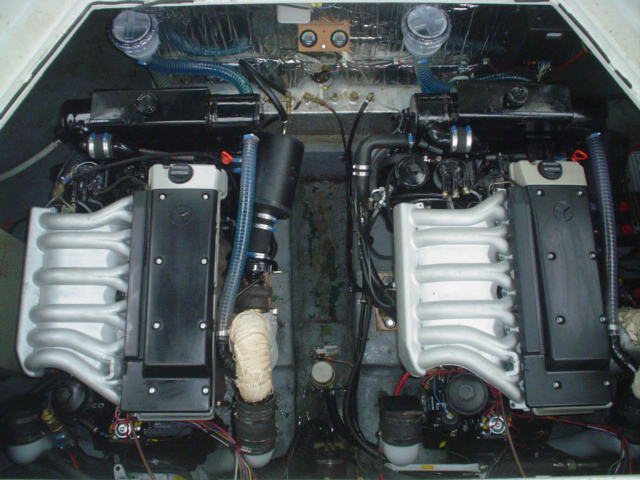

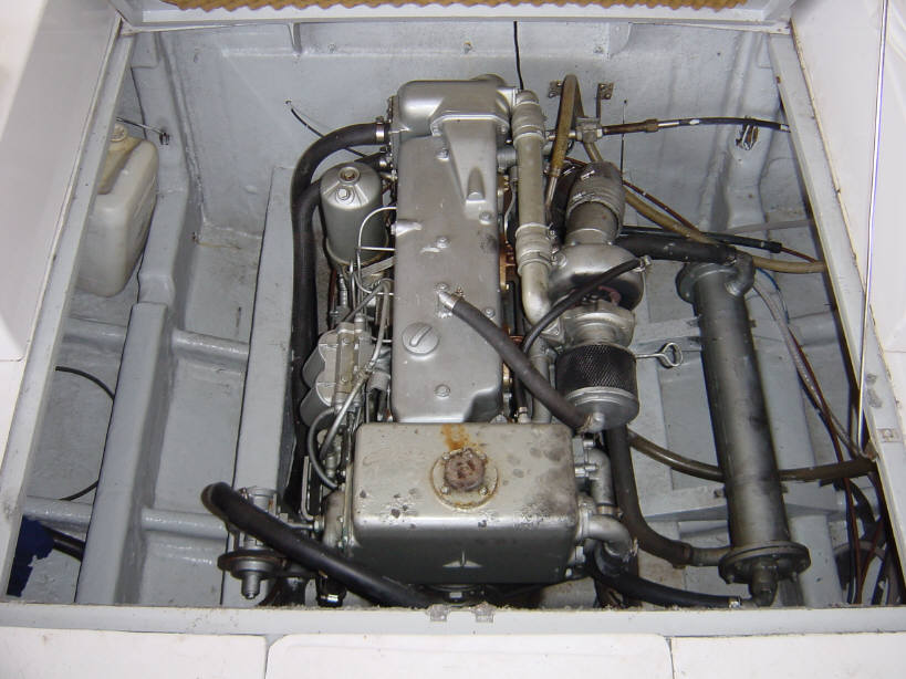

(04-26-2010, 01:10 AM)polarisrmk I have read many places and seen people mention doing this swap into a boat but no one has ever really ended up with anything (on a sterndrive that is). I have a boat and an engine so here we go.
There are many that have done it!

(04-26-2010, 01:17 AM)ForcedInduction
very nice ... any of those sterndrives? I am can't really tell from those photos.

The white OM617 powered boat uses a propeller shaft with an inboard gearbox. The others I don't know.
I don't see any reason why a stern drive couldn't work, its the same concept and mounting as an automotive transmission.
