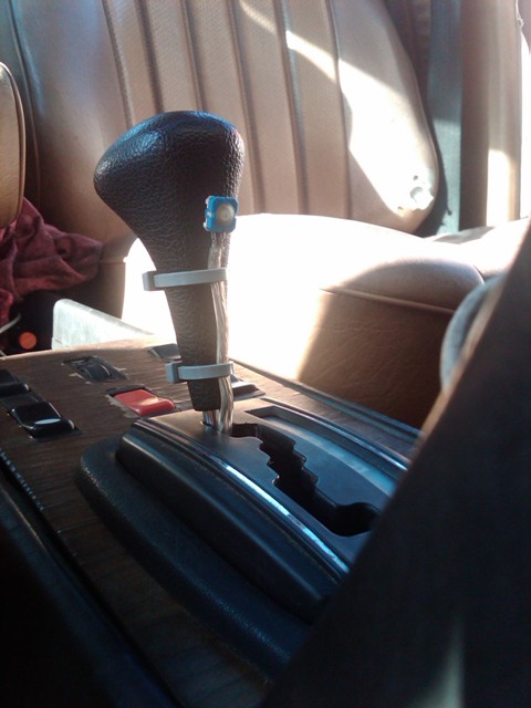

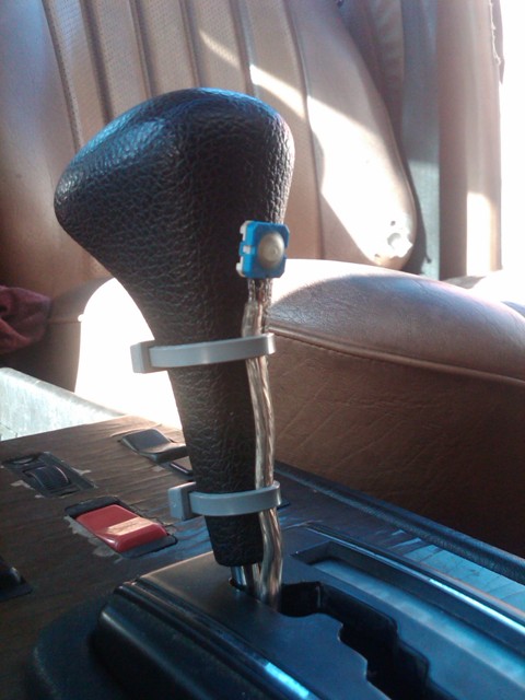

07-11-2010, 05:56 AM #21
No pics Forced?
I did the mod the day after also. It's not pretty but it works great. I'll put a pic up later today or tomorrow.
No pics Forced?

07-11-2010, 07:16 AM #23
Well I'll post one of my jerry rig in a couple hours to show ya how friggin sweet it is on my shifter
07-16-2010, 10:44 AM #24
A couple hours later....
Not pretty but it works sweet! I'll work on making it nice later....
