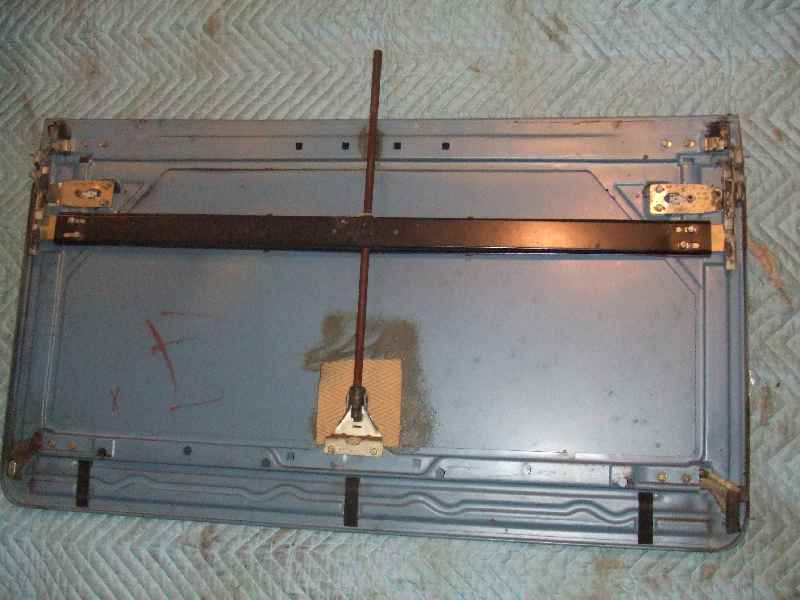

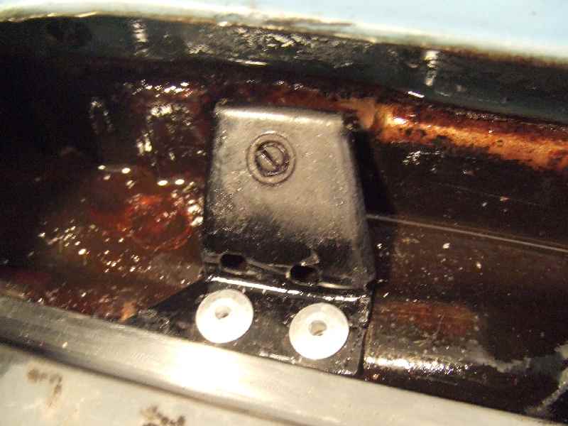

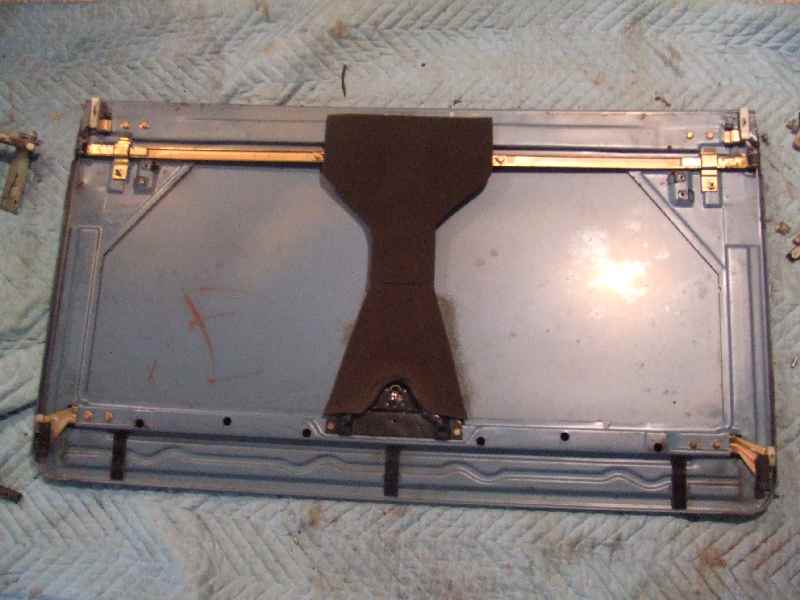

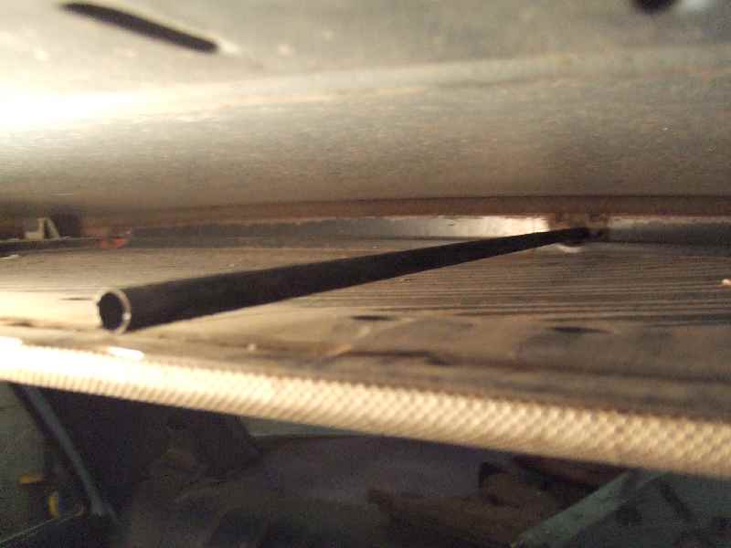

Its pretty easy, but its destructive and irreversible.
Get all the mechanism parts from the wagon.
On your car; Remove the motor and pull out the cable, break off the cable tube from inside the body, pull off the liner (friction clips), remove the sunroof, swap the hardware (or just use the entire panel if the wagon has the same body color as yours), install new ramps, put the assembly in the car and enjoy!
