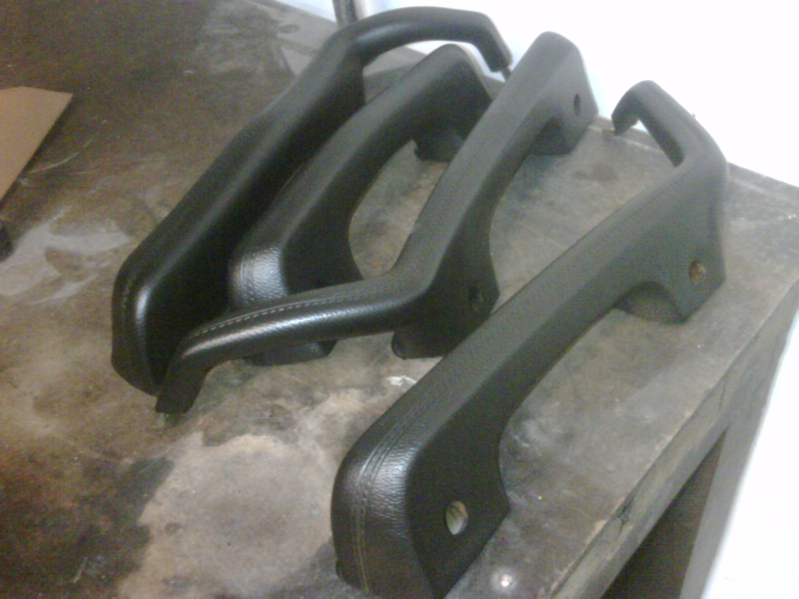

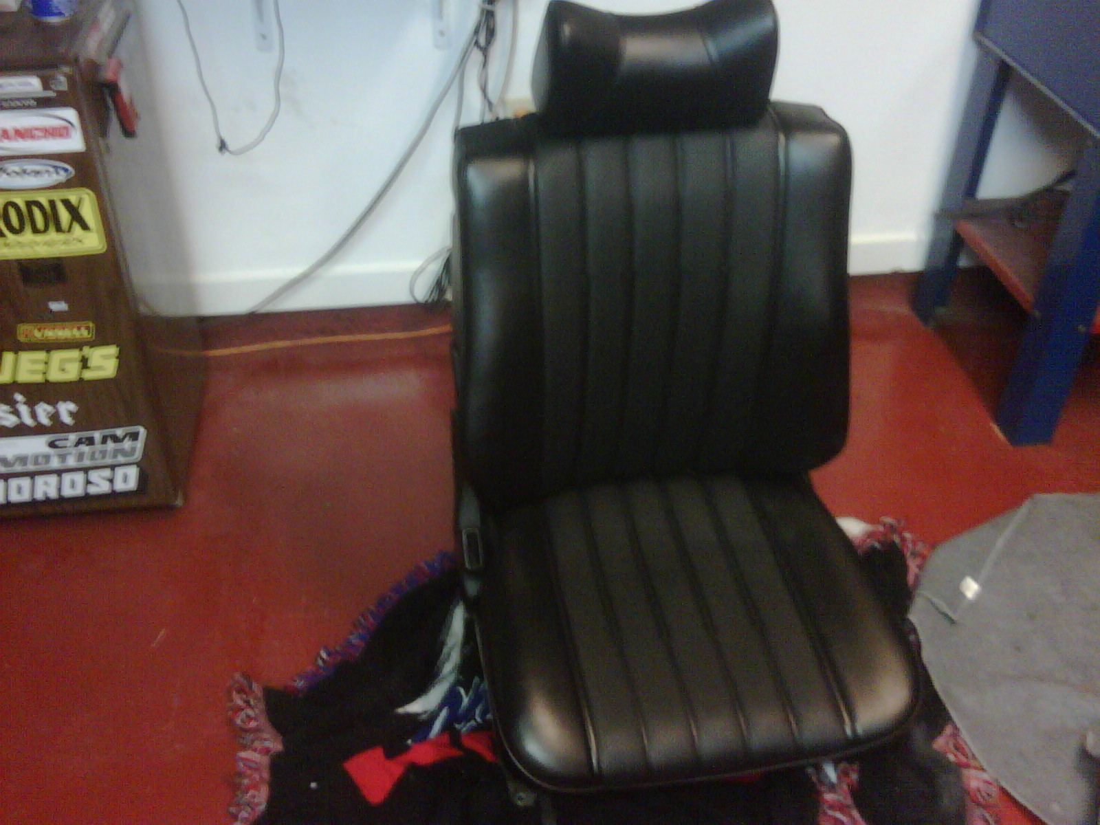

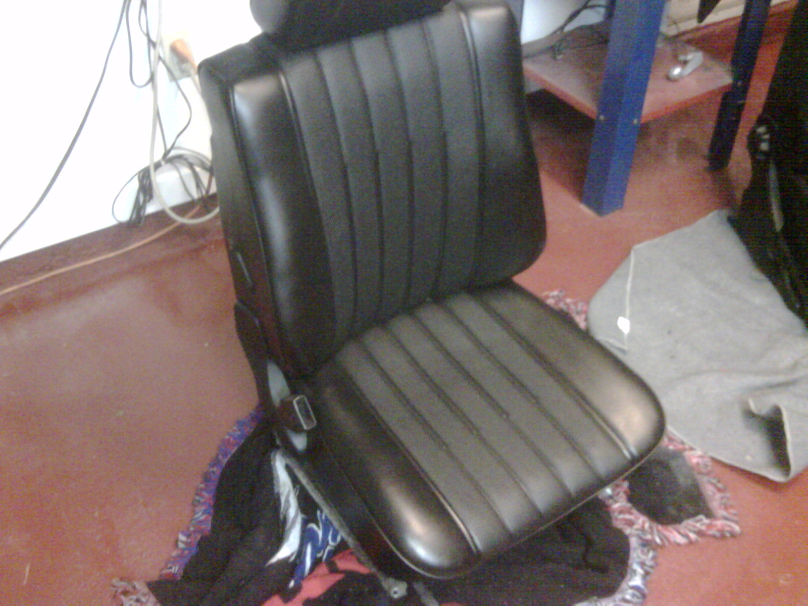

Got some interior dye from duplicolor for the 300d sedan, seems to be going pretty good so far and looks like it should hold up.

I will let you know, I did try scratching it off with my fingernail to see if it would come off and it would not budge. We will see how the southern heat treats it though.

My dad use to do this for a living for used car lots it works great if you clean all of the crap off your seat! He used a degreaser and scotch bright and then wiped them off with toluene or methyl Ethel alcohol very carefully to get all of the grease off!
