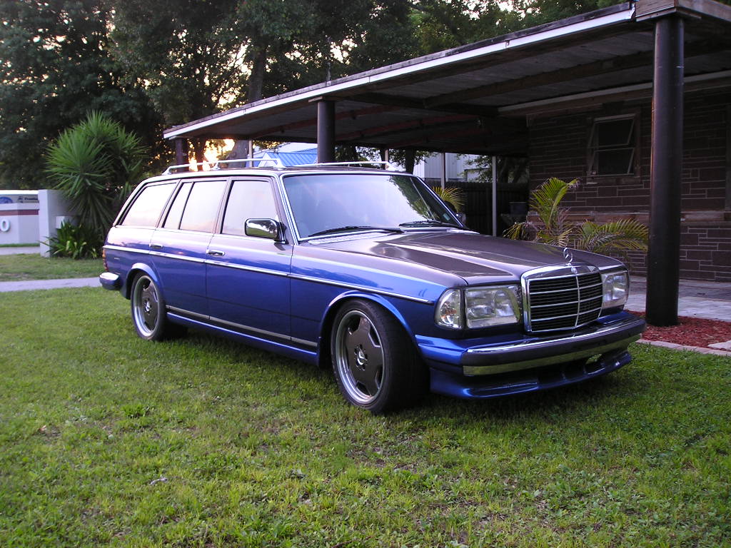

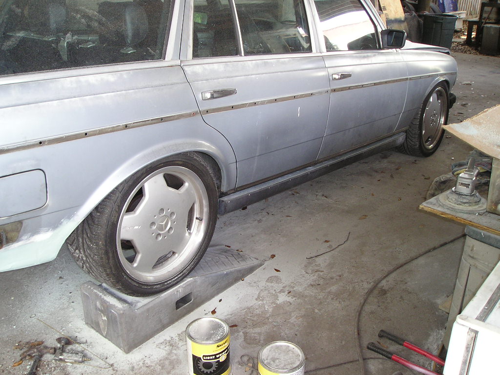

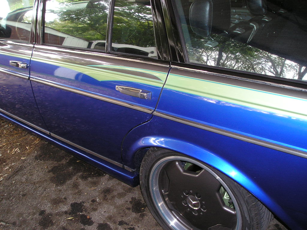

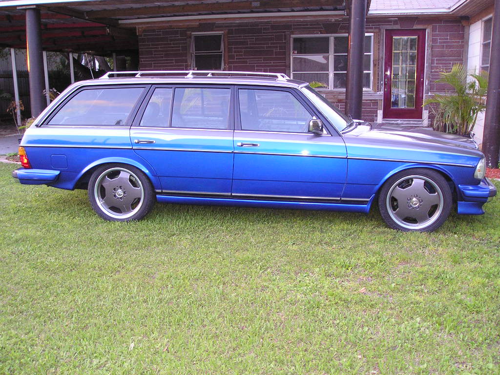

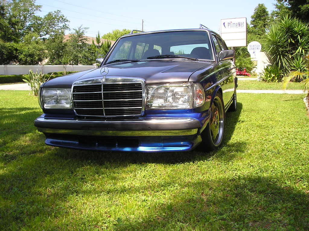

05-27-2010, 10:28 PM #8
(05-26-2010, 07:44 AM)MB TECH I know they made steelies as an option on the w210 4matic chassis and they were around 15x8 in size, might be worth pricing out some new ones if they are reasonable
I got these 18 inch AMG SL wheels from a 129 body to fit. Sledge hammer helped make it possible.

07-20-2010, 01:38 AM #9
(05-27-2010, 10:28 PM)Jettmar I got these 18 inch AMG SL wheels from a 129 body to fit. Sledge hammer helped make it possible.
What did you have to do to make these fit? These are the rims I want to put on my 300D but wasn't sure if there would be fitment issues or not. Seeing them on your car is inspiration.

07-21-2010, 06:21 PM #11
What air dam is that

07-23-2010, 10:59 PM #12
Air dam and side skirts are from an 80's Volvo (!?) Yeah I know, but I couldn't find a Benz one cheap and I like the look better anyway. Actually the side skirts are from a 90's 850 Volvo. Exact right length.
To make the front wheels fit required some stretching of the wheel arches to get the tires to clear. Forget doing it without ruining the paint. The whole lip and a bit above it must be bowed out somewhat. The chrome molding bows a bit now too. Not at all obvious unless compared to a 123 that's sitting right next to it.
The rear wheels have no clearance issues at all as far as the outer lip is concerned. Since these rims have a deeper backspacing compared to the 123, the clearance issue is with the inner fenderwell. I drove the car a bit with the big tires and found out where they rubbed and then bee-lined those areas with a big sledge hammer. It took a few attempts to get all the rubbing spots to go away but I got it now. A quarter inch spacer in there would probably save your having to beat the hell out of it. I preferred not to do it that way but would be easier.
