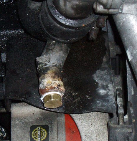

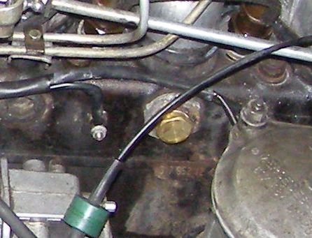

06-24-2010, 04:46 PM #24
The heater core should make no difference to cooling or venting, thats why the bypass passage is drilled in the thermostat housing to the upper radiator hose. Its not the highest point in the head and the flow is usually shut off completely during warm weather anyways.
I've had no water problems at all in my 300D without the HVAC system. It goes straight to 82*c and stays there.
Worst case, put a bleed cock there.
[Image: cock.jpg]
This post was last modified: 06-25-2010, 06:33 AM by ForcedInduction.
[Image: cock.jpg]

06-24-2010, 11:50 PM #25
Yes it was a press fit impeller.... I am thinking about putting a bleed cock to plug up the heater core fittings..... I always dread looking for the correct sizes of fittings for this motor cause people just stare at me and say "metric ? what? no we don't have anything metric thread" does anyone know the size of the fitting in the head and where the temp sensor screws in?

06-25-2010, 06:35 AM #26
I just pulled the plug and drilled/tapped it for 1/2NPT. The water pump I believe was tapped for 1/4NPT.
