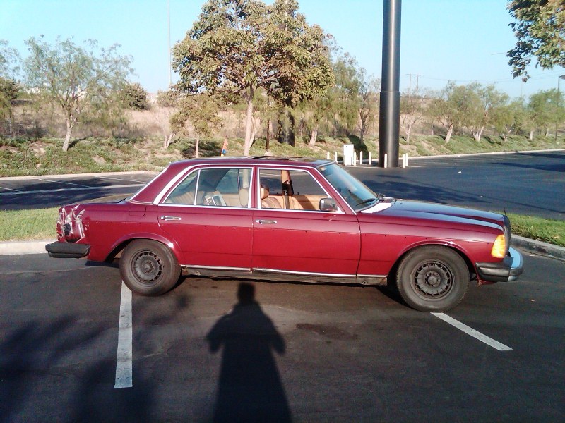

Well I've been here for a bit now and don't have a whole lot to show for it but I'll throw up some pics of "The Tank" anyway... 269K miles
She was very straight when I bought her with a fresh crap paint job haha. Probly a 15 footer.
She drove good and had more power than I expected... Only if I had known then what I know now lol.
Knew NOTHING about diesels other than the stuff I learned from the Ford FACT program I completed at UTI in Jan. 2008 (forgot every bit)

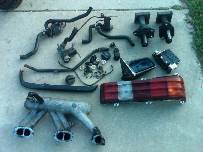

Cut off the Muffler

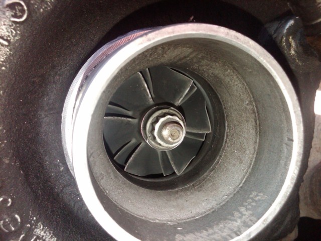

Oil line to turbo broke and emptied the oil on the ground within a couple seconds.
Rigged the oil feed to the turbo until I can properly fix it

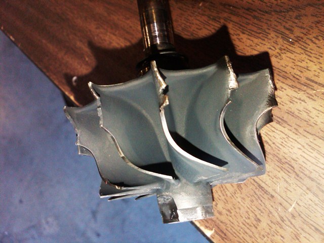

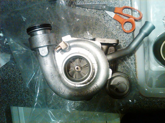

That f'ed up the turbo so that got rebuilt with a 60 trim comp wheel

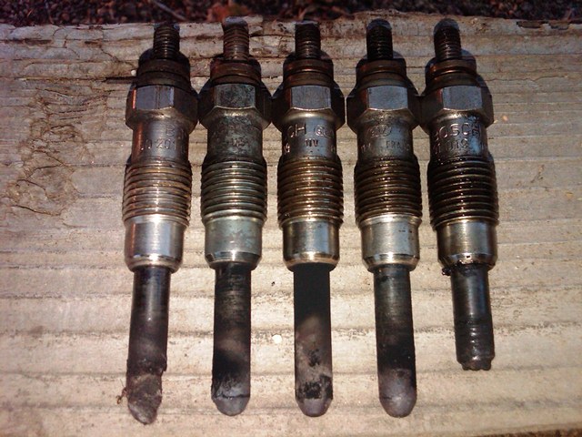

Installed new GP's. 2 Old ones were broken off!

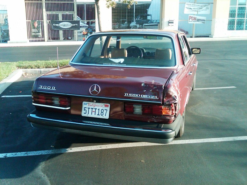

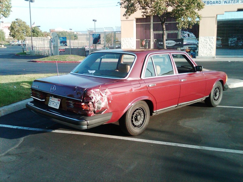

Got Rear ended
Pulled off the body trim because half of it was now falling off anyway

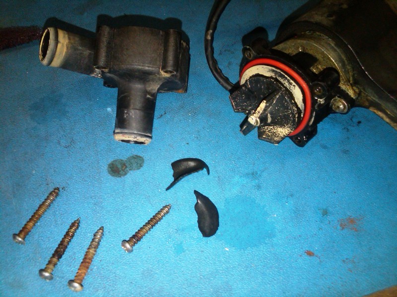

Fixed Burnt Aux water pump tracer on CCU

Right After it happened
Old Chewed up GP's
Fuct Turbine Wheel
Old Comp Wheel
New Comp Wheel

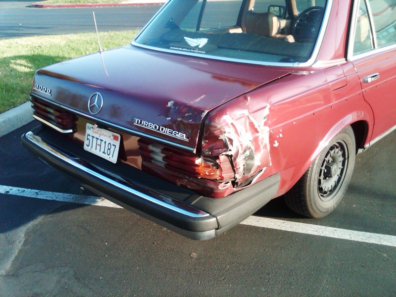

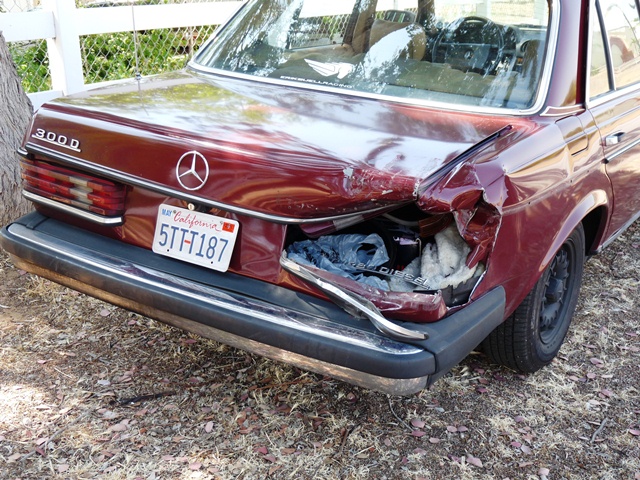

07-09-2010, 07:16 AM #2
That will buff right outBig Grin
07-09-2010, 10:11 AM #3

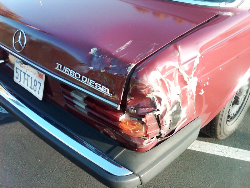

At least all the damage is to a panel you can get to the other side of easily, the whole trunk does not look bent down. Shame, cause thats a very nice straight car. You should go to a yard a cut the upper corner off of another car and get a trunk lid. What hit you? looks like what happens to a tin can when you stab it with a knife. Almost looks like a roll back truck backed into you.
07-09-2010, 10:53 AM #4
(07-09-2010, 07:16 AM)Rudolf_Diesel That will buff right outBig Grin
Yeah! that's what I was thinking! Tongue
(07-09-2010, 10:11 AM)dropnosky At least all the damage is to a panel you can get to the other side of easily, the whole trunk does not look bent down. Shame, cause thats a very nice straight car. You should go to a yard a cut the upper corner off of another car and get a trunk lid. What hit you? looks like what happens to a tin can when you stab it with a knife. Almost looks like a roll back truck backed into you.
Yeah good thing right? I plan on taking a dolly and hammer to it hopefully this weekend. the trunk is NOT bent down from what I can tell. I think I might try the corner transplant from another car. This car has really grown on me since I bought it and am putting the work into her. I am NO body man so it will be interesting. I hate body work actually haha. A '99 Ford ranger hit me. His bumper was at the perfect height obviously. There's really nothing there, no kind of reinforcement... It just caved in. Too bad that bastard didn't hit my bumper... those things are fucking gnarly tough! 3/8" thick just about!
This post was last modified: 07-09-2010, 11:16 AM by Captain America.

07-09-2010, 06:55 PM #5
very happy to see this. how's the interior? a good body shop that knows rust preventon could fix this for several thousand. or you can just tune the thing and wait for a better body to come along.
you don't want a[edit] "average" body shop to mess with the thing cause it would just rust to beat a dead horse
This post was last modified: 07-10-2010, 07:38 PM by rdirtycar.

07-10-2010, 03:19 PM #7
Thats a good pull out on that corner. Definitely something it can recover from.

07-10-2010, 07:33 PM #8

07-11-2010, 06:39 AM #10
The hood has been done to death on pickups. You should move the battery and run the exhaust through the side fender.
This post was last modified: 07-11-2010, 06:39 AM by ForcedInduction.
07-11-2010, 07:20 AM #11
Yeah I was kinda pondering that as well. So straight out the side, or out then up a couple inches? I would kinda like to see the smoke as it makes its exit...

07-11-2010, 05:02 PM #14
(07-09-2010, 10:53 AM)Captain America ....
Yeah good thing right? I plan on taking a dolly and hammer to it hopefully this weekend. the trunk is NOT bent down from what I can tell. I think I might try the corner transplant from another car. This car has really grown on me since I bought it and am putting the work into her. I am NO body man so it will be interesting. ...
Don't bother going the dolly and hammer route. That's a nice straight car, a donor piece would be much better. Even though your not a body man, that corner clip would be doable to mig on.
Go your to your local pick and pull with a fully charged Sawzall and the results would be much better.
(07-11-2010, 07:20 AM)Captain America ...So straight out the side, or out then up a couple inches? I would kinda like to see the smoke as it makes its exit...
Just go straight out from the bottom of the rockers. No cutting. Then put a big arse side mirror pointing downward so you can see the smoke. Big Grin

07-12-2010, 04:19 PM #16

07-12-2010, 09:12 PM #17

07-12-2010, 11:18 PM #18

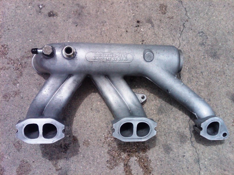

07-28-2010, 01:39 PM #36
Went to Pick-a-Part Sunday and got some goodies:
But I decided to ride some instead of working on the car:
Cleaned Up the Manifold:
Pulled some crap out of one of the pumps and WOW do they flow! empties a 5 gallon bucket in less than 15 seconds.
Got my parts from Bob:
