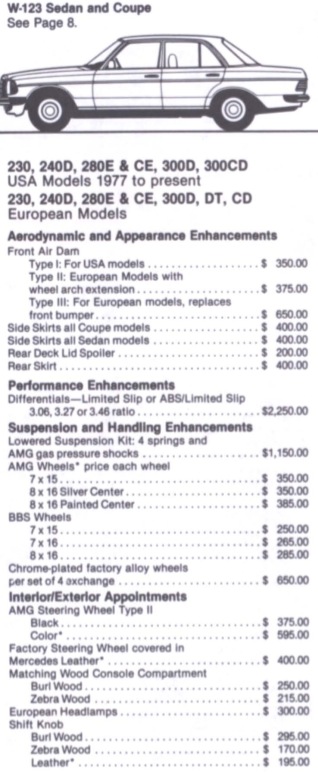

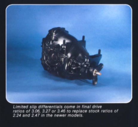

07-12-2009, 02:31 AM #7
Anyone got $2250?
This is from a 1984 USA brochure.
That 3.27 would be spot on perfect for a 4-speed manual.
This post was last modified: 07-12-2009, 02:32 AM by ForcedInduction.
Anyone got $2250?

07-16-2009, 05:01 PM #8
How interesting. Although I was flat-out wrong (supposing that the clutches aren't just worn out, or that the fluid is really old and thus the LSD additives are severely depleted) about having one on my car, supposedly these cars didn't come with a LSD from the factory.
Yeah, breaking my arm, I know...Big Grin
I'm going to look into taking the cover off of the diff to double check now that I know this. I thought it odd that a 'high content' manufacturer like Mercedes, selling RWD cars in snow prone market areas, wouldn't have a LSD option in the time before traction control. If a blundering, bloated company like GM had limited slips in their comparatively primitive cars, it makes little sense that an engineering icon like MB would overlook such a thing. Volvo, with their 'wannabe 123' 240DL cars had this option and they weren't exactly in the same league as Mercedes.
Anyone paying a premium price (~22k in 1982 dollars) for one of the slowest cars going, if they realized the benefit in the snow of this option, likely wouldn't have balked at it as much as we, who've probably paid less than the LSD option cost for the whole car - by a factor of three, in my case. In Europe, this might have been more of a 'Joe' car, but in America, it was quite premium, socially probably the equivalent of a Prius today - a 'green' status symbol. "I spent damn good money to lessen my environmental impact", yadda yadda yadda.
In other words, if you were well to do, and wanted a high-miler car, you bought a 240D. More 'common folk' types would have made do with a Honda or a Rabbit. (I will say this - a 240D is a goddamned ROCKET in comparison to a Diesel Rabbit!). Just because it seems expensive (because it is) doesn't mean no one would check that option box. The tags making for easy ID'ing of these diffs might have been removed for a fluid change and never replaced, broken off, etc. Happens over the course of decades.
Also, if one recalls my thread, I still find it odd that this fairly conventional looking differential somehow manages to spin both tires in the dirt, whereas no other car I've owned - American, Swedish, Japanese, or German - would do so with an open diff. Always one tire spinning, even on ice. It's left quite a few of my friends, one an aerospace engineer, scratching their heads over it. I suppose if ALL of the MB diffs do that, it's one thing - anyone care to experiment?
I recall from my time at the 9C1 Caprice forum that, after years of police use and a few as a civilian car before landing in the hands of drag racers, they'd complain that the stock LSD rear wasn't working very well, if at all. Turns out that GM makes a very good additive formula for clutch LSDs that made these old, 200k+ mile boats hook with 300+ hp (some were running 383 stroker LT1s, which meant even more power). No other mods required - the clutches were simply slipping so much that the LS action wasn't noticeable. Maybe I'm not such a dolt after all.
Its possible that there's quite a few of these diffs out there unrecognized - how many people were really picking a W123 for a hot-rod or sports sedan before a few years ago? Not all that many, too expensive and BMW is typically the choice for such things (not to mention cars like the XR4TI). Possible, as in a theory, I still don't know for sure. I'm somewhat optimistic, though.
