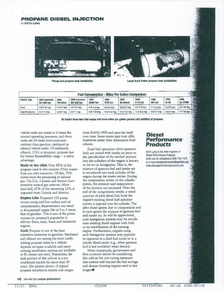

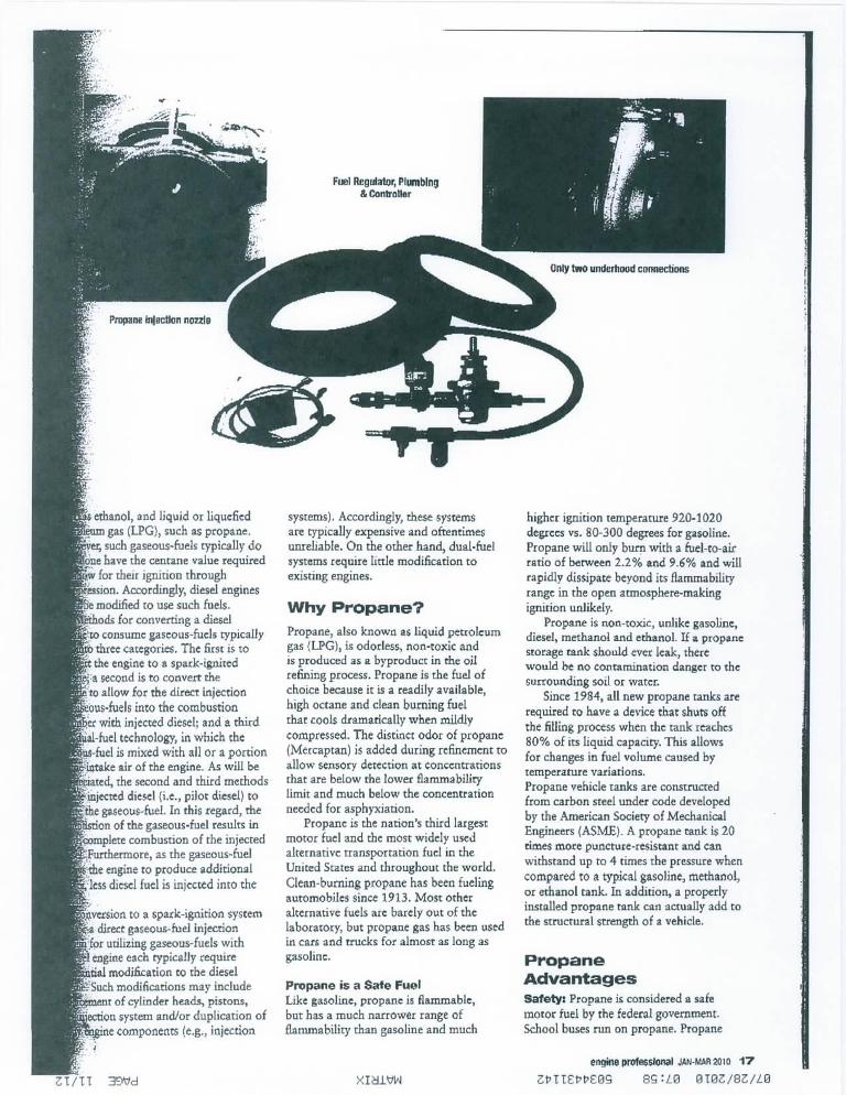

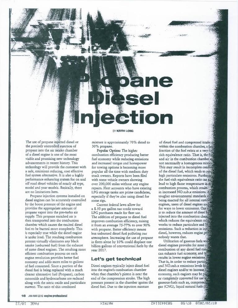

Posted for mk216v....

IDI + propane + bad luck == boom

Yep, that glowing ball inside the prechamber makes a great preignition source.

I've been more than happy with my propane setup so far. No boom yet, thank God, but I don't have it cranked up either. It gives about 10-15ish horse at full throttle, but it gives better milage too by about 10% or so. I'm not sure if anything is broken from propane yet, but I'll find that out when I swap over my cylinder head after Bonneville. Cool
