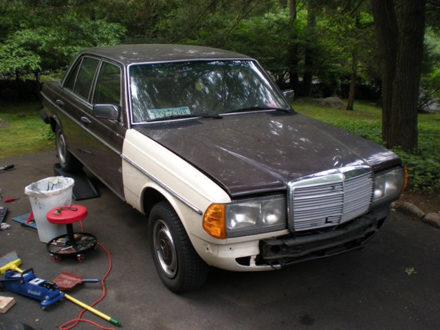

Since ive decided to put a turbo on this car, in anticipation of getting that done, a thread for it on superturbodiesel. Big Grin
So far, the only mods to the car other than extensive rust repair in this thread- http://www.superturbodiesel.com/std/emer...-1276.html
are a W201 5-speed swap discussed in this thread- http://www.superturbodiesel.com/std/how-...t-965.html
It started out as a basic automatic 240 with a bad trans.
Ready to be installed are a 3.46 rear end, a bull bar, and soon the turbo setup off of one of my parts engines.

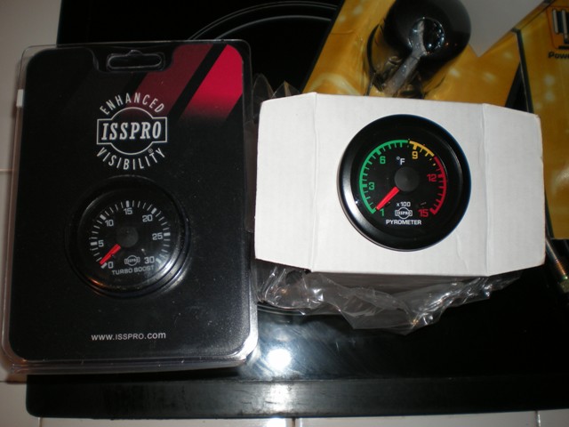

Also I am working on installing a tach, and will need a boot gauge and EGT gauge.
as it stands in its current state, looks ok from far away, but it won't win any beauty contests-
what it looked like earlier, needed new fenders and a bunch of other stuff

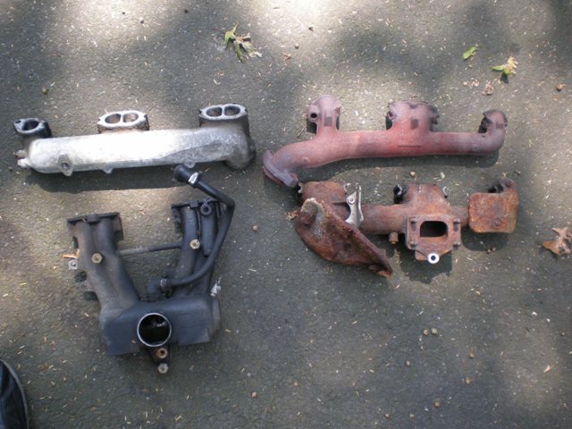

passenger view from the back seat. For some reason, no one likes riding back there on the highway or in the rain for gods sake. I usually put down some cardboard, what more could they want?

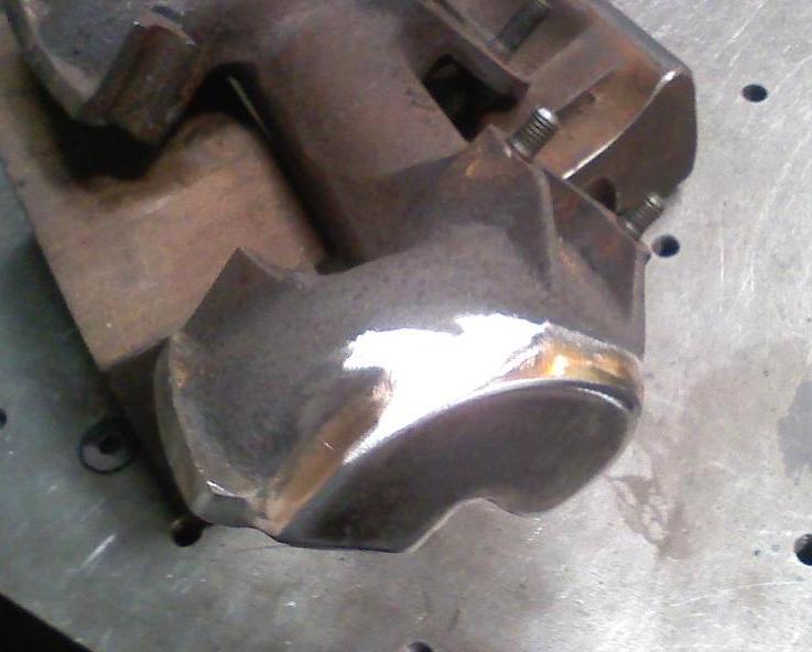

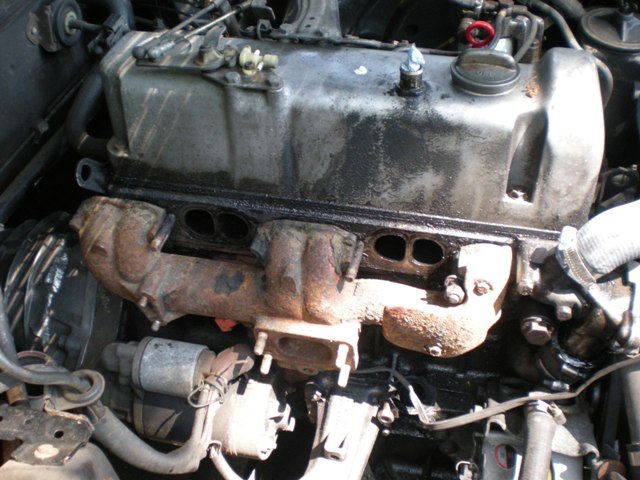

First brick wall- Turbo exhaust manifold, the 4th/5th cylinder twin port is going to be a bear to resolve. Intake should be no problem, I can just cut the last cylinder off and weld it shut.
I guess the question is do I want to mess around with welding on the cast iron manifold? anyone have any positive first hand experience with a welded cast iron component?

(08-05-2010, 03:53 PM)dropnosky ....
I asked Rudolf_Diesel this very question a couple days ago. He told me that he braze welded an exhaust manifold before with no problems.

08-06-2010, 12:18 PM #10
I've heard if you heat it up to like 250* in an oven then weld it dose alright
08-06-2010, 01:57 PM #11

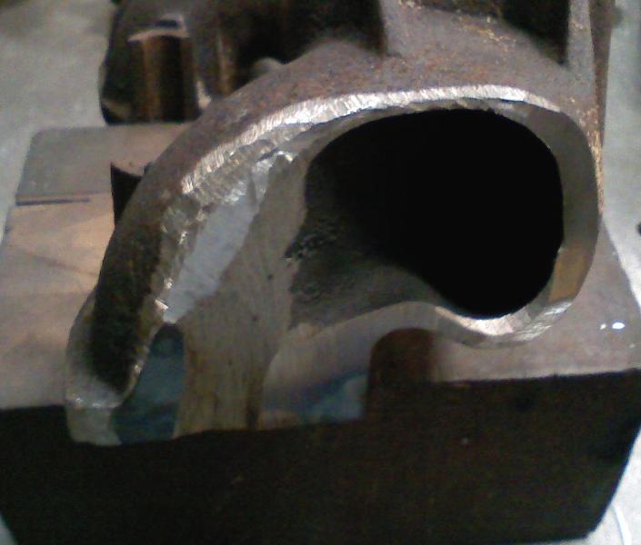

It should be fine to weld as long as there is not a tensile load on the object welded - then there should no issue with it lasting.
Brazing is actually stronger than the parent material. I have repaired cast iron gears by brazing new teeth and have not had an issue.
I also repaired my old Rajay turbo housing (Corvair) that was cracked. I drilled a hole on each end of the crack to stop its progression then ground out a groove in the crack and brazed it up.
You let it cool naturally and give it a few small hits with a ball peen to relieve stress as it cools.

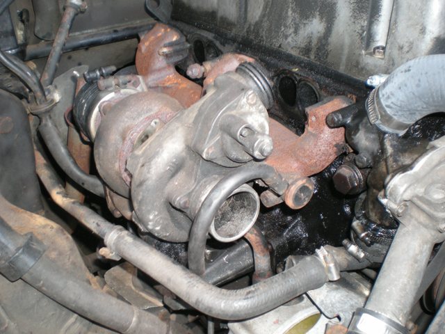

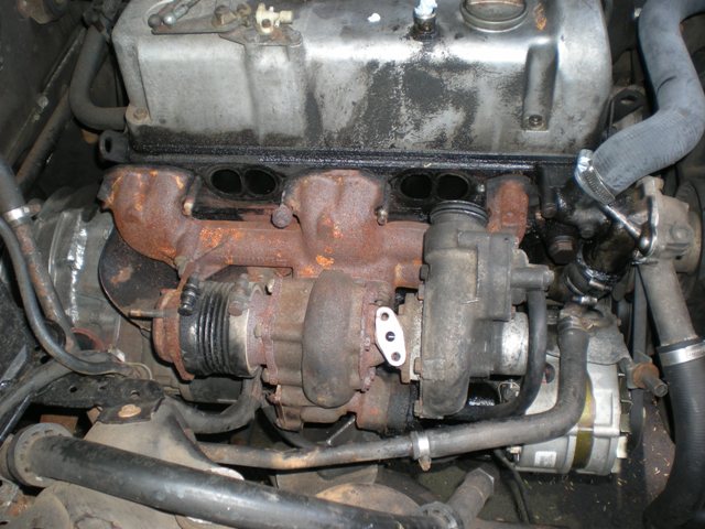

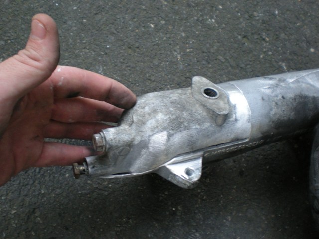

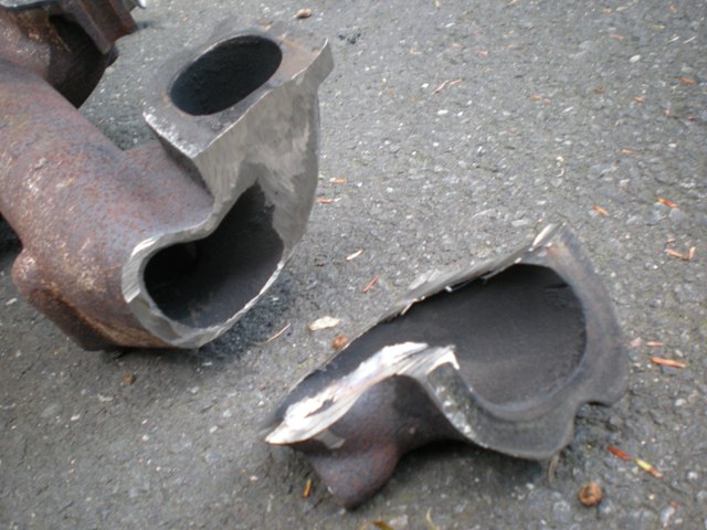

you guys have emboldened me with the exhaust manifold welding. here are some pics

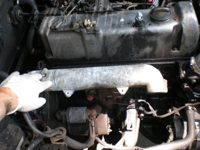

The turbo exhaust and intake are off of a 116 SD I think. same as the later ones, just minus the EGR, and some heat shield provisions
the intake will work just fine cut off about here. I may cut it sort of oddly to retain the ALDA port on the end-

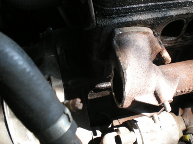

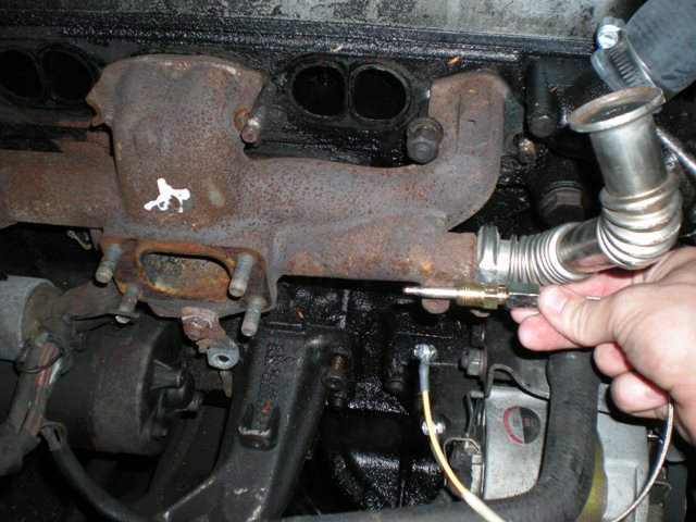

I was initally concerned about the exhaust proximity to the starter here-
But a turbo does fit in there, it is about 1/3 to 1/2 of an inch between the heat shield and starter solenoid. Ok? I think the rubber boot may be melted, but it may be fine. I wonder if I can reclock the starter to get the solenoid down towards the passenger side?
Since welding on the manifold seems to be possible done properly, I took one of my extra manifolds and cut it up to see. I won't be able to do it properly with my fischer price welder though, I have to find someone who will do it. Looks like it will work, but I have to grind it in further and get something in there for that final off center manifold stud.

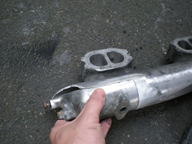

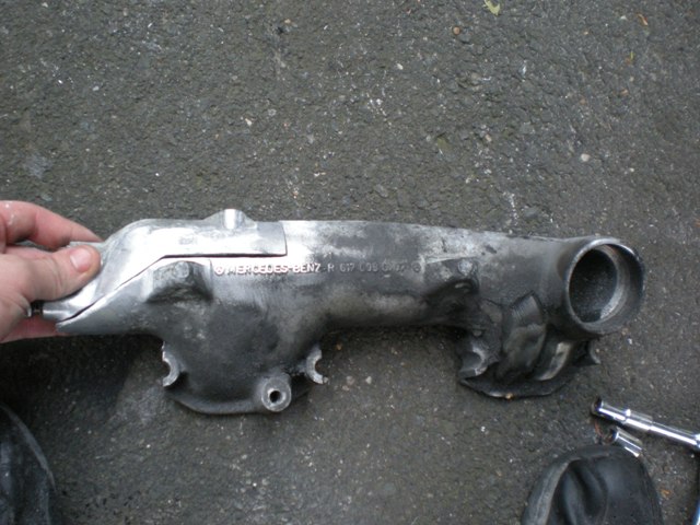

Heres how I cut the intake manifold. I decided that I wanted all the port connections on it including the the air filter housing brackets, so I cut it in this weird way. There is only one half moon gap on the back side that needs to be filled in with some aluminum plate, otherwise the rest can just be welded together.
and here you can see the small gap-

08-08-2010, 06:32 PM #18
Wow! nice work on the cutting! The manifold especially, how you are able to keep all the ports ..... Sweet!

08-08-2010, 09:36 PM #20
Looks pretty sweet. That intake is going to turn out really nice.
But you shouldn't have cut up the non-EGR manifolds, those are worth quite a bit of money. I sold two to different people in France for $140 each!
08-08-2010, 11:40 PM #21
(08-08-2010, 09:36 PM)ForcedInduction Looks pretty sweet. That intake is going to turn out really nice.
Well, I only cut up one so far, I see your point though. I think I wil leave the non EGR exhaust manifold alone and cut up an EGR version, the later EGR one I have has more bolt holes for heat shields anyway and is in better condition.

08-11-2010, 07:32 PM #27
got my gauges! I like isspro, especially the color coded EGT
Also, I am obsessed with attaching the EGT probe in where the EGR was cause it just seems like a tidy thing to do. How much of a EGT reading would I lose do you think putting the probe off of cylinder one like this?
(08-09-2010, 01:24 PM)willbhere4u Great job Dropnosky Can you make me one! That will be sexy when its done! Rudolf your a stand up guy!!!!
All I am doing is wielding a hack saw and angle grinder! Lets see what happens after I shamelessly beg, borrow, and steal welding services from people such as Rudolf-diesel and my local welding guy who is old and cantankerous!
This post was last modified: 08-11-2010, 07:43 PM by JB3.
08-11-2010, 08:06 PM #28
(08-11-2010, 07:32 PM)dropnosky ....
[Image: attachment.php?aid=3376]
In my opinion it would not be good to put an EGT probe there. You would want it closer to the turbo in the collector area to get a more accurate reading. That port would be good for a manifold pressure fitting.
08-11-2010, 10:28 PM #29
I would agree did you see the pics of Biohazards painted exhaust manifold it ran cooler in that area!
This post was last modified: 08-11-2010, 10:28 PM by willbhere4u.
08-12-2010, 06:51 AM #30
(08-11-2010, 07:32 PM)dropnosky How much of a EGT reading would I lose do you think putting the probe off of cylinder one like this?
None. The EGR tube isn't part of the exhaust flow, its just an 8" tube to the collection area.

08-30-2010, 12:34 PM #32
Here is the manifold before and after - I still need to add the tab for the nut.
Before
After
The material, from what I can tell is cast iron, but it is called a Si-Mo alloyed cast iron - it is very hard and has a lower carbon content = easier to weld. Temp wise it is supposed to be able to handle 1600* F vs. regular cast which is 800*F - makes sense for a turbo application.
This post was last modified: 08-30-2010, 12:35 PM by Rudolf_Diesel.
Before
After
08-30-2010, 01:05 PM #33
(08-30-2010, 12:34 PM)Rudolf_Diesel ...
Nice job! Interesting information you've provided. Now I am curious as to what material that N/A manifold is made of and if it would hold on that specific application?
08-30-2010, 02:17 PM #34
Looks Good!
Looks Good!
08-30-2010, 02:42 PM #35
That looks great! What did you use to weld it! I'm assuming my crappy mig couldn't pull that off
08-30-2010, 02:53 PM #36
(08-30-2010, 02:42 PM)willbhere4u That looks great! What did you use to weld it! I'm assuming my crappy mig couldn't pull that off
I used a TIG welder on AC for cleaning purposes, like welding aluminum, and a silicone bronze welding rod.

08-30-2010, 05:32 PM #38
(08-30-2010, 12:34 PM)Rudolf_Diesel Here is the manifold before and after - I still need to add the tab for the nut.
Uhh, WOW. That is very impressive, thanks!
On the tab for the nut, I had not fully resolved that, since the hole was not on the same plane as the other holes, it was lower. I was going to make some kind of external clamp and file a notch that it would grab. How are you deciding where you are putting the tab? Should I send my NA manifold out to you as well before you do that, or do you have something there?
The reason I say that is that the piece actually slightly covered the hole when I sent it out, even before the extra piece welding on, the second hole was in a very awkward place. I was going to make a very oddball looking thing with a little grinding of the mainfold mating surface, almost like a off center C clamp
This post was last modified: 08-30-2010, 05:48 PM by JB3.
08-30-2010, 08:19 PM #39
(08-30-2010, 05:32 PM)dropnosky
Is that why you had that indentation on the end? I thought you got a little to eager with the grinder Big Grin
I was going to weld on a very thick type of washer or short tube that would fit over the stud.
Do you think I can use a 617.xxx head to do the mock up? If you want to send the manifold that is fine, might work out better. I can always grind off the piece I added and make an insert for the hole and weld it that way...no big deal. I would rather do it so all you have to do is bolt it up and go.
