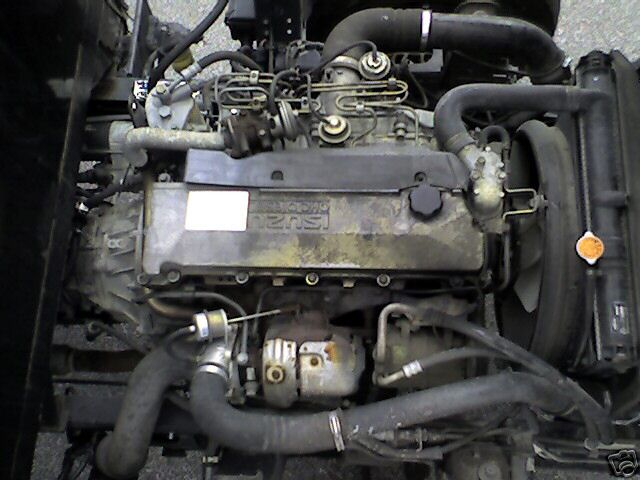

03-08-2008, 06:58 AM #2
Depends on the year and which engine you want.
4BD1- 3.9L, indirect injection, non-turbo, 2-valve head, 88hp@2800 181lb/ft@1600, redline 3080rpm.
[Image: NEW-ISUZU-4BD1-ENGINE-PROMO.jpg]
4BD1T- 3.9L, indirect injection, turbo, 2-valve head, 116hp@3000rpm, 232lb/ft@1800rpm, redline 3080rpm, Garrett TB2568 turbo.
[Image: 4isuzu.jpg]
4HE1T- 4.75L, direct injection, turbo, intercooled, 2-valve head, 167hp@2300rpm, 427lb/ft@1500rpm, redline 3450rpm Garrett TB28 turbo.
[attachment=0]<!-- ia0 -->4HE1T.jpg<!-- ia0 -->[/attachment]
4HK1-TC- 5.2L, direct injection, turbo, intercooled, 4-valve head, 205hp@2400rpm, 441lb/ft@1850rpm, VNT turbo (I don't know exactly what model)
