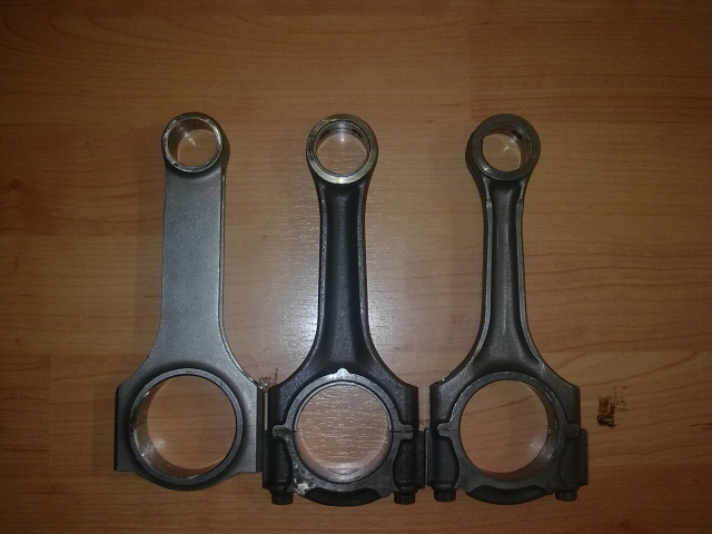

You would need custom rods to hold that much power. Such as the ones jeemu has.
You're looking at a $10,000+ project for the engine alone including the rebuild, IF you can get any of the Finns to sell you a set of their rods or find a shop that will make them for you.

Ps i have now original OM605 turbo rods.
