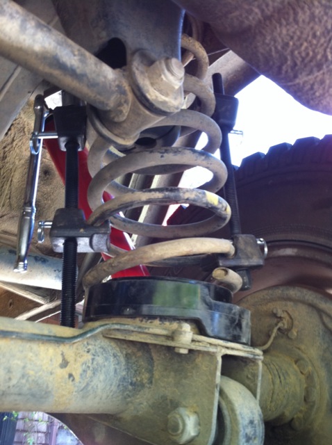

I just finished installing a 1.25" lift on my truck. it's not a w123 but it made me think that there might be similar products in the w123 spring sizes.
I'm heading to Hollister this weekend for an overland rally and will test it out.
Well I just bought a '88 jeep cherokee, I think a 617 would fit in that thing great!
(09-24-2010, 01:02 AM)Syncro_G I just finished installing a 1.25" lift on my truck. it's not a w123 but it made me think that there might be similar products in the w123 spring sizes.
(09-24-2010, 01:16 AM)Captain America Well I just bought a '88 jeep cherokee, I think a 617 would fit in that thing great!
