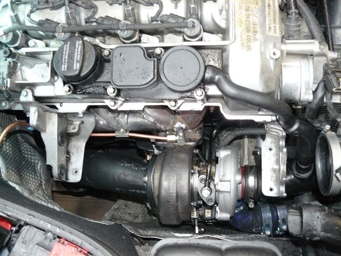

I love the 648 motor personally, even with just a chip it proves itself very strong and powerful. I can only imagine what kind of numbers this engine could put out with some serious investing. And I personally can vouch for the longevity of this motor.
I know one person that has pulled 227hp out of his C200 CDI using a GT3276V, large intercooler and AMG injectors. That means you should be able to pull at least 350hp, but those AMG injectors aren't anything resembling cheap.
