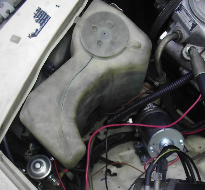

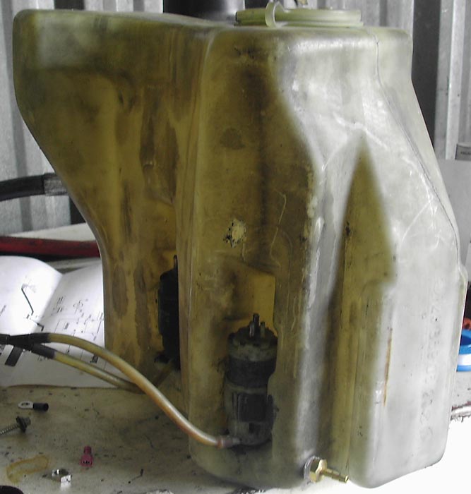

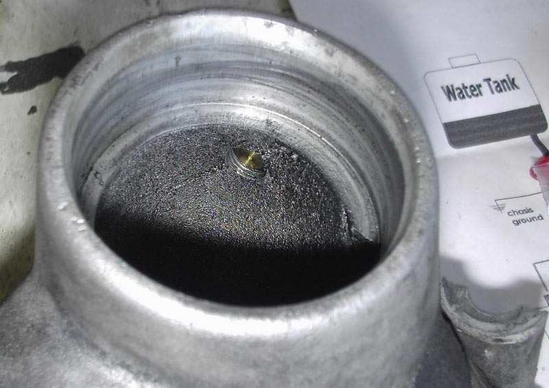

My old system had a flow rate of 300cc/min and gave a 2whp boost. Unfortunately it didn't reduce the EGTs at all.
I'm planning on installing a new 2-stage system this spring. It will have a 600cc/min total flow rate. First stage will be a 100cc nozzle at the intake inlet. Second stage will be 5x100cc nozzles, one at each intake port.
Variable flow rate would be nice but the cost far outweighs the benefits, at least in my case. A variable flow would cost me in the range of $500 while a 2-stage system would cost under $150 since I already have a pump.
[attachment=3]<!-- ia3 -->Water Inj tank.jpg<!-- ia3 -->[/attachment]
[attachment=2]<!-- ia2 -->Water Inj tank-motor.jpg<!-- ia2 -->[/attachment]
[attachment=0]<!-- ia0 -->Water Inj nozzle inside.jpg<!-- ia0 -->[/attachment]
[attachment=1]<!-- ia1 -->Water Inj solenoid.jpg<!-- ia1 -->[/attachment]
