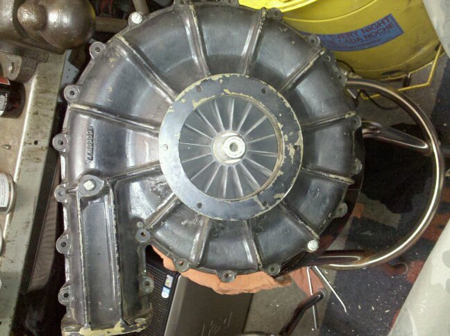

09-13-2010, 03:27 PM #25
$318 shipped. a couple of air museums have offered me between $4500-6500 for it because it's a restoration grade piece. still won't sell though. it's just too damned neat.
i forgot i had a pic on the computer here at work. it's on a standard 12" stool. pic is taken kind of at an angle, but you get the gist.

09-13-2010, 04:50 PM #27
sold my dodge v10, bb ford and bb caddy stuff, so ya. block is ribbed, studded and all that non-sense. working with a couple manufacturers for my options on a crank and rods. pistons are picked out. heads are gonna be iron, big ass cfm 2.08/1.60's from afr which will be o-ringed. i'm gonna adapt everything to a single plane open intake manifold. anything that needs to be milled/made/modified can be done at my bro-in laws machine shop for a couple bottles of crown and the cost of materials. all dry sump. i may send all my stuff out to decatur to be cryo'ed as well. waiting on a quote for it. shooting between 1000-1200hp at the crank as all the flow numbers are theoretical on the supercharger as they didn't map things out like they do now. transmission depends on what it gets stuffed into. still looking for a sub 3500lb carcass with a 34 cd or lower for a close to free as they come. whatever it is, it's getting cut up for a frame and to mount this silly thing. we're building it for a texas standing mile run. all in all, it's a long term project unless i come across someone to sponsor something this ridiculous.
oh, and i know it's somewhat on the wtf are you thinking side. so i am taking bets on how long it'll live since it's sole purpose is building lots of speed very quickly going (hopefully) straight in one direction and then (hopefully) stopping.

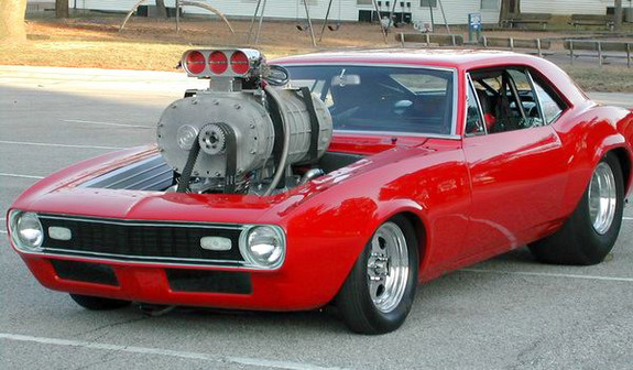

09-13-2010, 06:29 PM #30
That train S/C is quite a feat of engineering and I give him some credit....but it is kinda like these, sure they are big, but dayam, a little too big!
