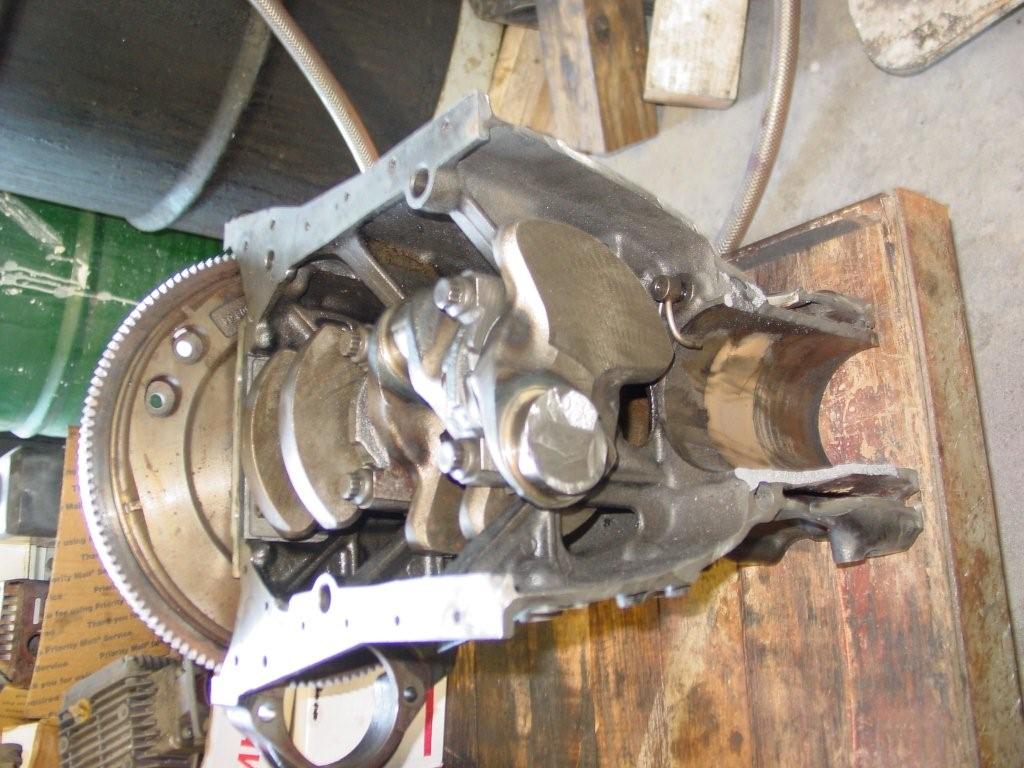

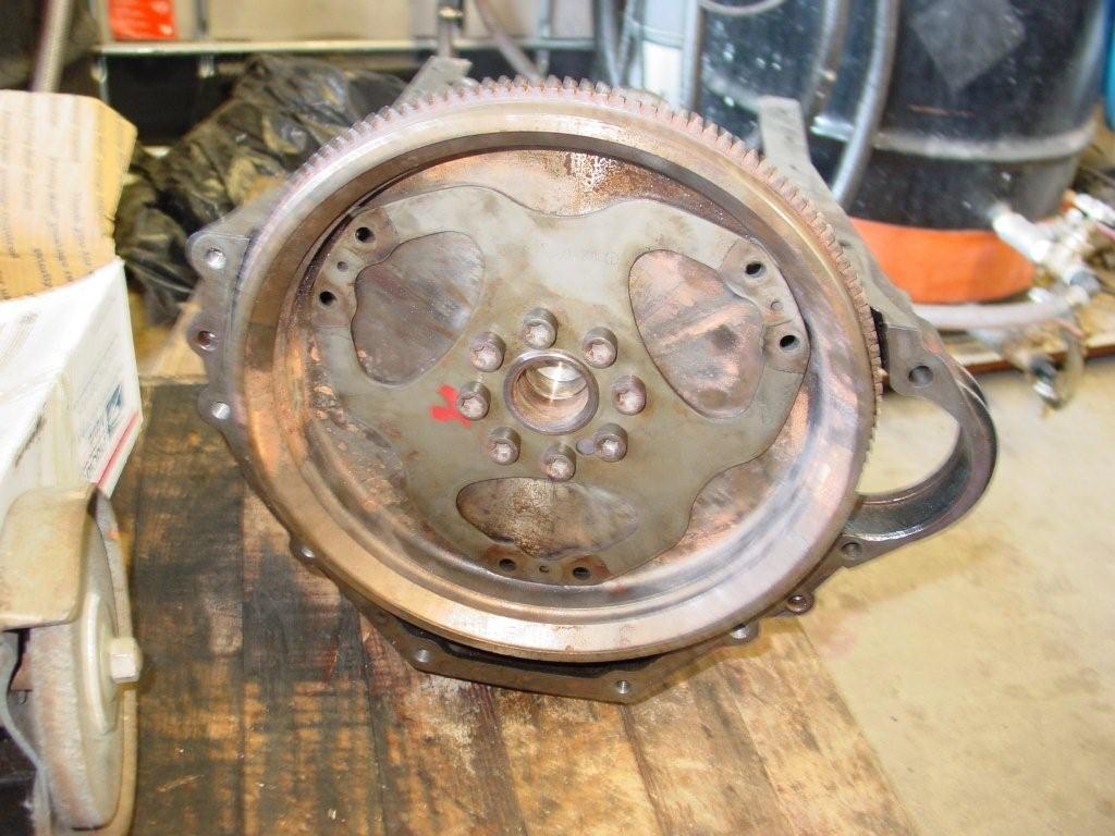

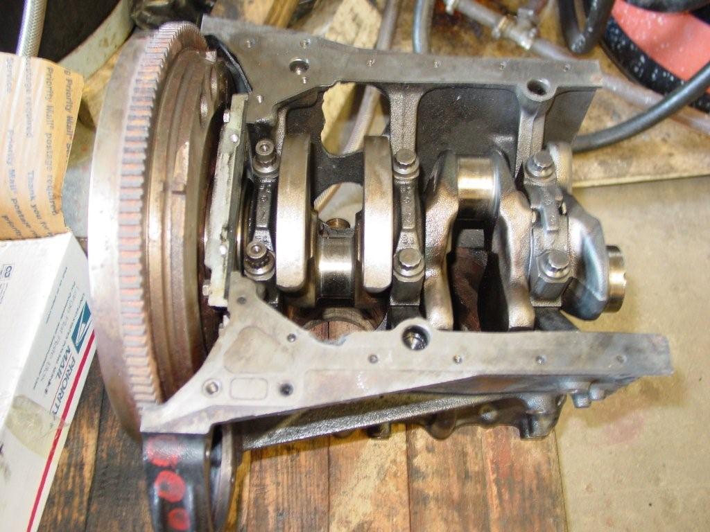

10-22-2010, 06:52 PM #9
Excellent pictures, jeemu.
Here are some pictures of a 1.25L OM606. Cool
I will be using this to take precise measurements in order to make a CAD file and then machine an adapter plate so I can run a GM 4L80E automatic behind my OM606. It weighs just over 100lbs - so shipping costs are greatly reduced.
muuris
OM605
318
10-23-2010, 01:48 PM #10
(10-22-2010, 06:52 PM)HoleshotHolset Here are some pictures of a 1.25L OM606. Cool
You monster! You could have used OM601 block for that purposal as well! I did, as those are almost free here. Now it's done it's job, but I was planning to cut it the same way you did to save storage space.
[Image: kytkintesti.jpg]
edit: oh, yours had some extra crankcase breathing holes Big Grin
This post was last modified: 10-23-2010, 01:50 PM by muuris.
muuris

10-29-2010, 11:14 PM #12
Matt,
Make an adapter plate for the 617 too! PLEASE! haha
Matt,
11-03-2010, 06:44 AM #13
(10-29-2010, 11:14 PM)Captain America Matt,
I plan on it...but it will be a while. Smile

11-04-2010, 12:24 AM #15
I'll have a CMM'd plot of the 61X pattern out for the masses once I'm sure it's good.

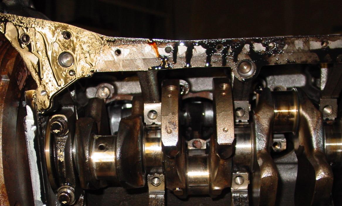

11-04-2010, 01:43 AM #16
could someone please censor the photos of the broken crank....
.... its really very disturbing knowing it was done intentionally.
totaldisaster
11-04-2010, 09:53 AM #17
300D50 I'll have a CMM'd plot of the 61X pattern out for the masses once I'm sure it's good.
Outstanding. I hope to get my 1.25L 606 on the mill pretty soon to get some measurements. What did you use for a CMM? Make sure you get the crankshaft thrust measurement too. Get everything...we'd rather be overwhelmed with data Smile
The GM transmission side of the adapter plate is pretty much done in CAD (Solidworks '08). That was easy since the GM stuff has been around forever and they're soooooo popular.
totaldisaster could someone please censor the photos of the broken crank....
I know - at first I thought it was a sin to do this as well.
The block got window'd - so that was a boat anchor. The crank was far from being in good shape...couple of the rod journals looked iffy.
You have to break a few eggs every once in a while...
