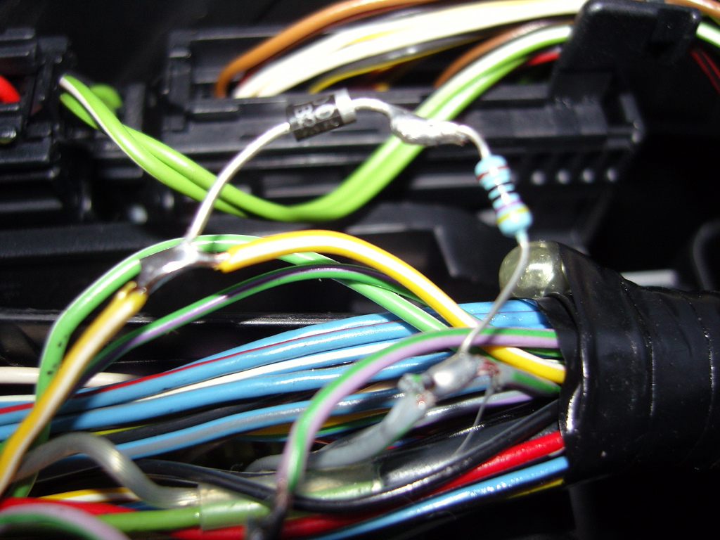

For those who haven't seen this already, I thought I'd post the final generation of the mod that's installed on my car currently:
Here's the schematic:
[Image: EGRDefeat.jpg]
The two components soldered together:
[Image: P9060087.jpg]
Covered in heat shrink tubing:
[Image: P9060088.jpg]
Soldered in place:
[Image: P9060094.jpg]
And some foil to protect the wiring when applying the final heat shrink tubing:
[Image: P9060095.jpg]
That's it!
[Image: P9060099.jpg]
Soldered in place:
That's it!

10-19-2010, 09:48 AM #3
This is a great post.
What is the difference between this and the old one? I still have the old one installed and its working fine.
Is there not a mistake on the drawing as it state Diode to Green and resistor to yellow but it seems the other way around on the picture? Again I know nutting about electronics.

10-19-2010, 09:35 PM #4
Nice catch, Olivier. It is true that the components are reversed from the drawing but in the case of the resistor, it doesn't matter the order. What's important is that the stripe on the diode points to the green/gray wire.
As far as a difference between this and the previous designs, I re-connected the EGR transducer and eliminated one of the resistors. The effect is exactly the same, I just simplified the circuit.

10-20-2010, 03:03 AM #5
Thank you E300TSC. Make it clearer for me. Smile
I might try this one as soon as I got my IP in order, still a wee poorly...

I can switch off EGR and MAF sensor (if present) in ECU software. Then you can remove EGR valve.

Afternoon Everyone,
In relation to this EGR mod., I presume you leave the vacuum and electrical connections connected??
Is there any danger of damaging the ECU by fitting this resistor/diode mod. across an input and an output of the engine ECU?
Regards, Wink

07-07-2013, 06:05 AM #22
Im just getting around to doing the EGR mod, is there any way to test this is actually working?

Did this on a customers car ( dear god i know a CUSTOMER!! ) The mod has worked flawlessly for over a year.
The motive for the mod was as follows. The car had a slight part throttle hesitation that was very hard to track down. Finally i disconnected the EGR valve and the issue was gone. The spring rate of the EGR valve had degraded after 300,000 + miles and allowed the valve to open to far under the same vacuum conditions allowing to much exhaust flow for the same given vacuum signal.

Hello I think I have confused myself,
I have a 1998 E300TD, 606.962, I blocked the vacuum actuator pipe to the egr and I'm happy to leave the egr solenoid in place as its small and does nothing.
So if the maf is the only thing controlling the egr is rather delete that because of the compressor inlet flow restriction of course, over on peach parts there is a tutorial involving a 22k resistor between yellow and blue wires to the maf connector but I tried that and it stopped my turbo spooling (held wastegate open I presume).
But the mod detailed in this thread is only for egr solenoid removal correct?

09-24-2013, 08:21 PM #25
Very good pictures, good circuit diagram.
However, I miss a verbal explanation of the mod, its rationale, the benefits, etc.
This appears as post number 1. So I asume it is.
Is there a verbal explanation already posted? If so please give me the link. This is a very nice mod and many would like to learn here.

10-11-2013, 10:54 AM #26
Ah,
This modification sends a signal from the egr (when the ecu actuates it) to the maf sensor so the output from the maf to the ecu is modified so the ecu thinks it's egr activation has given a corresponding reduction in flow through the map sensor (as the exhaust gas takes up air space) to verify the egr has operated.
Therefore map sensor can be unplugged.
**just in case anyone (like me) was unsure**
Aha!
Awesome, implementing this tomorrow..

In don't think you can unplug the MAF. That will throw a code for other reasons. What you can do is stop the EGR from operating, either by blocking the port, or putting a BB into the vacuum line, or both.

I don't think so. Go ahead and try it, but make sure your fix is reversible.

09-25-2014, 05:32 AM #30
I have the same engine in my W210 (OM606.962) and I would like to get rid of my EGR valve too, just because I think that its not good for the engine.
Who has done it - could please answer some questions, like:
Is the wiring diagram in this topic the correct one (1st post)?
Have you disconnected the vacuum hose from the solenoid to EGR or have you completely disconnected the solenoid valve?

DIsconect the vacuum hose first, if nothing happens (limp home mode etc).
Then just leave it like that, no need to do anything else.
It seems to me that only the american market cars go into fault if you disable EGR via vacuum hose disconnection.

09-25-2014, 11:49 AM #32
(09-25-2014, 06:37 AM)Hario DIsconect the vacuum hose first, if nothing happens (limp home mode etc).
All OM606 turbos had monitored EGR systems. The USA system looked for a change in intake flow. The Euro system monitored physical EGR valve lift. If you just remove the hose it will soon drop into limp more.
First figure out which EGR monitoring system you have. There are different fixes for them.

09-25-2014, 02:26 PM #33
(09-25-2014, 11:49 AM)AlanMcR All OM606 turbos had monitored EGR systems. The USA system looked for a change in intake flow. The Euro system monitored physical EGR valve lift. If you just remove the hose it will soon drop into limp more.
What do you mean by two monitoring systems?
I can only remember that the EGR circuit in my car only has the EGR solenoid valve which electrically opens the vacuum when the ECU tells it.
There is no monitoring device or a sensor inside inlet manifold and even in the EGR valve housing.
It should be an European car, produced in 1997 and transported to estonia from germany.

09-25-2014, 05:39 PM #34
(09-25-2014, 02:26 PM)canyondrift
Is there a wire going directly to the EGR? That is the lift sensor. If not, is there a wire going to a sensor at the air filter box? That is the MAF sensor.

09-26-2014, 02:31 AM #35
My euro model E300TD has no physical EGR lift sensor, as per all euro models, it has a MAF sensor to monitor airflow change due to EGR operation.
However as mentioned I removed the vacuum hose and it didn't go into limp after several months of hard driving, I then installed the above MAF wiring mod just in case it went into limp when I was far from home.
What I'm saying is mine worked fine for some reason, 1998 UK model.

09-26-2014, 09:16 PM #36
(09-26-2014, 02:31 AM)Hario ...
Has any ECU tuning been performed?

09-30-2014, 07:28 AM #37
Completely factory, though I didn't have STAR so I couldn't check if a code had been raised, there was certainly no loos of performance / limp etc. Who knows.. Thats why I'm saying try it, ign/ off/on resets limp so no harm done.

09-30-2014, 09:17 AM #38
(09-30-2014, 07:28 AM)Hario Completely factory, though I didn't have STAR so I couldn't check if a code had been raised, there was certainly no loss of performance / limp etc. Who knows.. Thats why I'm saying try it, ign/ off/on resets limp so no harm done.
Interesting. My experience is the opposite. I've got both a USA 1998 E300 Turbo and a Euro 1996 G300 Turbo. Both will go into limp if any part of the EGR system fails to respond. On the G300 I've built a circuit that electrically simulates the function of the EGR lift sensor. But it is more complex than what is claimed to work on the USA / MAF based system.

(10-18-2010, 07:32 PM)E300TSC For those who haven't seen this already, I thought I'd post the final generation of the mod that's installed on my car currently:
Soldered in place:
That's it!
Can you please explain why this mod is better than EGR delete? Some people say that EGR is even good for performance! What does yr experience says?
Oldbeaver
oldbeaver
12-18-2014, 07:53 PM #42
Oldbeaver
Tito
12-19-2014, 02:17 AM #43
EGR good for performance? who told you that? It's to reduce Nox at cruising speed. Redirecting hot non oxygen gasses to the intake is never a good idea Big Grin It has nothing to do with performance. At full load the EGR is switched off.
Tito

Taking up and old thread - will it be needed to block the vacum to the egr, and also the exhaust when doing this mod? And will blocking vacuum and exhaust do the same thing?
Joystick
03-11-2015, 01:35 PM #44

I am dealing with a problem that is having poor braking power sometimes in my W210, so assumption would be the brake booster is not boosting, which is vacuum operated.
I have done the the 470Ω + 1N4004 diode mod and I have also deleted MAF by soldering 22kΩ resistor between blue and yellow MAF wires as shown in a Peachparts forum post. This forum doesn't seem to allow URLs in posts so I can't link the MAF delete instructions here.
I have also blocked the EGR control valve vacuum lines.
The question is is that do the vacuum lines need to be blocked or is it completely unnecessary to block them if the resistor + diode mod is in place?
I am trying to troubleshoot the brake booster issue I am having by connecting every vacuum line as they were originally, but would this cause the EGR to be back in operation? Or even worse, EGR locked to open position as I have the ECU fooling resistor/diode mods in place?
oho
03-18-2024, 12:06 PM #49
