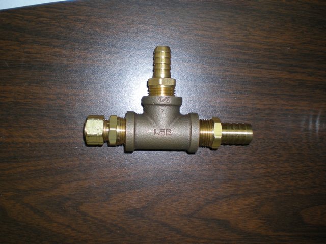

10-20-2010, 09:00 PM #4
making something like that out of copper pipe looks like an especially shitty short term solution, at least in that how to article. I mean, they want you to slip some rubber over the aluminum line, then hose clamp rubber hose over that to create a seal for the coolant not to pass? Are they serious? They actually want you to trust your engine cooling system integrity to a seal like that for the long term? those directions are written by a hack, thats a sloppy solution.
Same deal on sealing the rubber hose by just slipping it over the smooth cut off copper pipe.
Why don't you go with a compression fitting (also come in DOT certified) to get the aluminum tubing out of the cooling channel, and a threaded T with two hose barbs. that way you have no questionable connections like that, and much better connections all around.
All the VO companies using Hose in Hose setups have been doing it that way for a while too, there a lots of example pictures floating around. Heres a pic of the same connection I did on my escort diesel a few years back.
Note- I ended up using a 3/4 coolant hose, the barb in the pic is 5/8, and I had to drill out the pipe seating of the compressing fitting so the tubing would fit through, but even though its bulky, ugly and crude, it worked great and it was extremely heavy duty. Plus, it was all brass, and had less of the galvanic reaction problem that copper would have in a predominately aluminum cooling system.
EDIT- I just read through the comments on that article, and the author's reasoning about flow, and compression fitting not coming off. I had no problems with flow, and I did not WANT my compression fitting to come off. But that is a factor, once you tighten the compression fitting down, you do crimp it permanently for the most part around the tubing depending on the tubing thickness you use.

(10-20-2010, 09:00 PM)dropnosky Why don't you go with a compression fitting (also come in DOT certified) to get the aluminum tubing out of the cooling channel, and a threaded T with two hose barbs. that way you have no questionable connections like that, and much better connections all around.
Cool! i dident think of using that heafty stuff! Do you have any more pics of your set up?

10-23-2010, 08:55 AM #13
cannonball, there are lots of online sources for aluminum piping. type in aluminum fuel lines on google, and you can get some decent looking stuff. Also, you can buy it very specifically at Mcmaster-Carr and specify ID and OD, but its pricey. I think some of the VO-kit makers also sell hose in hose kits, you should check out their sites.
Unfortunately, I don't have any more pics of that setup on that escort, but it was pretty cool. It was an 86 2.0 diesel 5-speed escort, at 50 hp. Big Grin It got approximately the same fuel economy as a newer jetta diesel, around 45 mpg.
I threw a 30 gallon tank in the back, filling the whole trunk, and the sucker had a 1300 mile range. it was DANGEROUSLY slow though, ended up selling it to some shoeless hippies who ended up making the car look like shit in the way that only hippies can.
I think underneath, I bundled my coolant hose with some foam pipe insulation which worked pretty well removing wind chill. Oliver is right, some people end up running the lines inside the cabin, but this might be illegal technically from a DOT standpoint I believe. Better do some research on that first. Oliver, whats the rule in Scotland?
