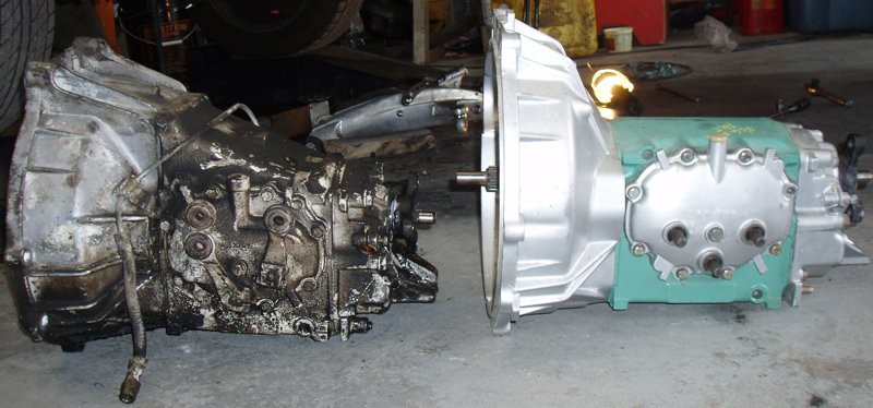

MTL is not good for MB's manuals, it will make shifting worse if it has any wear.
It needs to be ATF based, D4 or Mobil1.

11-04-2010, 06:24 AM #5
(11-03-2010, 05:34 PM)jeemu Redline MTL is suitable on those trannys and gears go better in.
Possibly in newly rebuilt ones. If its worn to where it ever grinds going into a gear (without being forced) MTL will make it grind more often.
MTL made my old slope-back tranny shift a lot worse compared to dino ATF. The rebuilt flat-back tranny has had Mobil1 ATF from day 1 and it shifts perfect.
