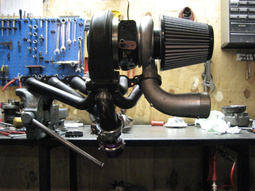

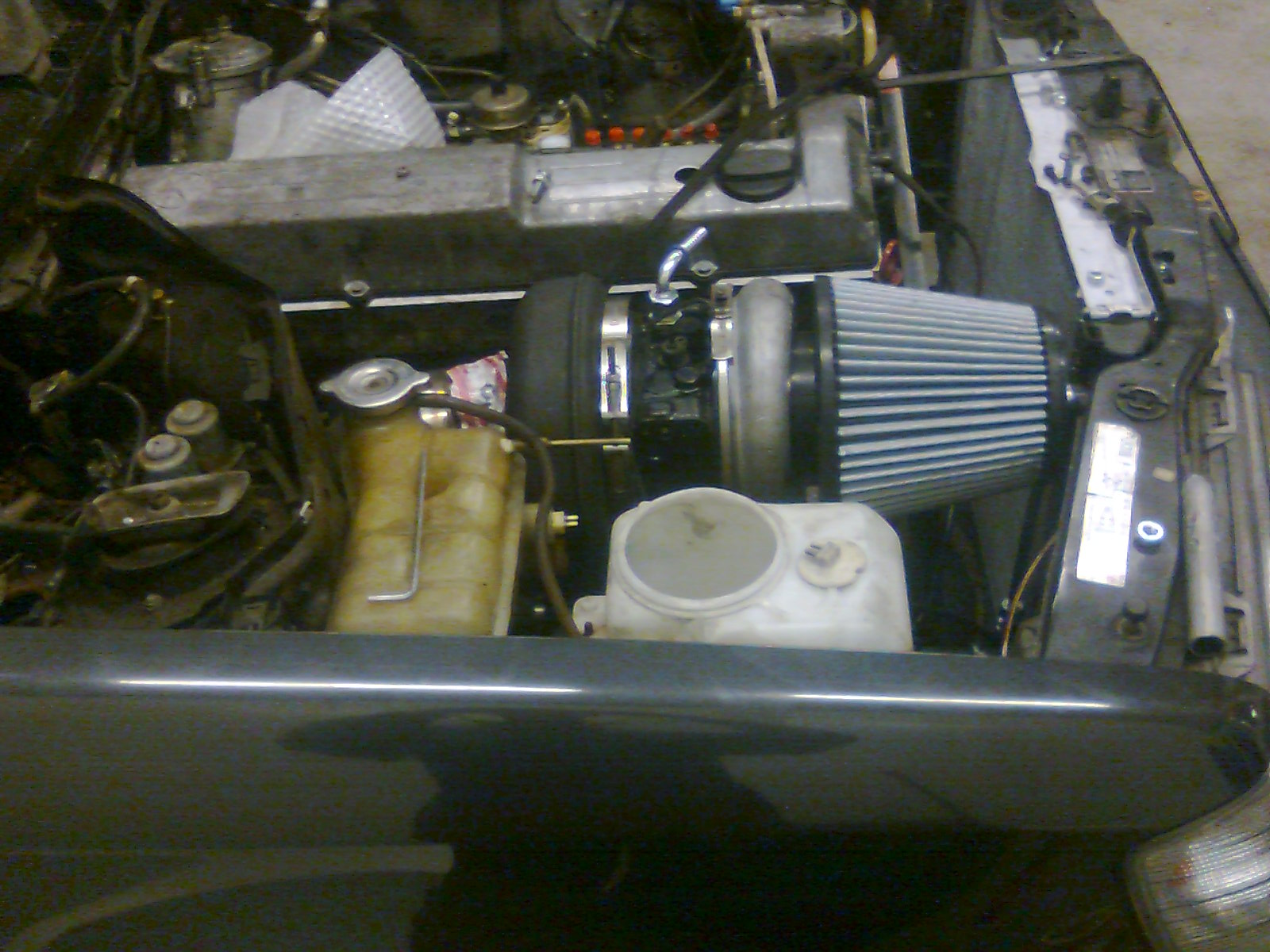

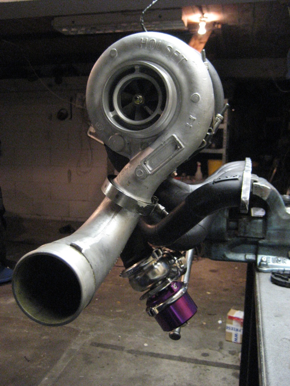

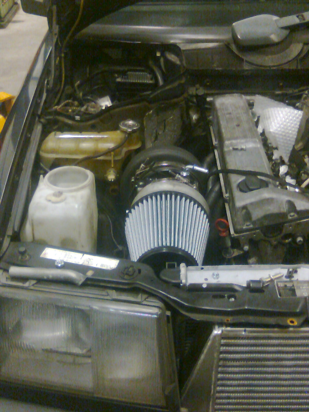

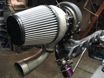

12-13-2010, 05:02 PM #9
Hello,
The turbo will not bolt on the old manifold, see the pictures.
Had it on the car saturday and it fits okay, got some more pictures later. The turbo has an 60mm titanium impeller.
Greets,
Mark
