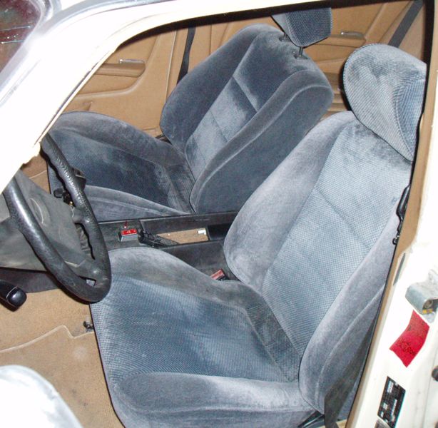

Pulled from a MR2 Spyder, welded to MB factory seat mount rails. Very supportive, comfortable, and look much better than the worn out factory units.
They also weigh significantly less. The factory passenger seat weighed 60lbs, driver seat weighed almost 80! The Spyders only weigh 40 at most. I get another half foot of head room now, much nicer than my head bouncing off ceiling on bumpy roads.
Did you have lead-lined seats? They are nowhere near that heavy (About half of what you said).
There weren't any MR2s in the yards I checked at for seats but those do look nice. I'm loving my Mitsubishi Galant seats.
Not everyone feels the same about having well designed Japanese seats in a Mercedes....

I don't have a problem with japanese parts in a german car. I don't know why the stockers were so heavy, the last owner tried to restuff them on top of the blown-out padding. On the other hand, my brother has recaros (came with truck) in his '88 Toyota pickup. The seats collapsed and the fabric's worn through, and if you get in or out wrong, the side bolsters will crush your tailbone. They may have been nice to begin with, but they are horrible now.

Recaro is nothing fancy these days. You can't fly anywhere without sitting in one. My seats are already replaced once with OEM. I honestly couldnt even tell you what the old ones looked like. Recaro is the way to go IMO. If I wait a bit and beat the BMW guys there, something like this at pull a part is relatively cheap :
Hi guys, just joined. My 1978 240D seats are torture chambers, especially the lower back area. I'm willing to put in anything that's better, preferably something that needs little mods. My seat tracks and adjustment handles are toast anyway. So, in discussion and pics people have stated examples, but not specific make/model/year(s). Any suggestions that would stave off disk replacement?
My seats came from a 1992 Mitsubishi Galant.

I had a couple of MKI MR2's and those seats are LIGHT. Recaros from a MKII GLI were easily twice as heavy, and I'd hate to use them for a daily driver, methinks. (I'm 6'2" tall and wide at the shoulders, mind you.) They're also made out of that weird indestructible kind of fabric also associated with cloth Volvo 240 interiors. The MR2 seat is a very Japanese kind of semi-ideal compromise between day to day usefulness and performance (in this case, lateral support).
However I will say that the stock MB seats (if in good condition) are probably superior for long distance highway cruising, and for cranking the seat back and catching a roadside snooze...superb.
FYI Civics, Sentras, and many other Japanese cars have similar seats, and word to the wise: when Mazda does something right, it tends to do it VERY right. I doubt very much any MB head would complain about a MKIII RX7's front seats in a 123.

Leather sucks in the 120* california desert. The MR2 mesh on cloth is super breathable which is my chief reason for going with these.
