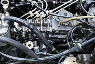

12-31-2010, 08:16 PM #5
the pump is on the IP. Mine is black but I think some are red too. you just push it in.
here is a pic though it's kinda bad to see the pump
http://www.superturbodiesel.com/std/atta...hp?aid=677
it should be just to the right of that inline filter
I think "drdan" is using one in one of these videos
http://www.youtube.com/watch?v=hfQUrz_W6eo

01-01-2011, 01:01 AM #6
There are a few different styles of primer pump all located in the same area!
If it's the knob style It's a big white knob on the LH side of the pump by the fuel lines it unscrews the knob and you pump it up and down and screw it back down when done!
If it's the black button style it located in the same spot and looks like the one in the video just push it down a few times!
as far as the voltage the glow plugs use a lot of power! sounds normal to me!
