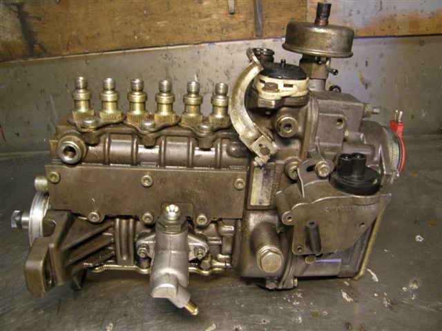

I just got a mercedes w124 with a 300td engine(603.960) that I plan to tune for more horsepower. Can someone give me some info about what the numbers on my pump means?
PES 6M55C320RS180
369 08 21311
0 400 076 959
D603 070 44 01ER0032
How much fuel(horsepower) can this pump deliver?
Here are some photos of the pump[/size][/font]

As with everything, how much money do you have? Myna in Finlad has 7mm element for this, with proper fuel, new turbo and decent engine you should get around 400HP.

PES 6M55C320RS180. That means your pump has 5.5mm plungers. The most you can get out of it with that size is 175hp at the crank (around 140hp at the wheels with an automatic transmission).
6mm plungers are used on the turbo OM606 pump but its computer controlled so you would have to get your pump rebuilt with them.
Myna is always the best option since they specialize in performance modification/tuning of MB's pumps. Unfortunately that is around $2500 plus shipping to Finland because of the poor $:€ value. Nobody in the the USA does anything close to what they do.
The 603 should be good for around 400hp with unmodified internals and reliable with 250-300hp.
