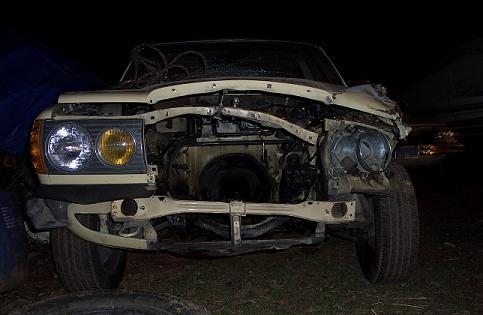

I have the entire 300TD. It is smashed (front drivers side) but all mechanical parts are good minus some driver’s side suspension. It is still very fun to drive in the woods. Springs are no problem but how does the sway bar remove? I wouldn’t mind having the sway bar out of my way. It is making it hard to get the top two transmission bolts.

All is removed!! The radiator, engine, transmission, drive shafts, and rear-end with axles. I will remove the front springs and sway bar another day. The rear sway bar looks wimpy like the one on my 240D. Is it the same? I will now wait for my new engine mounts to arrive and some warm weather. I'm looking forward to going back to work. I need a break from hard weekend activity.Smile
