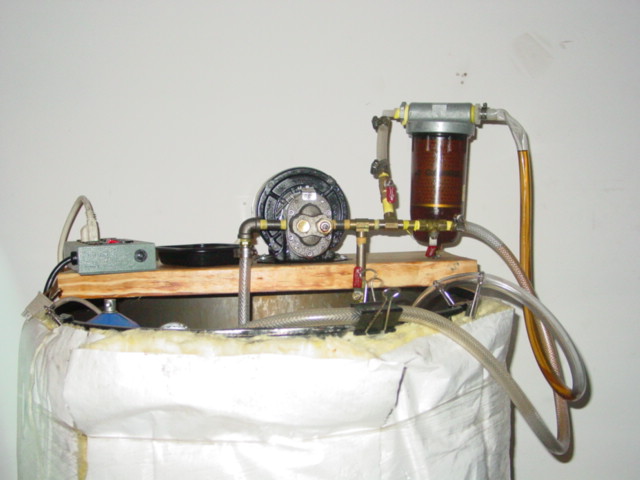

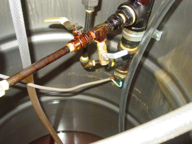

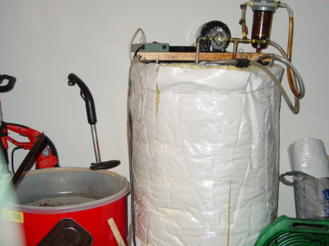

04-24-2011, 06:31 PM #17
There are a few things you have to pay attention to when using WVO as a fuel.
First, the WVO has to be clean, (but all fuel has to be clean) there are lots of info about how to clean it on the net.
Second and just as important is its viscosity. WVO is normally 10 times as viscous as diesel and that WILL create problems if you don't lower the viscosity. You can mix it with paraffin or gasoline, but the best way to do it is by heating it up to at least 160 degrees Fahrenheit. So why is high viscosity so bad? it put extra stress on the fuel system and the WVO will not atomize properly in the combustion chamber, resulting in contaminated engine oil and carbon build up.
But these problems can be overcome making WVO a great fuelSmile

05-30-2011, 09:21 PM #31
Here are some pic's of my set-up. Nothing very fancy. I have 3 drums (free), one for straining, one for the centrifuge, and one for storage. My WVO comes out very clean, no water, sub-micron purified. I run it for hours, 20-30 gallons, at about 1 gallon per minute, so after 8 hours, that would be 16 passes. The heater cost less than $25.00, that is for heating element, pipe, and valves. Tried sending this as a PM to CJCosta, but I couldn't figure out how to upload pictures.
