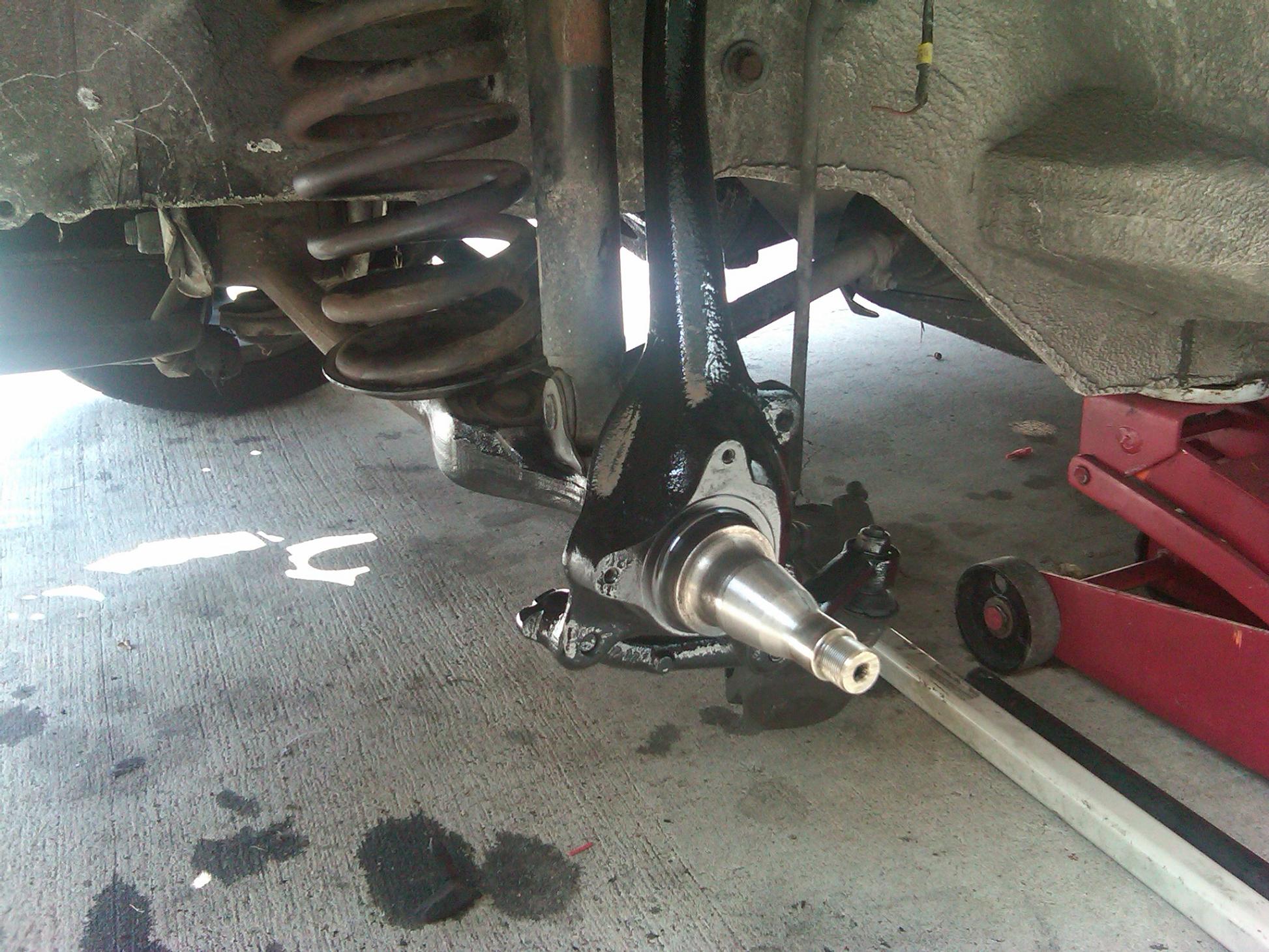

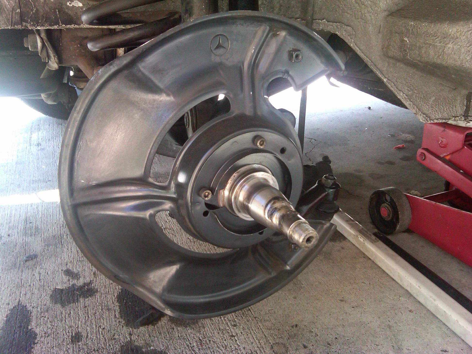

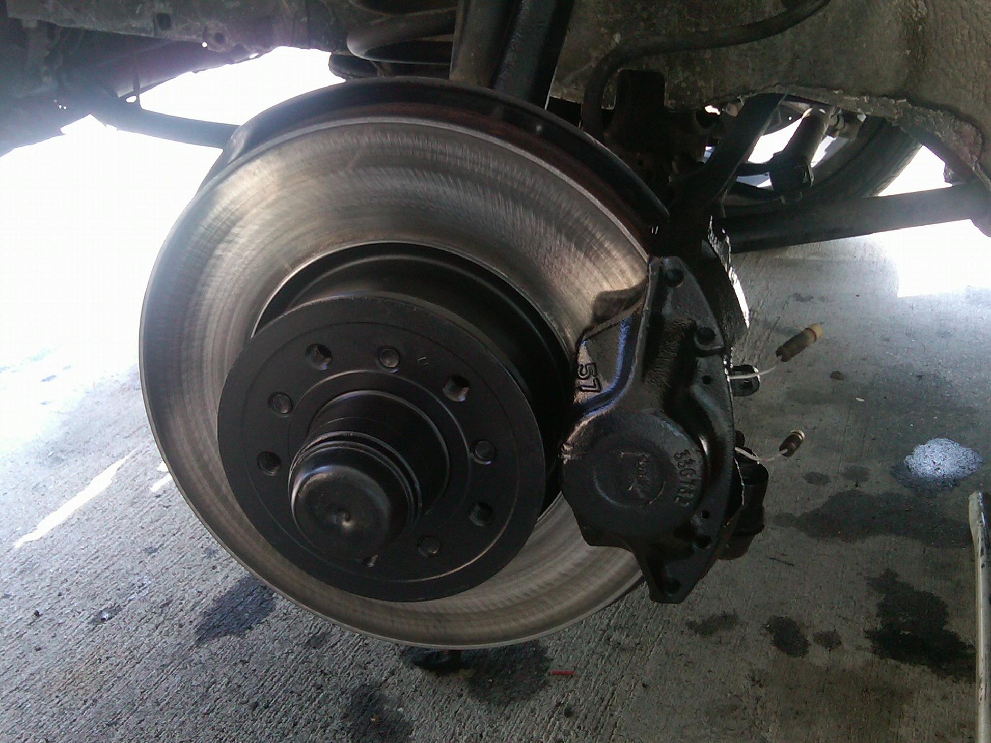

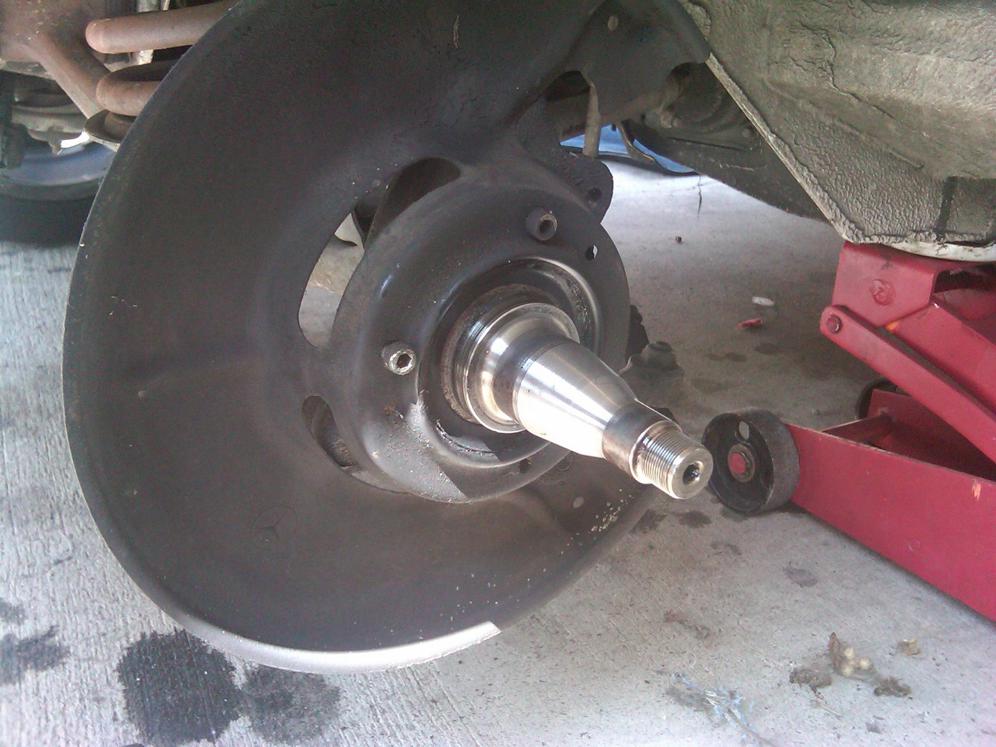

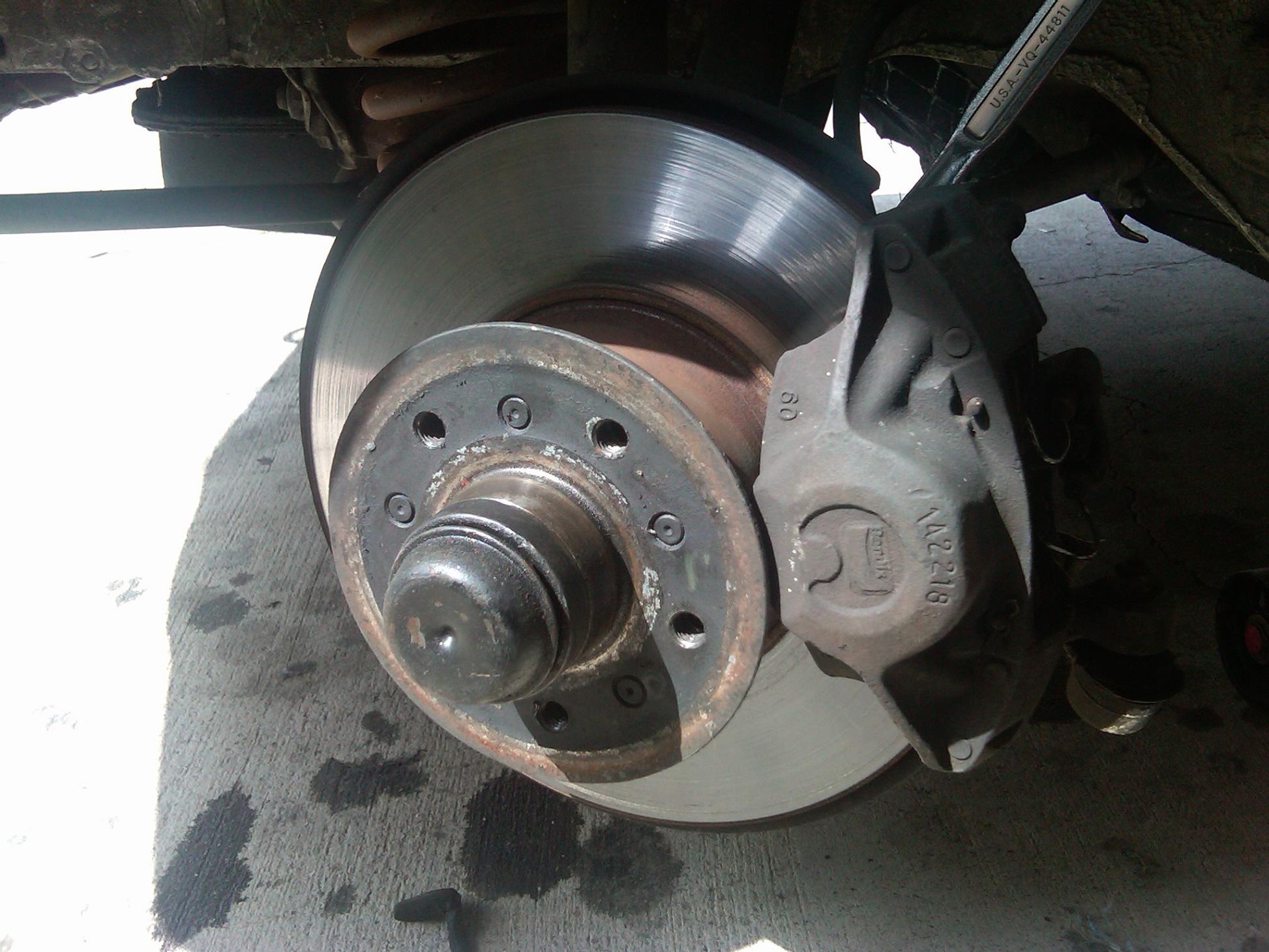

Due to the fact that there is no dedicated thread to the w126 2nd gen brake conversion on a 123; i figured i'd post one with pics.
Needed for convert:
-Rotors
-Calipers
-Backing plates
-15" or larger wheels
Stock solid 280mm w123
Unbolt caliper and remove rotor
Remove backing plate. perfect time for clean and paint.
Now time to reassemble. Remember your locktite. If it had it, put it back.
If you went the pick-a-part route, you might need/want to do some cleaning and painting. I did, and used caliper paint. It required a bake hardening process. When pulling the calipers at the yard i cut the hoses at the caliper fitting, installed a screw in the open hose to plug off for cleaning/painting. Otherwise a set of pipe plugs would be required.
Once the rotor was installed, (cleaned, painted, wheel bearings cleaned and repacked) I installed caliper and mounted. To limit the amount of spillage and lose of brake fluid, i left the old caliper hose attatched until the new caliper was installed. At this point the line must be removed to unthread from old caliper and rethread into new caliper. They use the same part pad, transfer or install new pads. Note:dont forget to get the pad springs and pins.
After 100 bucks, a trip to the yard and a saturday fooling around making the conversion, Totally worth it! More responsive, aggressive feel.
83' 300SD tuning begins soon.
