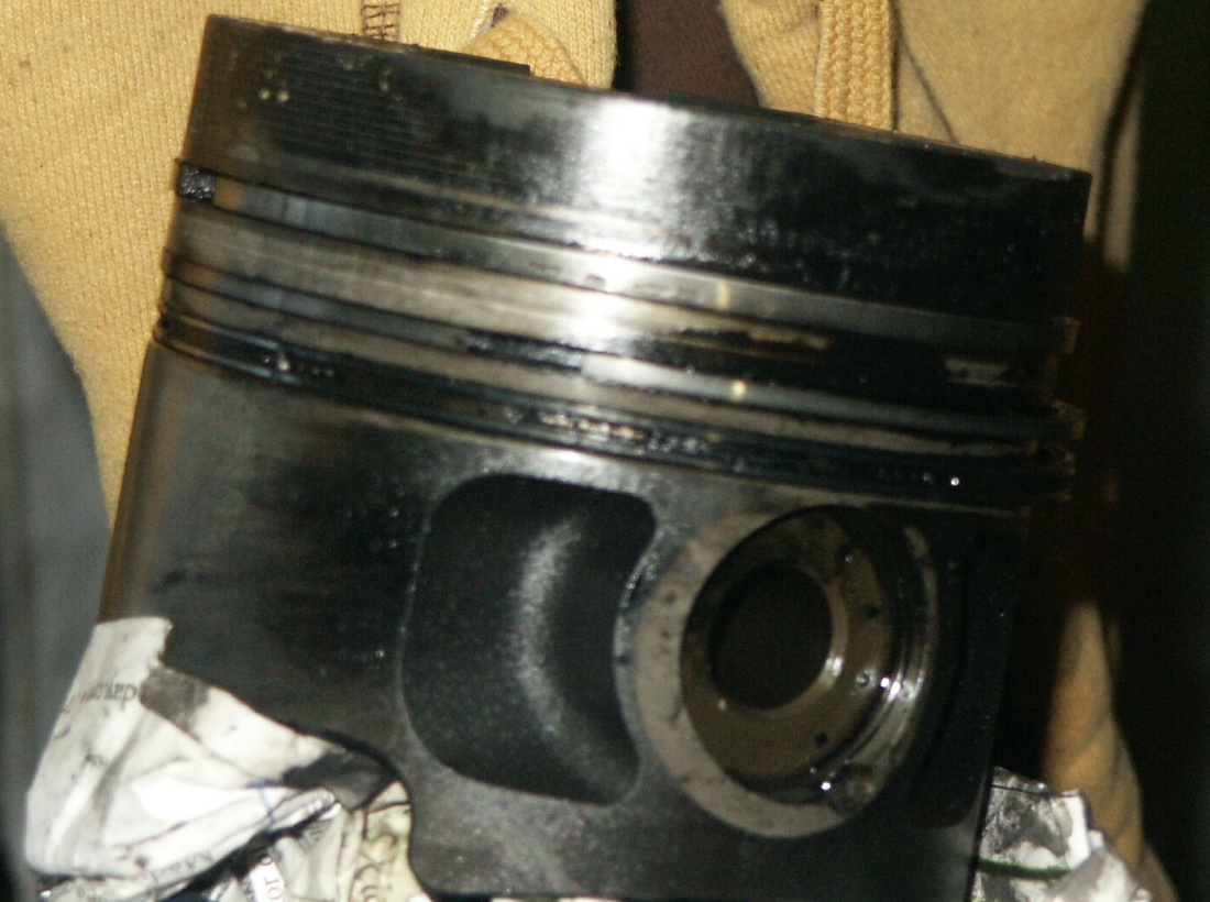

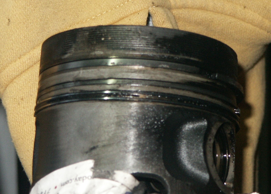

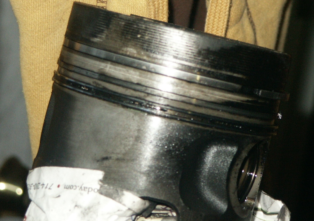

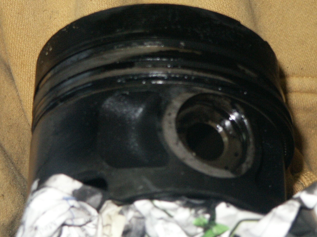

I have opened at least 10 of these engines; turbo and NA.
I see the same thing over and over on the turbo models. The upper rings almost always have chipped contact surfaces that originate from the bottom of the ring.
If its not all the way around the circumference of the ring, its in one localized spot.
My theory:
First owner breaks in car and drives a particular way. Sells by 150k miles to second owner. Car is still in good condition and 2nd owner treats as such. 15 years after original purchase, car is a bit beaten and is sold to someone who drives much more 'spirited' than the first 2. The engine has 200k miles on it.
The upper cylinder taper has been created and there is a pretty decent ridge there now. Any heavy driving causes the pistons to heat up and expand. Thus, the upper ring is smashed against the ridge and the ring land on the piston.
With nowhere to go, it chips.

05-10-2011, 12:24 AM #5
(05-09-2011, 06:09 PM)DeliveryValve Pictures please!
What? You don't believe me?
I may be wrong, it could just be fatigue as I have found the chips also on the second rings. But they are much more prevalent on the top ring
I suppose its possible as the ring wears, on the bottom primarily, the outer layer flakes off due to the angle of 'twist' by the ring.
The rings get sloppy and find more freedom in between the lands then start making contact on different locations than where they have 'set'.
The ridge theory is debatable. But this failure is not.
